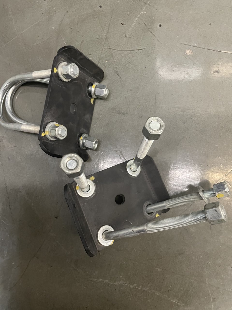

    Selling a ubolt flip kit I only used for 2 months. Very beefy design
    And I had the top plates powder coated. This should be the relentless fab brand. I switch them out because I got a set designed
    To go with my new bump stops. Willing to ship at buyers expense.
    $60

    Is it okay to re-use U-bolts after they've been installed once?

    Some on here have said they stretch upon install and thus should not be re-used.
    But I don't know. That's why I'm asking.

    The NUTS (High Hex SAE J995) are made from a higher carbon through hardened steel then work hardened when cold formed, you can re-use them as long as the threads are in good, working condition. I would check them with a thread chaser for any malformations. Also check for any surface cracking in the "Corners" and edges to check any set in of embrittlement
    The U-BOLTs (MSS-SP-58, Type 24) are created from a low carbon non hardened steel, that are barely work hardened just bent and threaded and once stretched do not return to their (Properly) original shape, and lose substantial elongation tension some are even annealed to make them easier to stretch which you do not use again once un-installed U-Bolt or not
    The U-BOLTs will stretch, they are designed to work like a ferrous rubber bands to make it easy
    DO NOT re-use your U-BOLTs after removing them, they have reached max yield/elongation after install
    This stretch is very, very little and you would not even notice it... but it does stretch like a rubber band would
    Remember... always use a "harder" nuts than the fastener you are using in conjunction with
    Example: Grade 8 nut with Grade 5 bolts, or Grade 5 nuts with Grade 2 bolts etc.
    Suggesting you re-use U-Bolts is moronic, dangerous and I cannot believe you would suggest something without doing proper research or asking an expert because you clearly are not. You are the one basing your incorrect statements off of nothing but conjecture your assumptions are absurd
    "Beefy" has nothing to do with it... I big blob of "Soft" metal is not beefy... you are focusing on mass and not grain structure
    Go ahead, re-use them and end up like this guy... or don't be cheap and get new U-Bolts and do it the right way
    Go to a mechanic, a good one... they wont re-use them you shouldn't either don't be cheap/lazy. Take care yall
