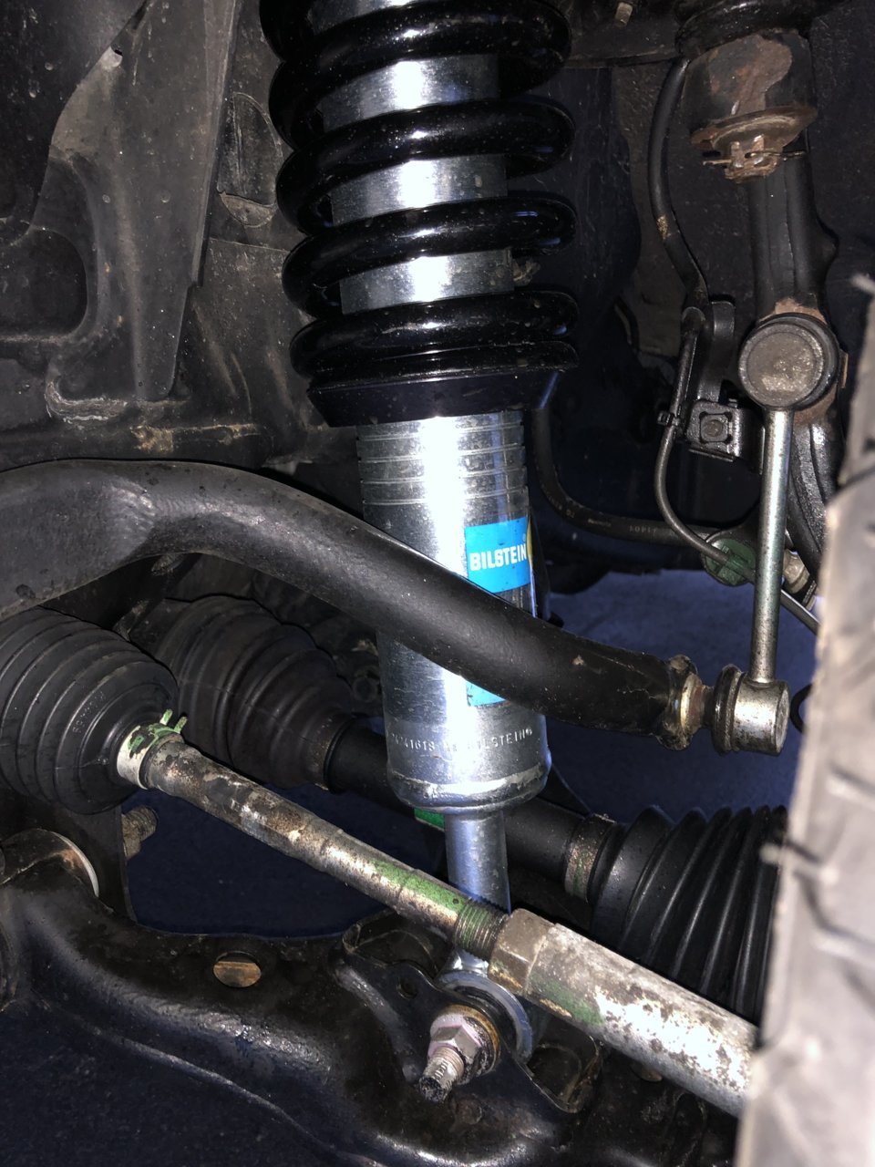

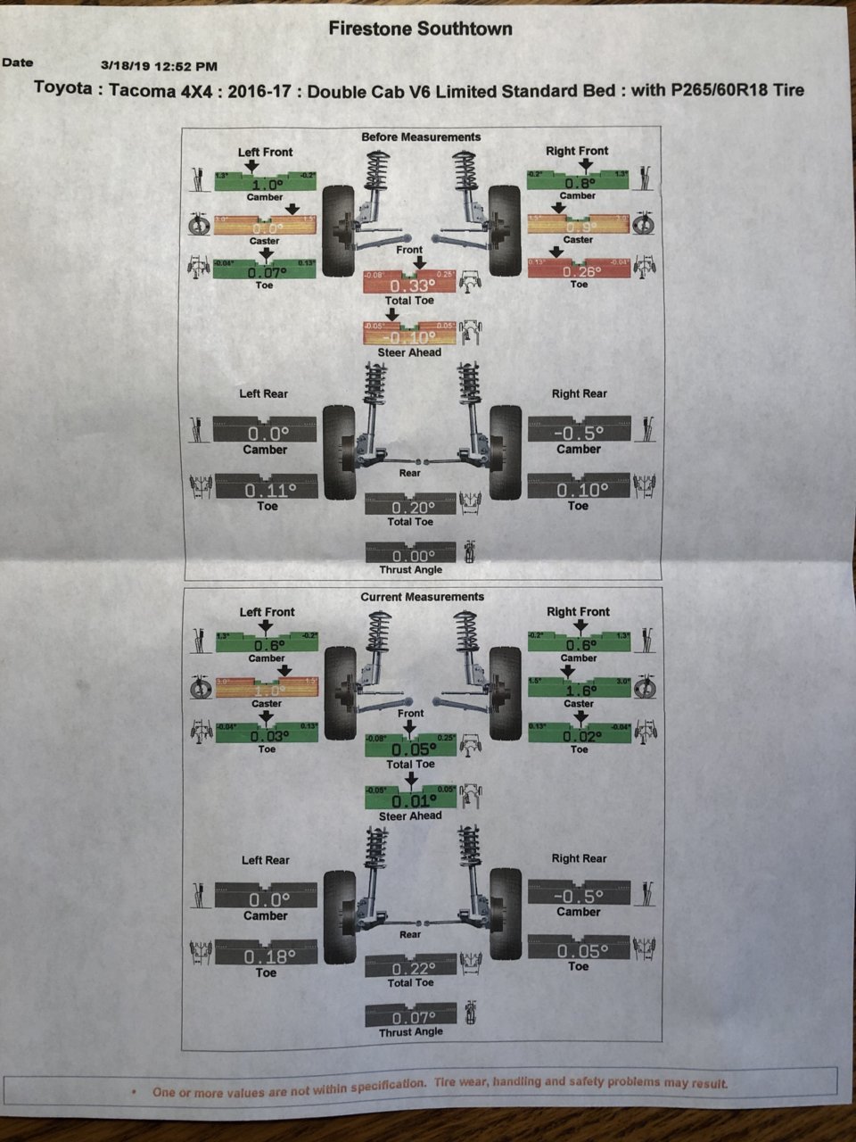

    image.jpg I just installed 2nd gen 6112/5160 on 5th notch over the weekend. I was expecting to get 2.5” up front but ended up with about 3.75”. I was thinking I’d be borderline for needing UCAs but figured I would definitely need them after the amount of lift I got. Well I took it to Firestone this morning to get aligned and seemed to drive fine on the way there except for slight rotational vibration which I’m guessing is the needle bearing. So they said they were able to get everything into spec and didn’t think I needed UCAs replaced. They also said if anything they would replace the LCAs because that’s where all the eccentrics are and is the easiest way. Now I’m completely confused because I’ve never heard of that at least here on the forum. I don’t know if I should take it somewhere else or if I should trust these guys or what. Truck is driving perfect right now besides the slight vibe which I’m planning on the ecgs bushing. Any advice is greatly appreciated.
    Also not sure if it matters but my tires are 275/65/18 even though the sheet says 265/60/18

    Something is installed wrong show some pics of the shock tower.

    Hey man, people with more knowledge than me will inevitably chime in... but here are my observations.
    3.75” is way too much lift - you’ll ruin your CV’s.
    The ECGS bushing is a very easy and inexpensive mod. I recommend it, sounds like you’re already on this.
    1.0 caster is way too low - I’d take it somewhere else AND throw the UCAs on. You should aim for 3-3.5* caster.

    also this. you shouldn’t get that much lift out of 6112’s if installed correctly.

    I'm thinking the perch is upside down.

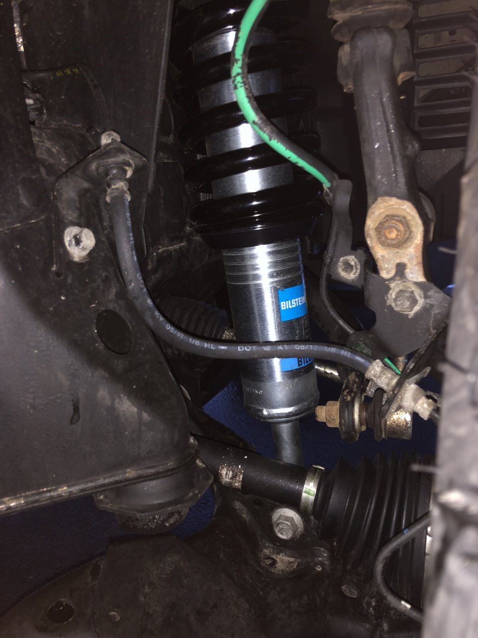

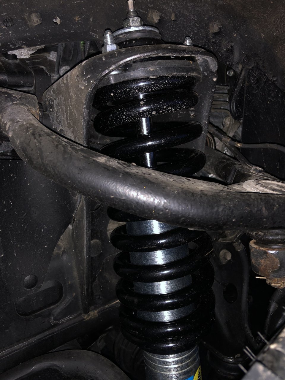

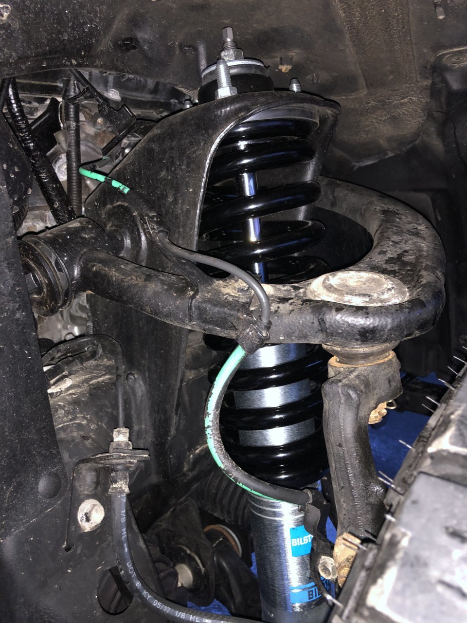

  7. Mar 18, 2019 at 4:26 PM
    RocRan26
    RocRan26 [OP] Well-Known Member
    Apr 6, 2018
    #249638
    117
    Randy
    Rochester NY
    2017 Black Tacoma Limited DCSB AT
    First two pics are passenger side. Second two are driver side with 1/4” spacer. 6112s came assembled from headstrong.

    Can you give us a measurement from the center of your wheel hub to bottom of the fender?
    I was thinking the same as Rick, but the perch doesn’t look upside down now that I can see what you posted.

    It also doesn’t look like 3.75” of lift, by looking at control arm and cv angles. But obviously pictures can be deceiving.
