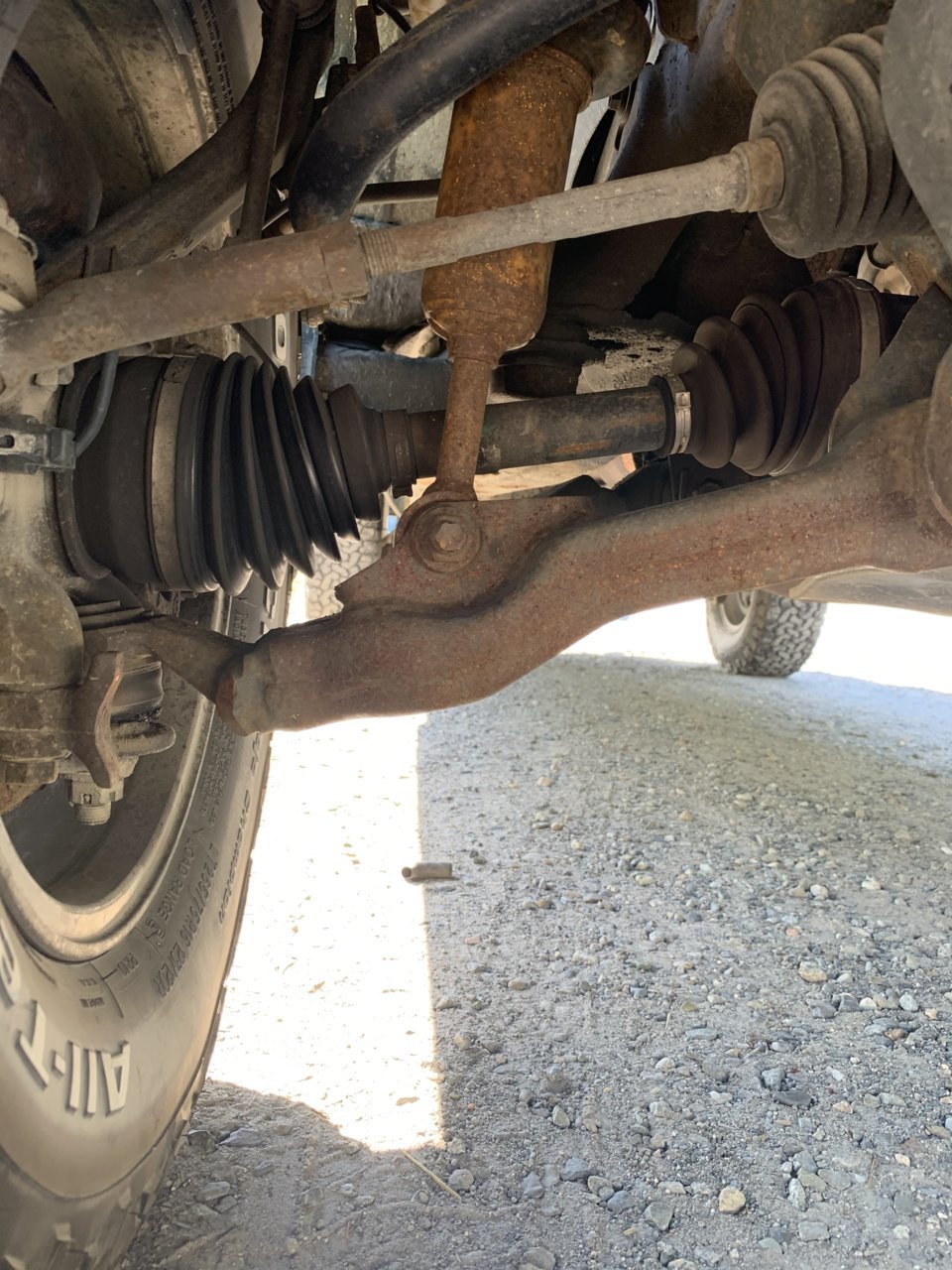

    270CD7F2-12F4-4B68-A7BC-7D87BCD2A7DB.jpgAngle looks pretty harsh, any opinions?

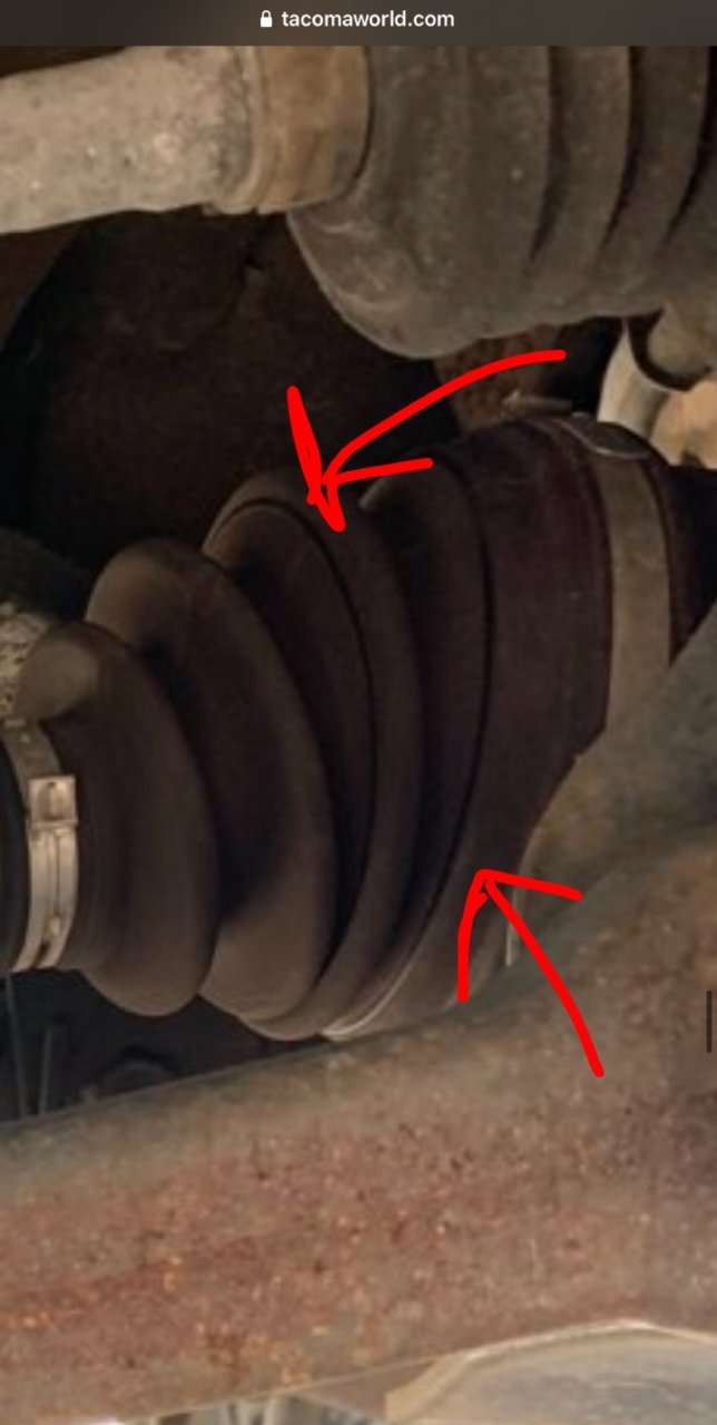

    You can see in the picture where the inner CV boot is rubbing, You can see the line it is leaving.

    FBC4EA49-9235-4B11-A69B-BD27F622F976.jpg Is this the line your talking about?

    Yes

    Honestly its not as bad as I expected though

    Maintenance sheet said cv boots were replaced just before I bought it, makes sense.
    Gonna be a huge pain in the ass to take those out though. Considering I don’t have any wondering and the click only happens at low speeds at full lock in 4w I think I might wait to take them out.
