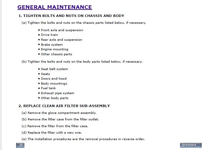

    Not common...
    Only thing I can think of is they got loose.
    I know you said you don't offroad...
    In the maintenance manual, part of the "special conditions" maintenance is tightening chassis/body bolts and nuts.
    From the service manual:
