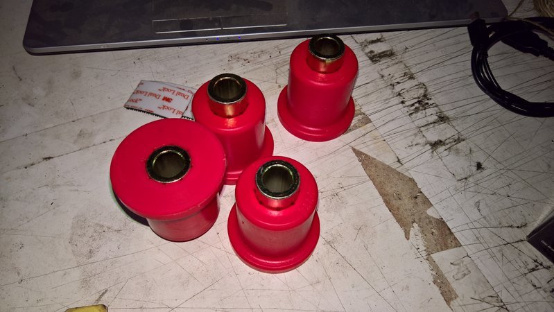

    Found em, if you want them, let me know.

    This is a good starting point.
