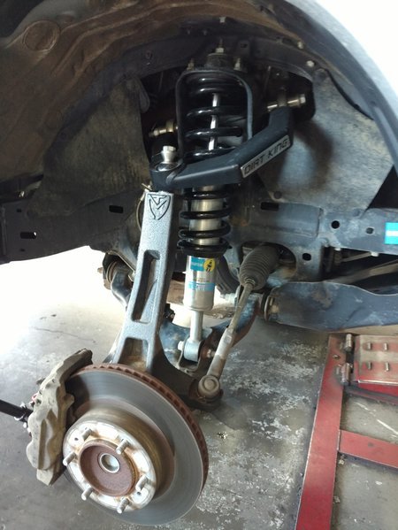

    Dirt king heimed uniballs. Strongest parts, ultimate adjustability, cheapest uca are 450, most expensive icon billet about a thousand. Buy once cry once cause if 500 breaks the bank you should just put that away for gas, maint, insurance, registration and keep your truck stock.
    With the Maxtrac spindles I do feel better knowing the uca is fully fabricated hand welded steel versus, bent barstock with off angle welds and a bolt where there should be a solid mount. Keep in mind I'm in socal so rust is not a biggie. I work hard and only hit the trails once a month in my prerunner so I'm trying to have fun and get my adrenaline pumping which may induce more stress than crawling or mudding, I have never broken an SPC style arm but the way my truck is upgraded now it would be the weak point if it were that style.
