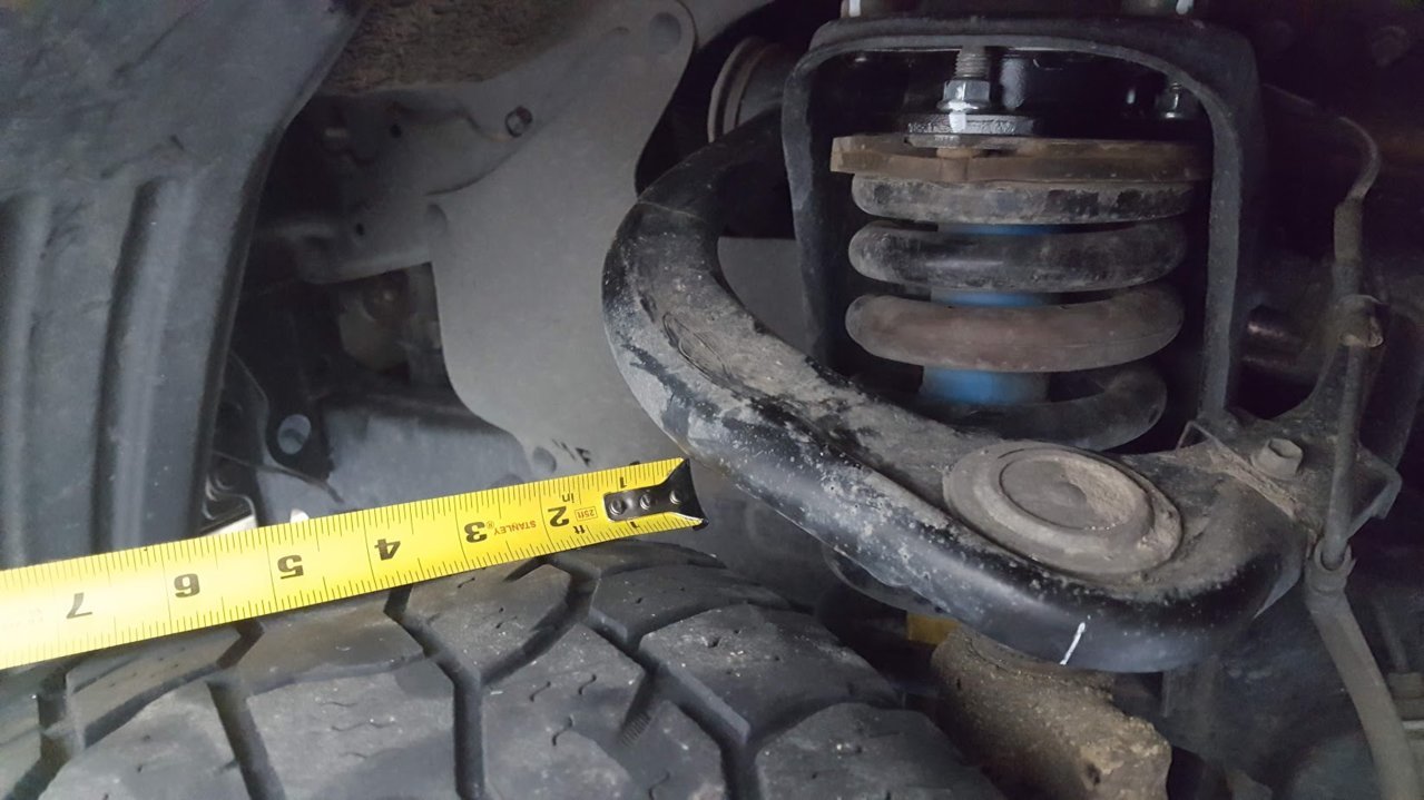

    New Tacoma guy, old time Jeep guy here. I'm working on a near stock, Gen 2, TRD access cab, looking at tire and wheel fit (and lift options). Only mod is previous owner 2.25" strut spacer.
    After crawling around the truck with a tape measure, with the wheels turned in various positions, the first issue I am noticing is that any larger tire size (either in width and or diameter) is likely going to cause issues with the tire rubbing on the upper control arm.
    The stock 265/70 16's on the stock 16x7 +25mm offset wheels barely clear (see pic). No way in heck you could I run chains up the front with this set up, let alone a much bigger tire.
    First question, does anyone have a tire size / wheels size / back space measurement guide of some sort to show how much back space is needed for a given wheel width and tire size, to produce a given amount of clearance around the UCA? I'm seeing all kinds of posts on wheels and tires, but none seem to really hone in on any specific UCA Clearance measurements. Ya your tires "fit", but how much room between the tire and the UCA did you end up with?
    I was thinking of using a 17x7 with +4mm offset (that's only like 3/16" offset) but from what I'm measuring, I really don't think a 255/75 will clear the UCA, even though I'd be gaining a little over 3/4" of "inside clearance" from the wheel, plus a little by moving from the 265 to the 255 tire.
    Ideally I'd like to have clearance to run a heavy duty tire chain (not the phoney cable kind, but real chains), but I think that would require some very aggressive negative offset, with minimal back spacing, even for tires in the 255 or 265 range? Really perplexed how people are fitting 285's on these things. Maybe my truck is some kind of anomaly? Is this strut spacer a contributing factor?
    Second question, how much clearance between the tire and the UCA, and the UCA and the Spring, can you expect to gain with an aftermarket UCA? I'm just looking at every possibility to make room here. Planning to ditch the spacer for an OME coil, but wondering if UCA's are also worth the effort?

    I'm not sure if I'm answering your questions directly but I can provide some info;
    I run 255/75/17 BFG Ko2s on 1st gen tundra/sequoia multi-spoke wheels (17x7 with about 4.75 back spacing) and JBA upper control arms. I have plenty of clearance for chains on my 2nd gen (truck chains have been used, not cables)
    As measured from the edge of the tread block, I have about 2 inches of clearance to the UCA, measured from the sidewall is closer to 1 inch of clearance.

    I'm not really looking to debate the best strategy for chaining up. I'm hoping to get feedback on what type of clearance people are getting between the tire and UCA with various wheel, tire and lift combinations. If you have any measurements to share it would be super helpful. Thanks.

    I'm thinking of trying the Maxxis Bighorn MT in a 275/70 R17, mounted on a 17 x 7 with +4mm offset. I probably won't have enough clearance for chains, but I think it will be an all around good fit. After some measuring, I'm not sure even a 255 would have given me enough room for chains on front. I would have been looking at a negative offset, so I decided to go with a little more tire.
