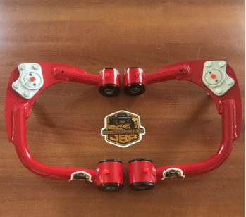

    3). Go with a set of JBA UCA's, which supposedly use stock style bushings (eliminate squeaks and maintenance) and have a more robust greasable/easily replaceable joint.
    I would like to hear peoples experience with the JBA UCA's, at $450 bucks they seem like a bargain. If in the long term they save me money and time without sacrificing functionality then I would just sell my TC's or take the loss. So far the only negatives ive heard is that there are some clearance issues with certain tire sizes, as well as a rusting issue which has supposedly been resolved.

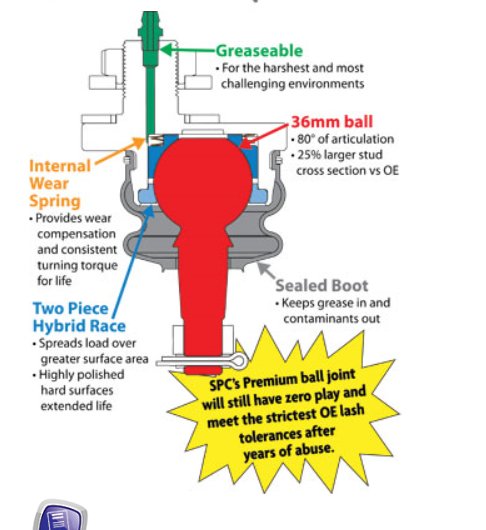

    The main reason I went with SPC's...I wanted an OEM styled UCA that used factory style bushings and greasable style factory ball joints. I had same set on my 08 for 150k miles, seriously!!...the only thing that I did was replace the ball joint to the updated one because their first design didn't have the sert fitting. And NEVER had a squeak from them...

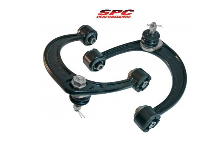

    I've read that alignment shops have fits with these because they have extra adjustment or something? is that correct or was that a different brand? To me it looks like it just has a ball joint like OEM except its a little bigger and greasable? Is the upper threaded section for vertical adjustment? When you need to replace the joint, do you just replace the entire assembly?
    Also, how do the bushings work? are they just rubber bushings which deflect torsionally and spring back or something?
    If you were choosing between SPC and JBA, which would you choose and why?

    No issues with alignment. Its best to bring them the SPC alignment sheet so they know what to do. I think most might have a fit because they have no idea how to setup the SPC. The threaded section is just a nut that locks in a steel plate that you use to roate the balljoint to get the right alignment, additionally the balljoint can be moved inward or outward for further adjustments.
    http://www.spcalignment.com/instructions/25480-INS_WEB.pdf
    I chose between JBA and SPC and picked SPC because it was way cheaper. Either will work fine.

    oh... thats interesting. So then technically these offer about +2 degrees of additional caster adjustment than any other Control arm?

    TRD Baja Kit with JBA UCA's 1/2 inch spacer on top, Medium Dakars with BAMF hangars and super bumps all around. 285/75/16 Cooper Discoverer AT3 XLT's on graphite TRD faux beadlock wheels. Pro skid powder coated black with Pelfreybilt aluminum mid skid and aluminum gas tank skid.
    I did a lot of research before I did my lift because my truck is a daily driver so I went with the standard JBA's that have 2 degrees of castor built in. Main reason I went with them was I didn't like the uniball being exposed to the elements and having to worry about them being so exposed. The JBA ones are more like a normal ball joint and are easily replaceable if they ever need to be replaced. I used to work at an import shop and they used SPC stuff all the time. Never had any issues with their stuff and they are a great company I just didn't need that much adjustment. The JBA's aligned great and after about 5000 miles on them they are still squeak free. For the price they were a steal and the customer service is top notch. There is a whole thread on them too.
