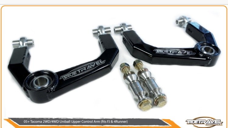

    IMG_2136.PNG.jpg Hey everyone so Black Friday I bought a set of true travel dynamics's UCA's. I'm installing my lift tomorrow. 2.5 fox fronts 2.0 fox rears both with reservoirs. All pro leaf pack. I'm going with 285 75 16's. My question is does anyone know how far to adjust the heim joints in or out ? I called true travel but they weren't much help.
    They said "leave a few threads showing and try it if it doesn't work just re adjust."
    Any suggestions? Thanks

    Id leave them. My icons i i did not have to adjust. I just align it every time using the lower control arms. They could help you get a better alignment though if your struggling getting it with the stock adjustments. Icon had mine set similar to where a tubular bushing arm would be that doesn't adjust. So again, assuming this company did the same, I'd leave them

    They are beefy. Appear to be high quality. Customer service wasn't the best I had to guess on the heim joint adjustment as far as alignment I don't know yet since I haven't had the truck aligned yet because I couldn't get the fox coilovers to adjust. Gonna try again to adjust em again and then get it aligned.

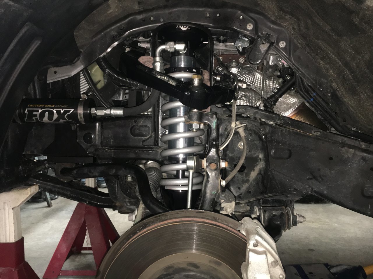

    IMG_2143.jpg Thanks I'll give it a try. Here's a pic of the UCA's installed
