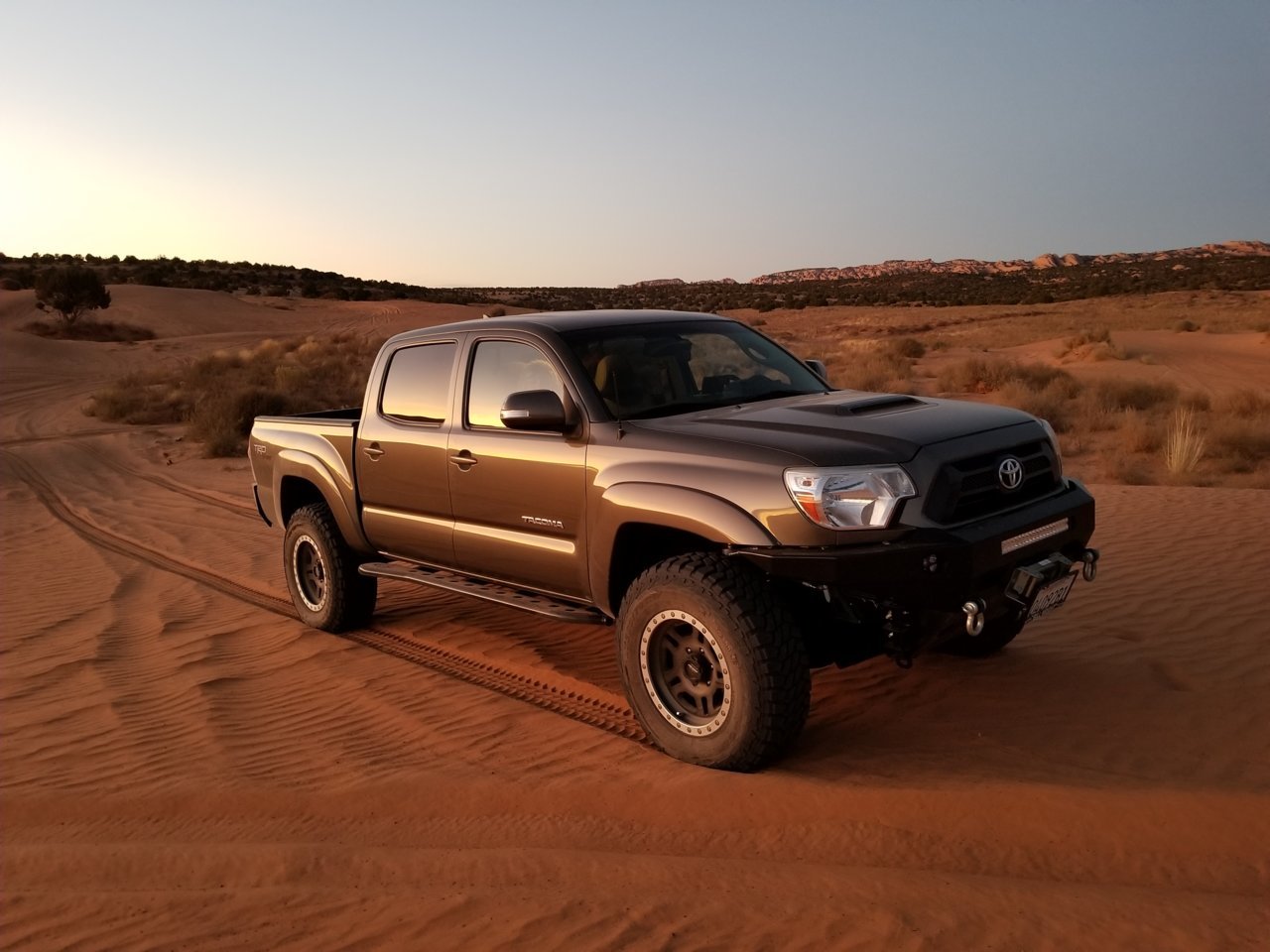

    Do it right the 1st time and never look back. Trust me, you will be glad in the long run. I did this last year. No regrets at all. Truck drives straight as an arrow and no weird tire ware. Good luck with your truck.

    beefy spindle and gusset! Custom?

    Total Chaos, also did ECGS bushing, Marlin Crawler LCA braces, BAMF hangers and ARB air lockers. Then off to Moab for a week.
