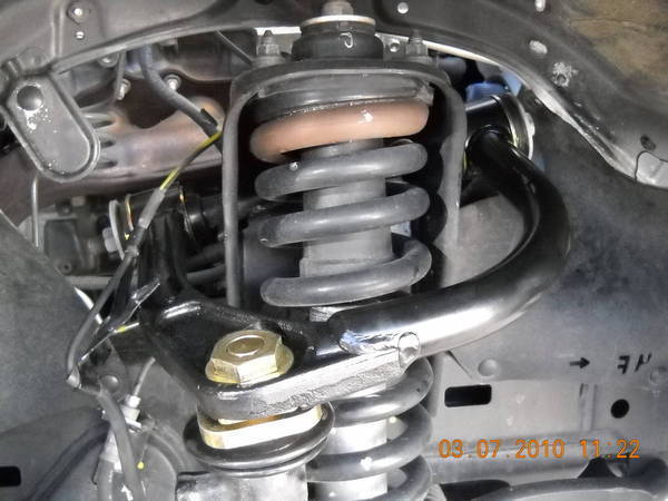

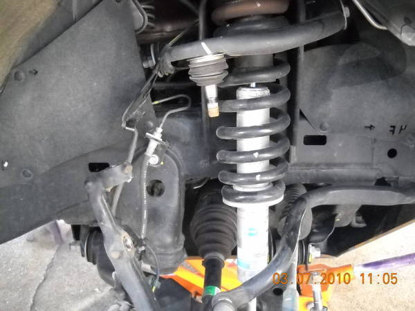

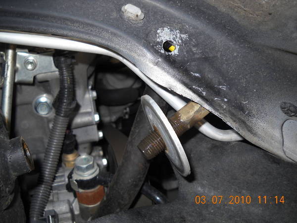

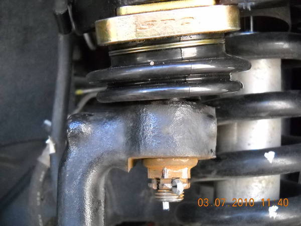

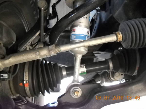

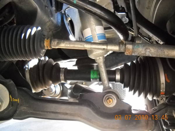

  13. Mar 7, 2010 at 2:09 PM
    brutalguyracing
    brutalguyracing [OP] BIG DADDY
    Jun 28, 2009
    #19000
    24,046
    F.U> GUYZ
    broken mods

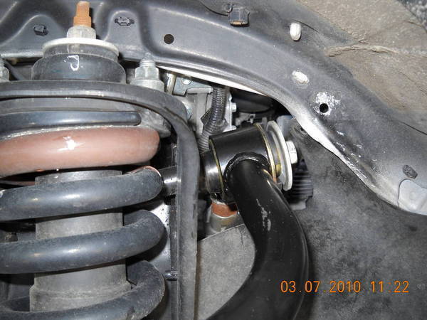

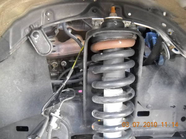

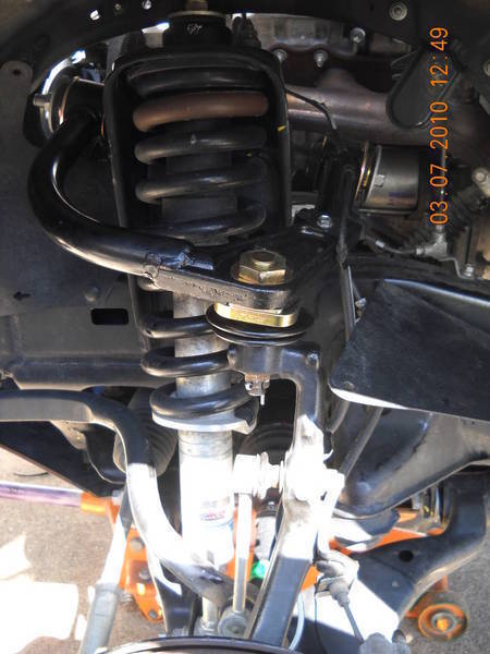

    yea baby all done...it was a quick and easy job
    thanks guys
    i had bolth side done from start to finish in 1 hour 45 mins...
    i post some pics in a min....
    does everything look ok nothig backwards???
    the last 2 pics are of my cv's how do they look
    how do these # look??????? 265/75/16
    driver front----36 3/4 pass front-----37 1/4
    driver rear-----37 1/2 pass rear-----38
    and i get my alingment tomm... i want 0 / 0 / 2.4 correct???
    thanks again guys

    Looks good man. I don't know anything about the LR UCAs...so someone else will have to chime in on those.
    0/0/2.4-3.1 will get the job done (Those should be factory specs...so it should be a non-issue)
