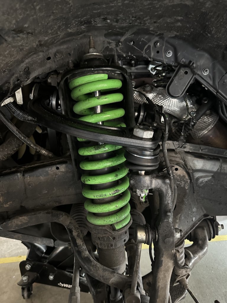

    Yeah.
    Take the battery out and get the wiring and brackets loose from the inside of the fender well under the hood. You can then see how much you need to bend to get the driver's side bolt out. I just used a crescent wrench, closed it down on the metal and kept bending it back until I had enough room. It will come out. I bent it back after replacing the bolt. Passenger side is a little easier, just get the stuff out of the way that is attached (some A/C lines or something are attached to a bracket there if I recall).

    While you can get it with the battery still in, taking it out will make things a little easier. There is a wire mount bolted at the bottom of the tray and that has to be removed for the bolt to come out.
    I had to tap the bolt to get it passed on point that couldn’t be bent. I also removed the brake line mounts near the nut so I could torque the nut. I used loctite too.
    I just replaced my SPCs last week due to play in the bushings. About 20 min for the passenger and 45-60 min for the drivers side. I also
    Got new bolts and nuts. Under $20 from rock auto, in case you needed them.
