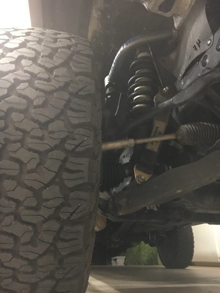

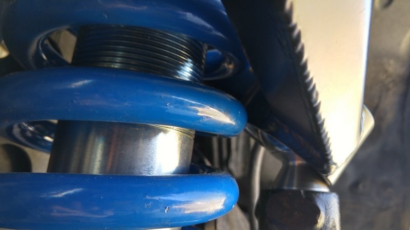

    I don't see how. The contact between the UCA and shocks is being made when the shock is extended, not when it compresses.

    Another example of this problem being hit or miss. I'm surprised that vendors don't hear about these problems.
    Downsouth and Dirt Kings say that they've never encountered this problem with this setup. I guess people don't report it to the vendor and find other solutions or live with it.

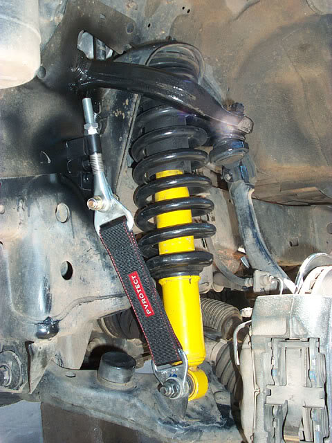

    I have Icon 2.5 extended travel coilovers with Total Chaos UCAs. So we kinda sorta have the same thing. I would say put limit straps in that catch the suspension right before they make contact. I will post pictures tonight of my truck at full droop with the limit straps.

    Thanks. Who makes the limit straps?
    I have 700lbs springs on the shocks right now in anticipation of a new bumper and skids that are being built right now. So the truck is riding a little high at the moment. So as it sits right now there's hardly any downtravel before the UCA hits the shocks.

    Hmm. Then i would wait until everything is installed then before proceeding with the limit staps. And there are several companies that make them. You can just pick what you like best.

    Get some straps. That uniball is touching the misalignment spacer. You are maxed out on travel. It will save your uniballs too and probably prevent shearing the UCA bolt.
    Something like this. You can get all the parts at an off road shop. You'll need to weld the clevis arm to the frame.
