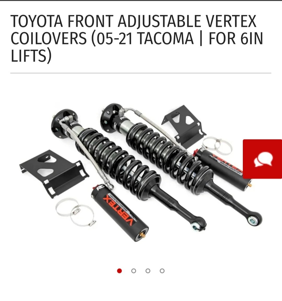

    Agree the coil spring looks too short or not stiff enough. Try adding preload. If the spring truly is 740#, then adding preload should make a big difference.

    Just did that, didn't do a darn thing. Rough country said they would refund me

    Rough country said they would send me a coil spacer (band-aid) or refund me. I'm going with the refund and getting Kings, fvck it Whats a few thousand more diners.

    I'd personally do Fox or Kings over RC, but I would still do what someone suggested -- measure and make sure they sent you the right ones. They appear to have a 3", a 3.5", and a 6".

    I would try adding some preload to those before you jump to something else. It's worth the effort

    Is there another spring that could work? 6112 650#, Eibach 700#. I'd order springs and swap. Eibach ships out fast if you call it in.
    Also did you max out the preload yet? Or just a few turns? Pics of current preload?

    It’s sitting on the bump stops. That’s literally all that’s keeping it up right now. The coil is so close to bound as it is, simply put he needs a heavier spring no matter which way you cut it.

    Which confirms that rough country "tech support" is a bunch of simps who don't know what they are talking about. 740 pound spring rate my ass.

    That's all the adjustment I have left, about 4 threads. Trust me it ain't gonna so crap for my truck. The springs are so compressed I can't even get my index finger between a coil, and I have small fingers

    Adding preload would be the other way. Looks like you are near topped out. In their photo online it's preload to the max.

    I agree that you might need stiffer springs, but I still think they sent you the wrong length shocks. While you are sitting on the bump stops, you've probably got a good 2"-3" or so of wheel travel left in those shocks (wheel moves 2x as much as shock). They just look too short to me. Putting stiffer springs on that pair of shocks doesn't look to me like it is going to get you back up to where your CV axles are level. But, that's just eyeballing from a long way away. You should measure and verify.
