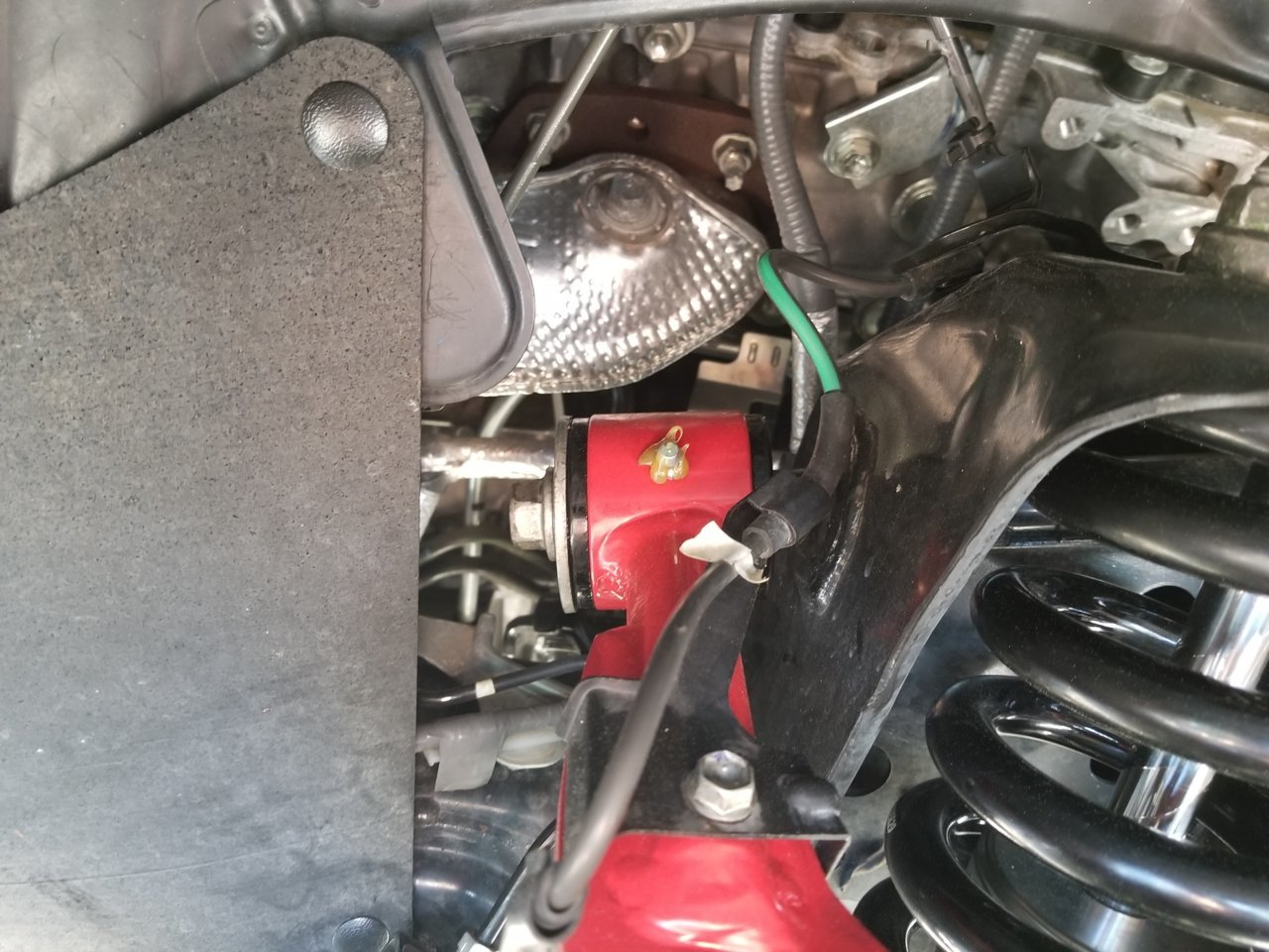

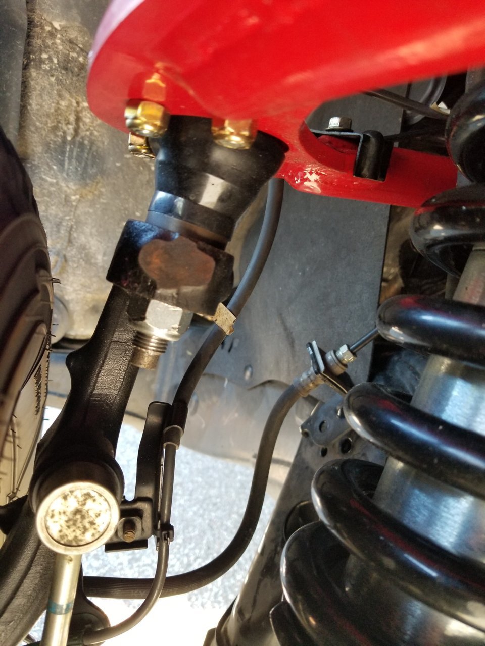

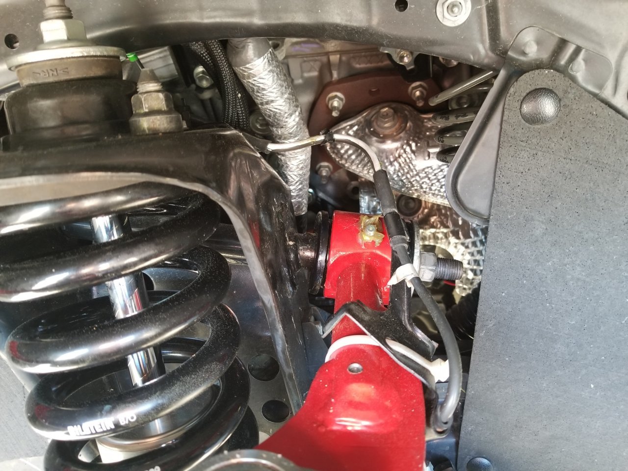

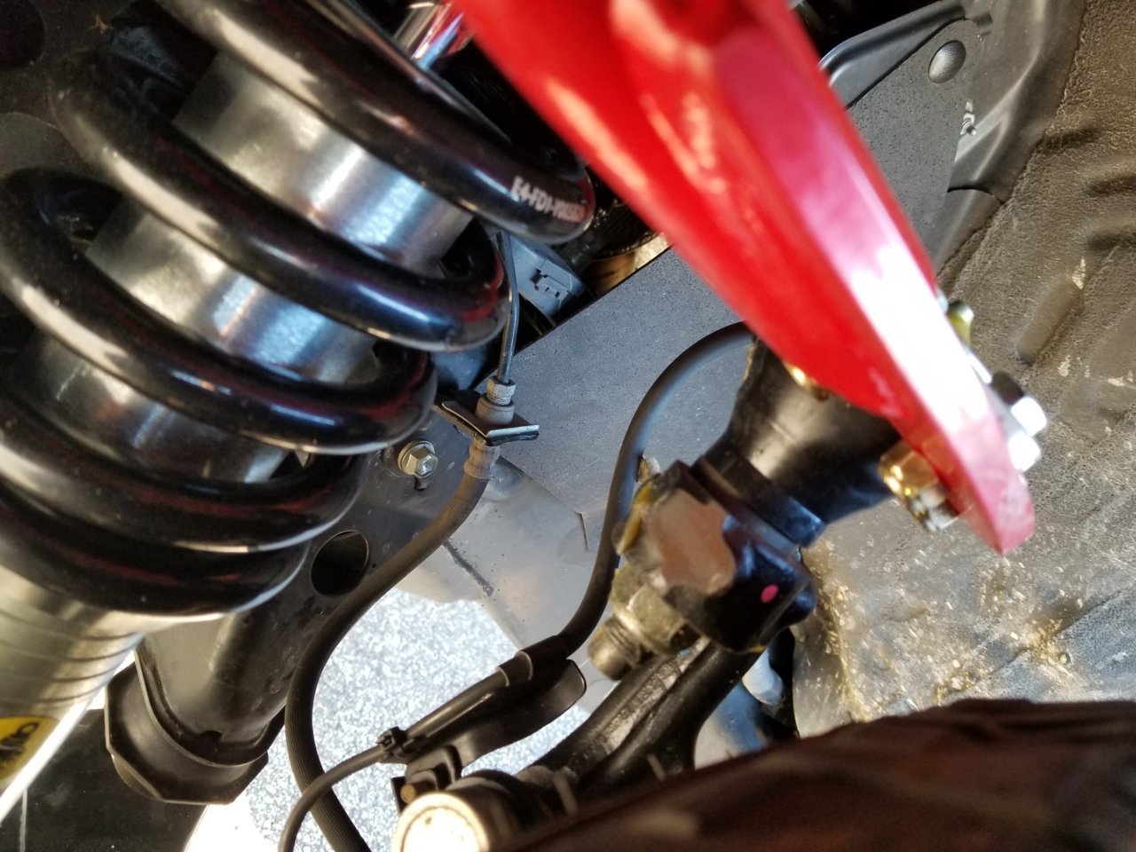

    Hi all. Thanks in advance for any help.
    So installed a lift yesterday with JBA Offroad UCAs. went today to get everything aligned and found that there is wobble in the front wheels and vibration when braking between 20 to 30. Followed JBAs instructions and not my first time working on suspension but I dont know what went wrong. Any ideas.
    Pictures probably wont help much but here you go:
    please excuse the zip tie, bolt sheered off in the arm

    It is hard to see in the pics,but is there a flat metal washer on the inner side of the control arm bushing? Seems like there should be and I don't see one. That will definitely make a vibration and wobble.

    I don't remember there being one on the stock ones just the one on the outside. But I could be very wrong, could someone post a picture of their JBA UCAs

    You are missing both inside washers.
    I wouldn’t drive like that

    you reuse the factory washers there

    Well the OP has zerks and non oem bushings so he needs the inside washers like shown in the install video. Without a washer on the inside the bushing will walk out of the arm.

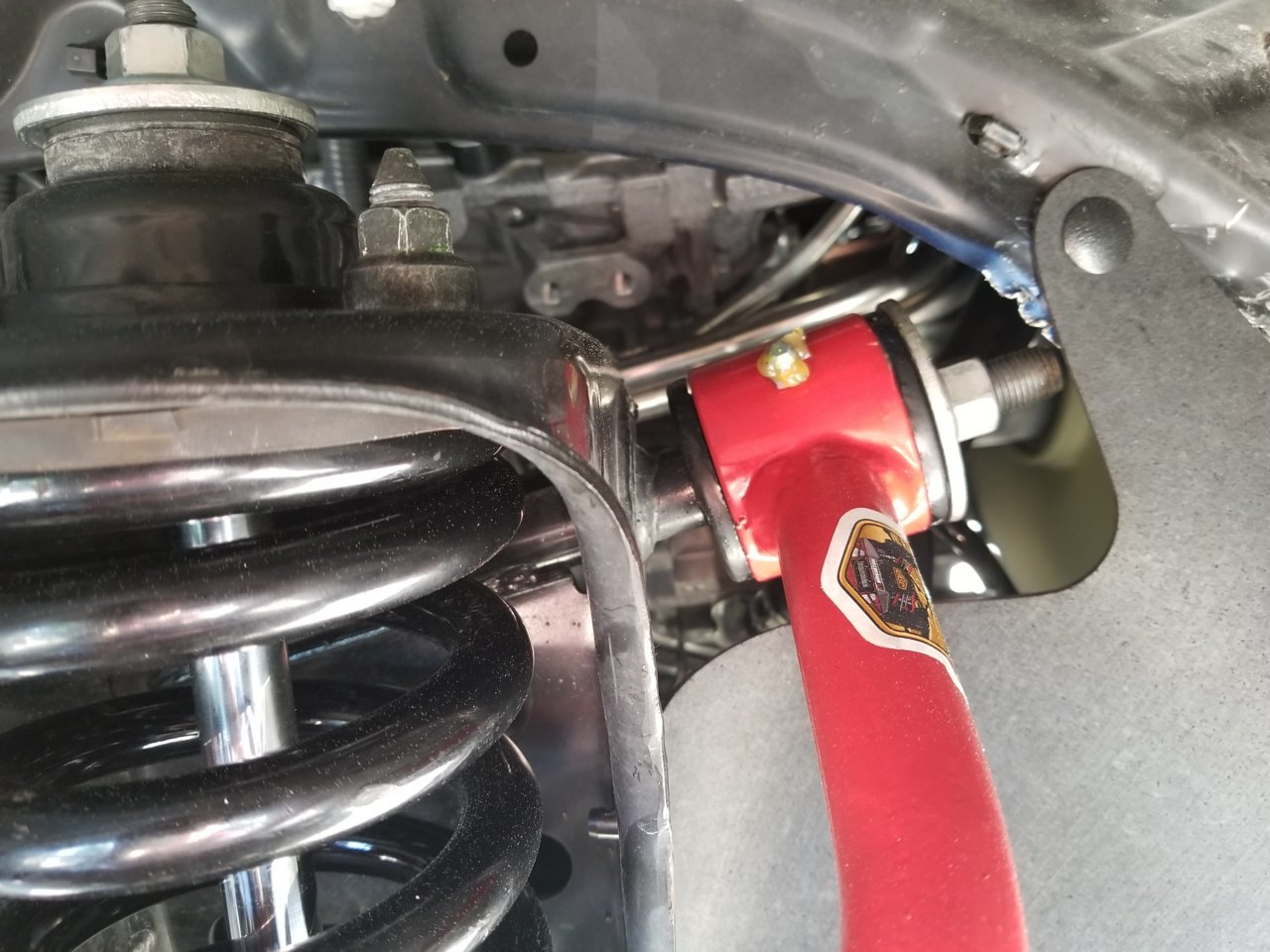

    Same ones I just did last weekend. 2 skinny washers go I side. 2 fat one's on the outside.
    Might need a big lever to make it happen. My parts came with a set of instructions. Did yours happen to come with a similar sheet.

    We’ve installed 6 sets to date, all had inner and outer washers.
