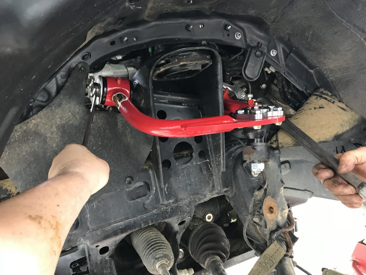

    The UCA bolts are not easy to get out, they hit the sheet metal in the wheel well when you try to remove them. I cut and still couldn’t get the bolt out on the driver side, so I cut it twice. I then had to bend the metal to get the new one in since the fuel lines blocked it from going in backwards.

    BlakeM
    BlakeM Well-Known Member
    Jan 9, 2017
    #207016
    1,413
    Blake
    Gonzales, LA
    2023 T4R.SR5.4WD.OMG.LOL.WTF
    This
    It’s the bolt being tightened in this pic.
    And what @Sub_Par said

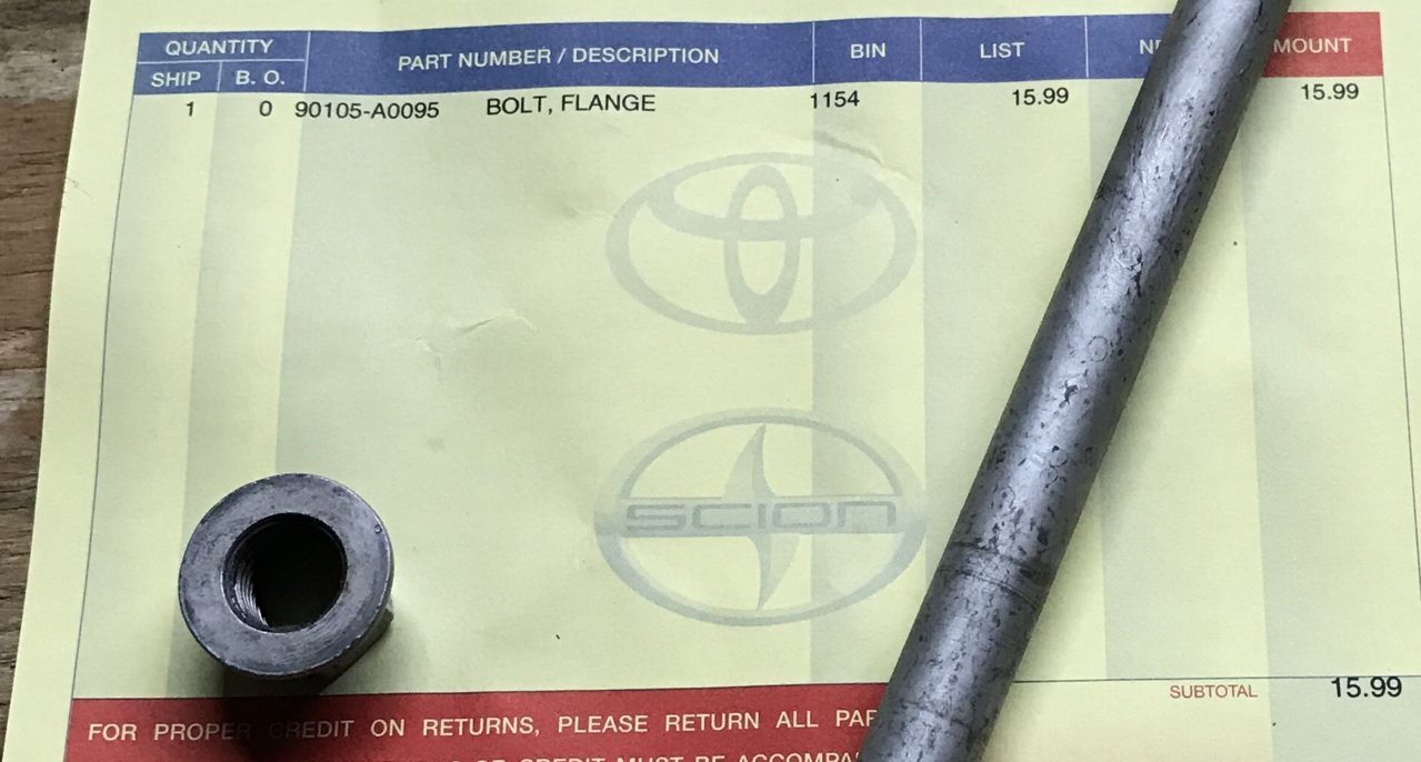

    Oh OK. So new bolts would mean you could just put them on when you removed the assembly? Could someone help with a link to where to get these bolts?

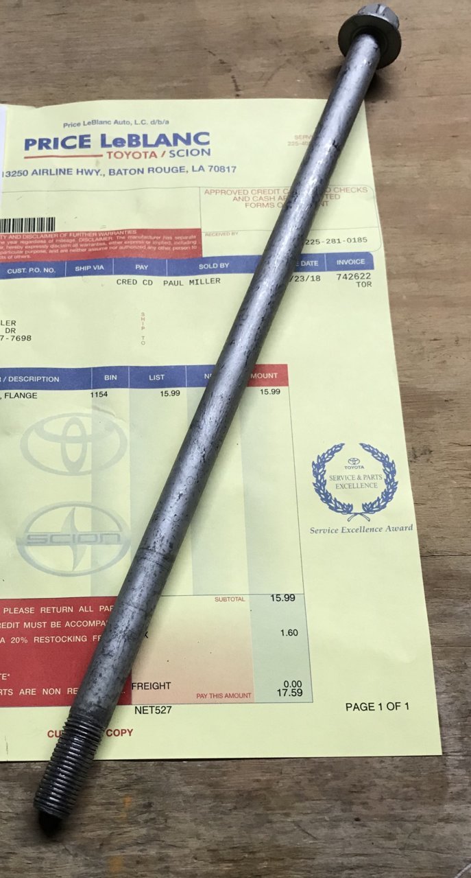

    Ah I see! Do you have a link or at least the part numbers to get these bolts he needs? Would be much appreciated. I'm on a 2018. And I take it he would then just cut the bolt instead of trying to pull it out.

    I just went to the dealer. They had one in stock.
    Here’s the part number.

    Thanks man. So I need 2 of them I assume?

    Yup :thumbsup:
