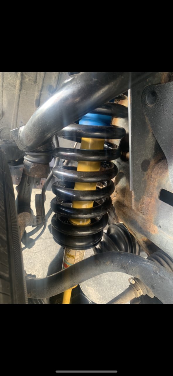

    When I saw the pic, I thought, Holy Crap! Glad you asked and people got you all squared away. In addition to everything posted, you should get new top hats and a 1/4" lean spacer for the left side.

    Holy crap, yeah, that's a lot of lift...too much. For starters, get rid of the top spacer. I won't bash the spacer, but combined with that spring, you're trying to stuff ten pounds of shit into a five pound bag.

    Get rid of the spacers and get ome nitrocharger 90021 shocks and you'll be golden.

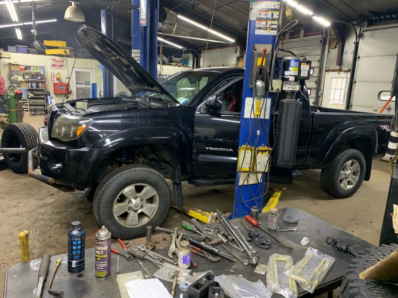

    Pics of the whole truck please...before you take the spacer out.

    Spacing for the front bumpstops as well could be an issue

    I second :thumbsup:
    We need to see this beast!

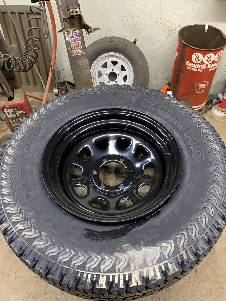

    Bf any says it for me. Yes I now know these won’t clear the caliper. I really love the look of this wheel tho.. Any suggestions for rims anyone?

    It'll be better once you get the spacers out or swap the springs.
    You could look at SCS, if you can catch them with in-stock inventory.
    Their Ray 10 looks similar.
    I'm partial to their F5 model, when I get to the new wheel stage those are on my list.

    Yeah, so the spacers gotta go. How did he manage to get the strut in?

    THAT is a damned good question.
