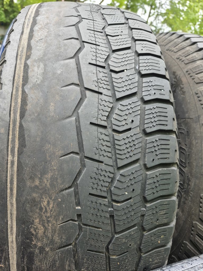

    In January I replaced factory UCA, LCA, and tie rod ends with Mevotech parts and put on a fresh set of coopers for winter. 5 months and less than 20k km later this is what the front tires look like.
    I had always had increased inside wear since buying the truck (with lift kit installed) nearly 3 years ago. Had significant play in factory ball joints which prompted replacing uppers and lowers. Recent wear on tires is drastically accelerated.

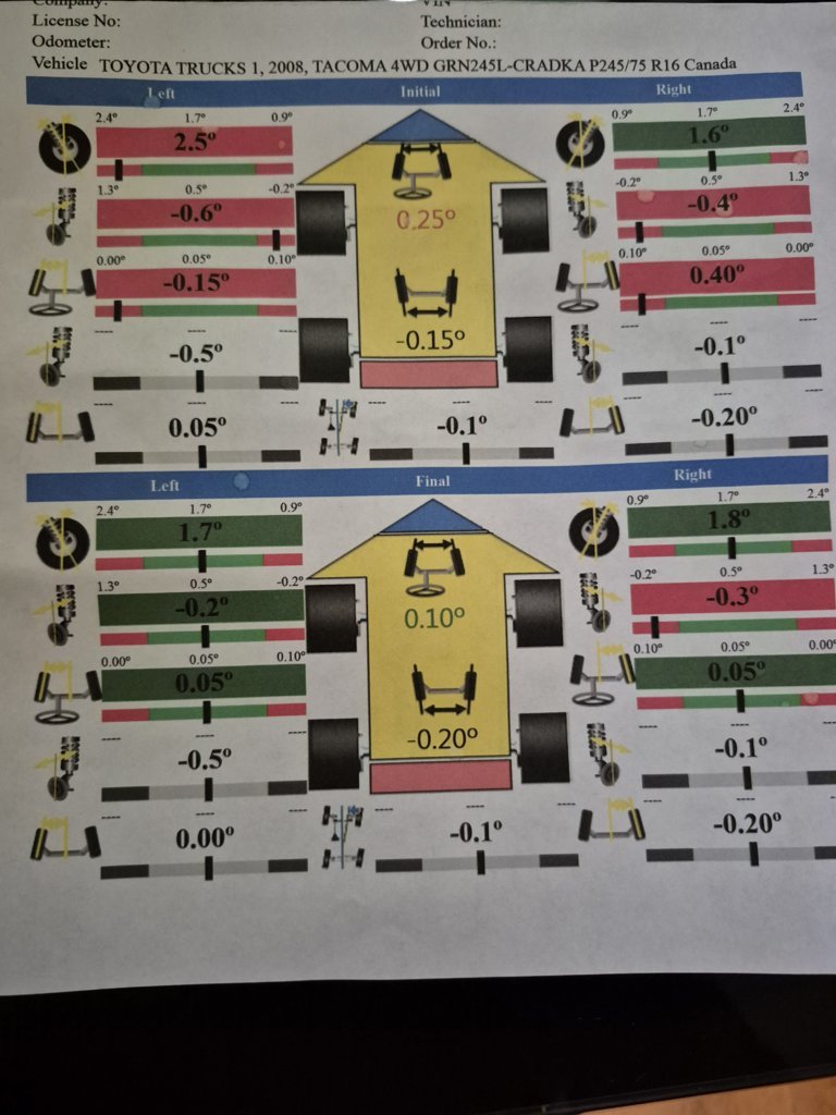

    Alignment specs from yesterday. Final spec is pretty much where it was at in January after all the front end work. Everything is easy to get to spec except camber, and it seems like camber is falling way out of spec fairly quickly.
    Mechanic is recommending adjustable UCAs to help get camber into spec since lowers are maxed out. Suggested SPC. Went to the forums and saw everyone shitting on SPC and recommending JBAs. As far as I can tell JBAs come with increased Castor but not Camber. Looking for any insight or recommendations/experiences.

    Looking at your sheet, I suspect the wear on that tire came more from the toe alignment being off than from the camber (-0.4° - 0.6° camber alone shouldn't do that to tires in just 20K km (12.4K miles).
    Assuming you had the frontend aligned right after you replaced the UCAs, LCAs, and tie rod ends, I would say something may be moving around under there that shouldn't be (something not properly tightened).
    Check the bolts holding the drop-down crossmembers to the frame (the torque specs on these are pretty high, 175 ft-lbs or more, I recall), as well as all the control arm bolts. Make sure your wheel bearings are good & tight (the alignment place should've caught this if they were bad, but it doesn't always happen).
    The possibility is also always there that the first alignment place botched the alignment as well (this does happen somewhat often unfortunately).

    JBA is one I've been considering as well, mostly so I can set up the suspension for a bit more droop travel than the stock UCA allows for with my Fox 2.5s, but the adjustability of the SPC would've also been nice to have.
    JBAs might not have any built-in camber correction, but the additional caster correction might allow for a bit more leeway in adjusting the cam bolts at the LCAs, which might be enough to get the camber a few tenths of a degree better (this because Rough Country went rather aggressive on their 6" lift as far as angles go, their drop crossmembers only drop down 3.25", so the last 2.75" lift is made by boosting the control arm angles up higher). Another option might be to lower the lift a small bit (to around 4.5" - 5"), which would also bring forth a tad more caster angle availability (and therefore cam bolt adjustability) as well.
