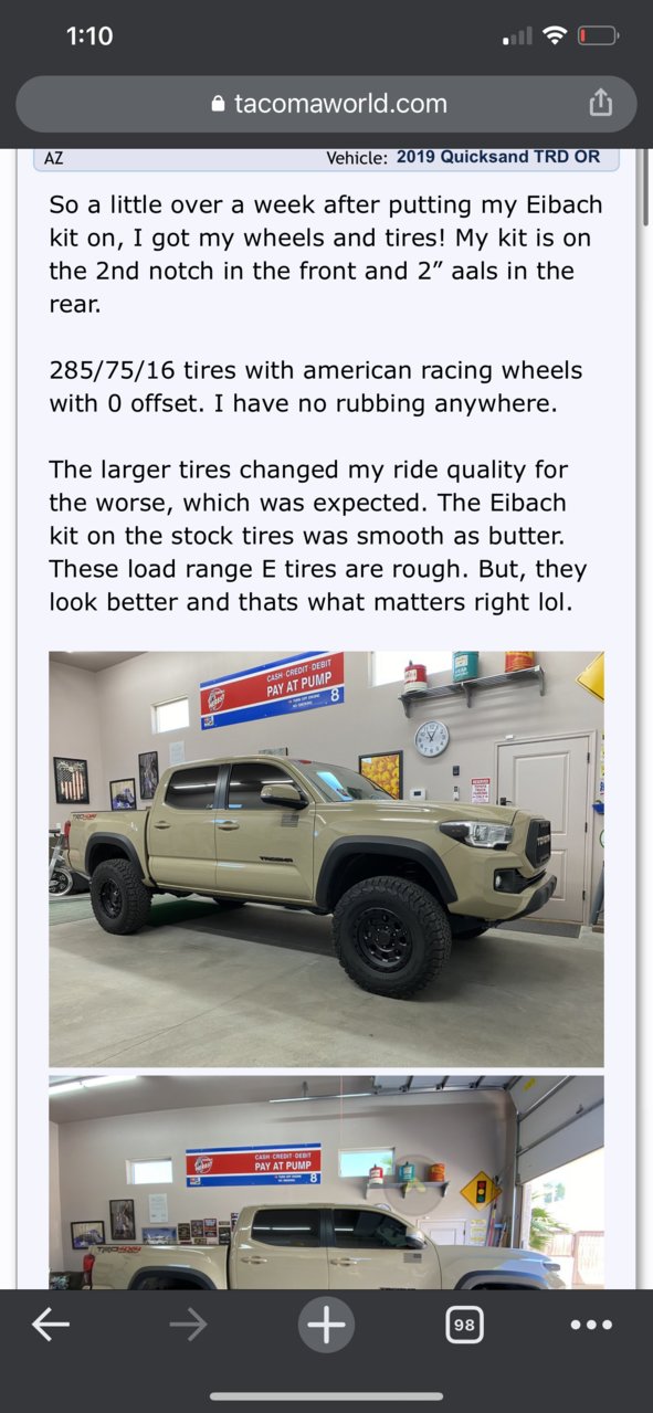

    Ya looking at the fn 5 star wheels Dustin has 16x8 -25
    and 265 75 16
    Orrrr saying f it and selling this tires and doing the 17 8.5 -6 5 stars he has lol

    Inwas going to run the eibach lift on second notch (2.5in) and 2in aal in the back with OL
    Left in
  10. Apr 14, 2022 at 8:48 AM
    #30
    lee1092
    lee1092 [OP] Well-Known Member
    Jul 11, 2018
    #259008
    962
    Lee
    Charlotte, NC
    18 MGM Tacoma
    That’s what she did
