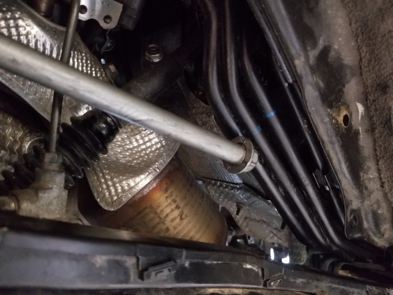

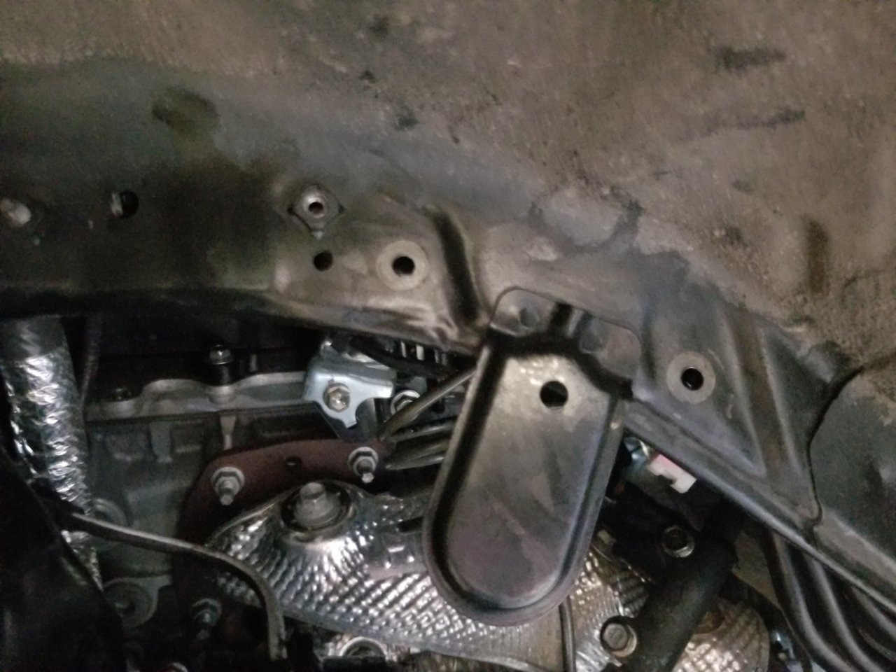

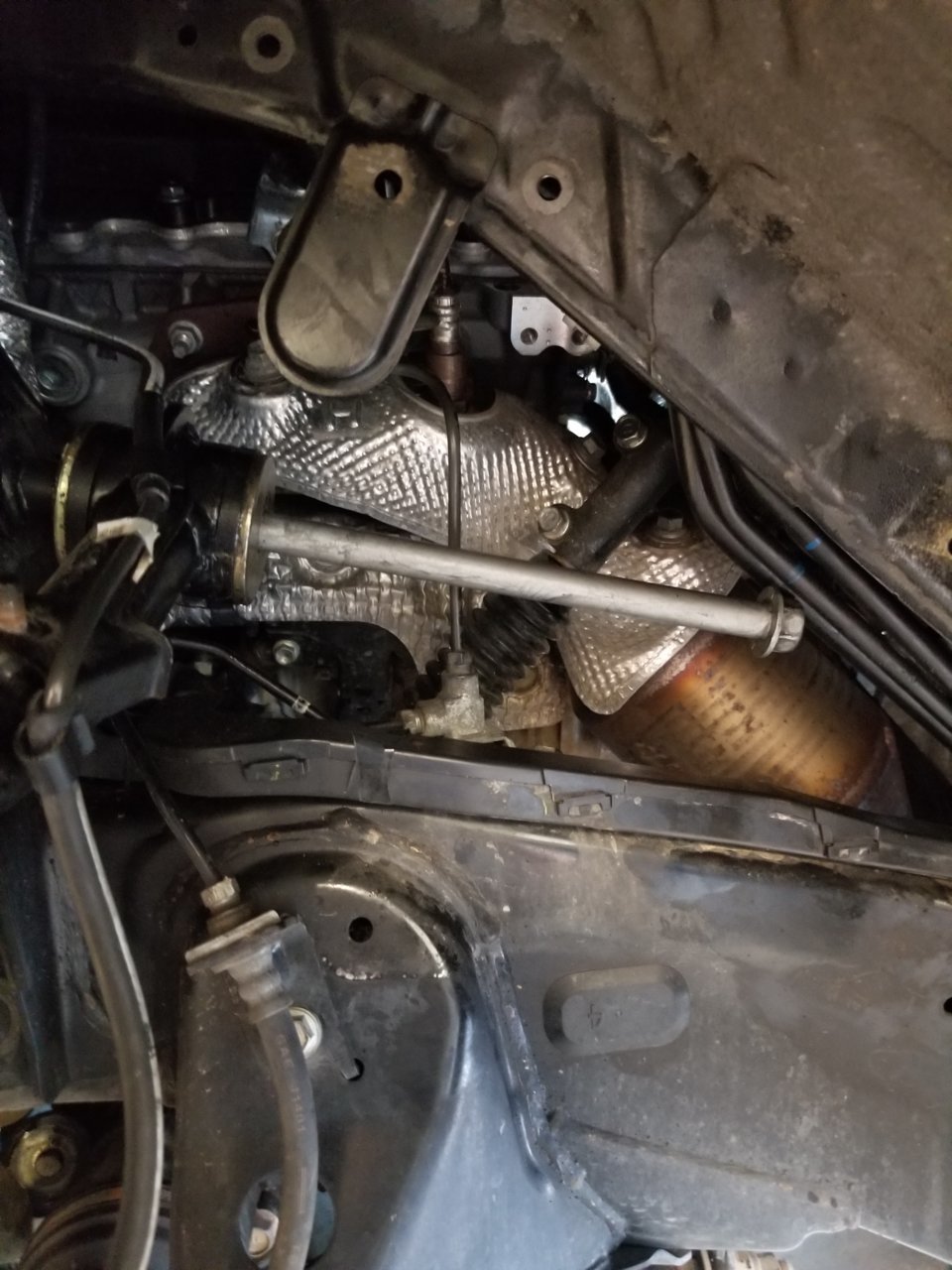

    I'm in the process of swapping out my Icon uniball UCA's for JBA's
    When I previously replaced them, I cut the bolt and flipped it. I remember the driver's side being a pain because of the brake lines, but for the life of me I can't remember how I got around them.
    Anyone know what I have to unbolt/clip to move them out of the way?

    I believe those are fuel lines ;) The brake line is thinner tube wound into a coil.
    • Unbolt the plastic bracket holding the electrical harness to the strut tower
    • Unbolt the 90-deg fitting for the brake line from the frame.
    • Using a pocket screwdriver, CAREFULLY pop the fuel lines from their white plastic holders. This will let you spread the fuel lines slightly so the bolt head can fit between them.

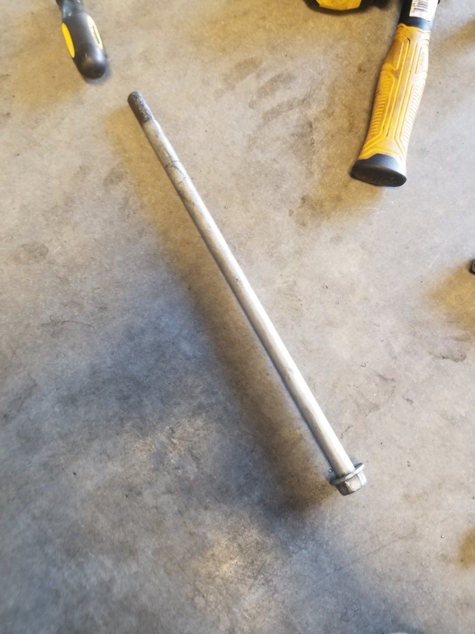

    Old thread, but I'll be doing this soon. Is it easier to get new bolts and just cut the old ones in half to get them out? Or do you just have the same issue again with the new ones going in? I don't really want to bend anything if I can avoid it.

    You'll get a ton of different answers here. I've done 2 bolt cuttings and assisted with 1 bending. Cutting seemed easier, but only slightly.
    If you opt for new bolts installed in reverse, I'd recommend placing witness marks on the nut/bolt, that way you can see if it loosens... however, if properly torqued, they'll never loosen.

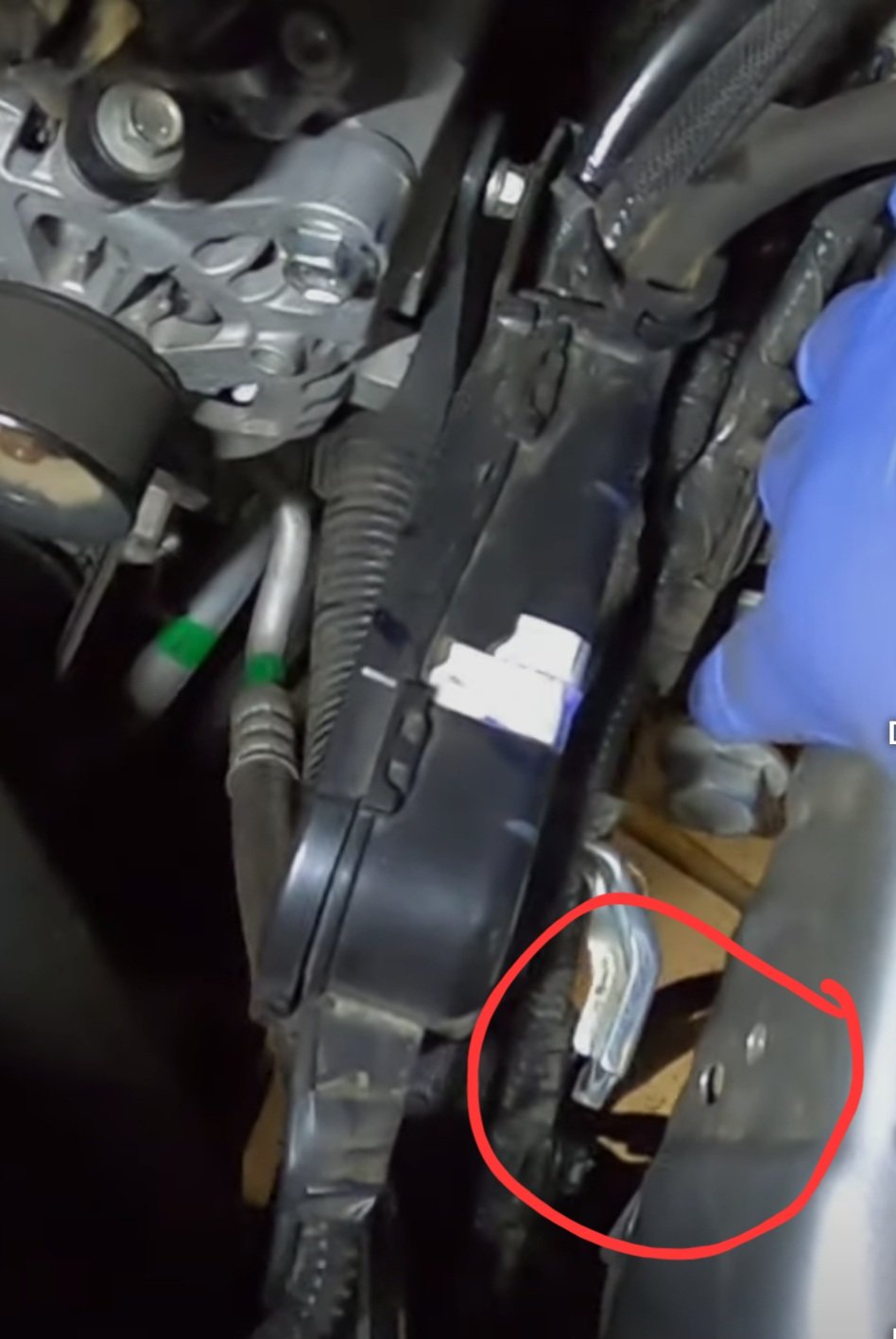

    4 wheel parts never bolted my electrical bracket back on mine after install. Does anyone know the size of this bolt? Screenshot_20240816_032627_YouTube.jpg

    ^Going by memory, it has a 10mm head, which means M6 thread. You can temporarily remove another 10mm-headed bolt from the truck and try it there to verify (e.g. the one on the OEM UCA holding the wire clip).

    That's exactly what I did I removed one from the power steer reservoir bracket. I just wasn't sure if they were the same length since the power steer reservoir bracket had some sort of gasket.
