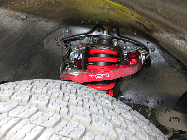

    Yes, Toyota's prototyping shop also installs the bolt pointing forward. See 2022 TRD Pro press photo:
    Production models have the bolt pointing rearward again. My photo at my local club meet:
    AL9nZEVV5kcA9ZmtiNWNK_Cy2PPx8vOYK1YyMRA__2d2b2577517d292df8beaa7453ba4d5546b2227c.jpg
    Toyota likely did it this way to ease installation during production - workers can have the UCA hanging with just the bolt inserted while they turn around to get the nut from the bin. The entire suspension (UCA, LCA, shocks) is installed onto the frame, possibly on a different line, before the body is dropped onto the frame.
    Being a rotating joint with the bolt in single-shear, the nut has a tendency to loosen, particularly if you do a lot of dirt roads. Mine came loose twice, so I now use M14x1.5 stainless nyloc nuts there, though it requires a larger 22mm or 7/8" wrench to tighten.
