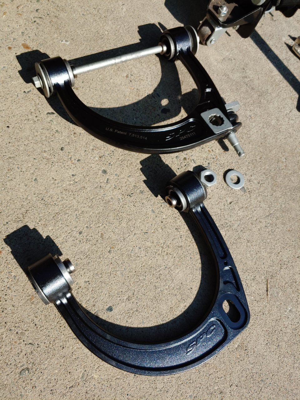

    Those are both rear UCA's :bananadead:

    There's only one way to put em on. The ball joint is closer to the rear of the vehicle.
    Edit. The bottom in your pic is driver side. You can see that the rectangle piece with the star cutout goes on the bottom. Here's the instructions.
    https://www.spcalignment.com/instructions/25480-INS_WEB.pdf

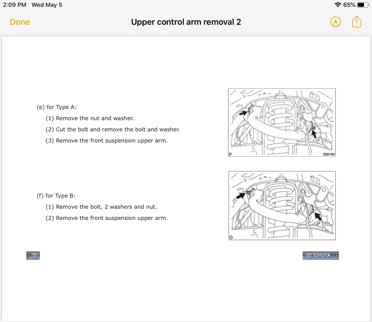

    I ended up cutting mine & flipping them around because clearance on my particular truck wouldn't allow bending. Like seriously, it was so far off I'd have to cut out the front part of the inner fenders, so far off.
    Would I cut out the bolts again? 100% yes without hesitation. New bolts are cheap and certainly worth the cost not to bend/smash my sheet metal to hell. I reinstalled new bolts with blue Loctite and marked mine with torque seal to see if they move. They haven't moved.
    Regarding the decision to cut the bolt: Read this thread, also read this thread. Of specific note, read this post where even Toyota apparently changed the FSM to say flipping is fine. Understand the risks/concerns and make your own decision.
