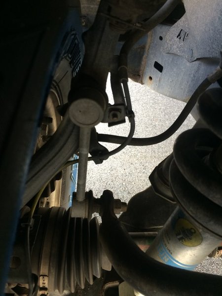

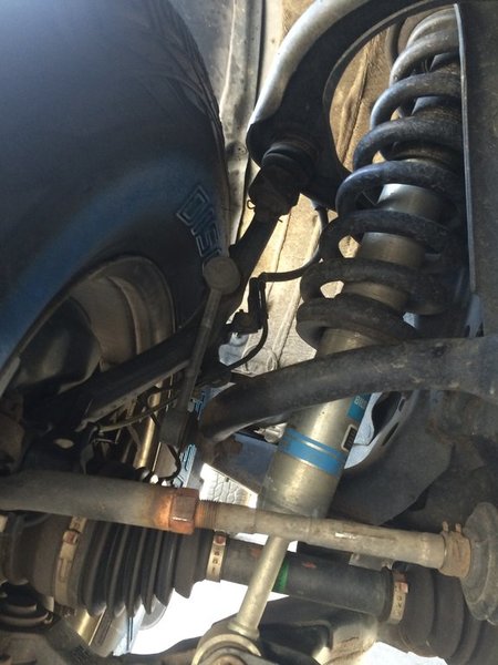

  6. Sep 26, 2015 at 4:24 PM

  7. Sep 27, 2015 at 11:15 AM
    Chuy
    Chuy Well-Known Member
    Aug 4, 2008
    #8328
    4,112
    Lakeside, CA
    07 V6 DCLB 4X4 Sport
    Silver Taco
    You are OK. But, see that little protrusion on the knuckle? That's where most have fit issues. That's where you need to keep an eye if you air down.
