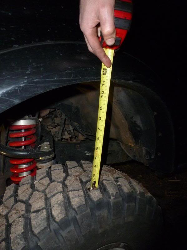

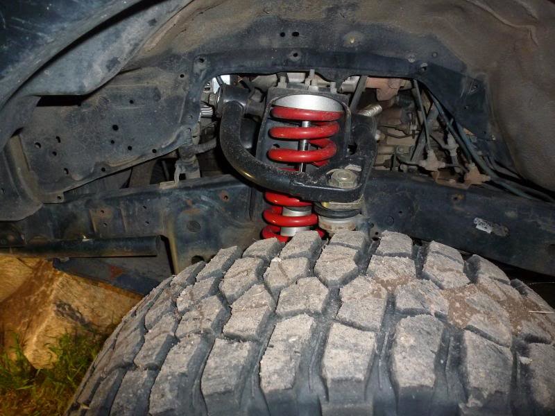

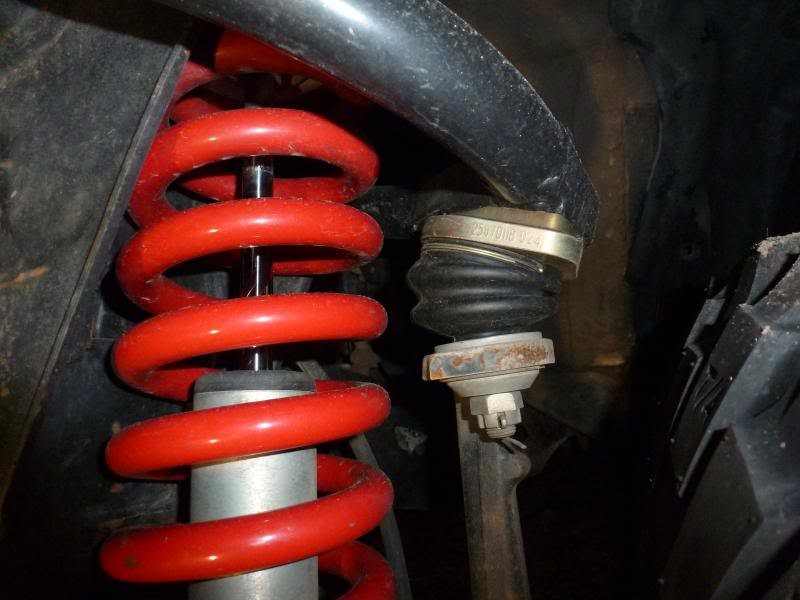

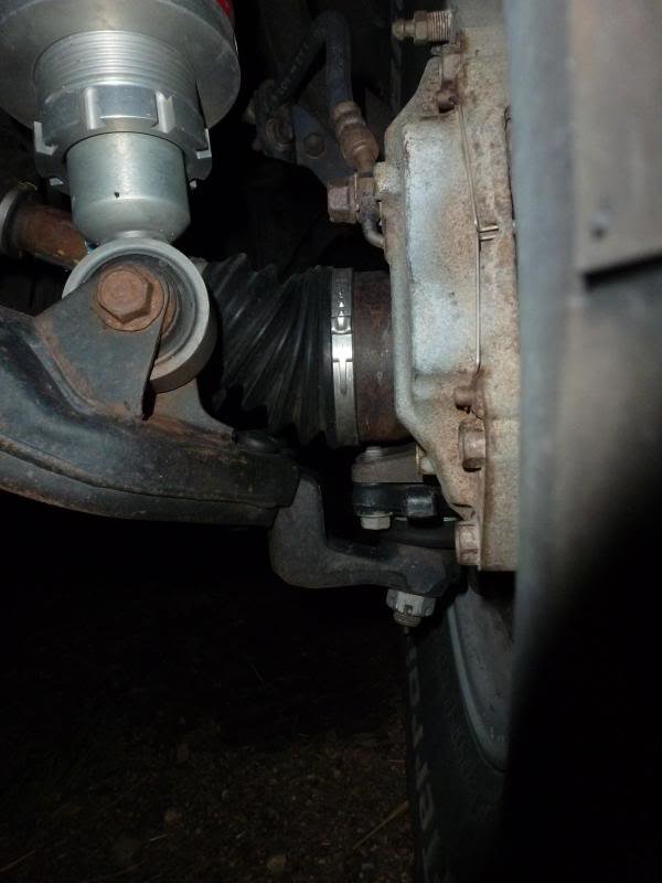

    Yes sir, I've got Light Racing UCAs. They're great for what I do with the truck and I have no complaints. Here are a couple pics of the UCAs at full droop. It looks to me that the UCAs have plenty of Range of Motion left in them... lots more than the axle anyway.
