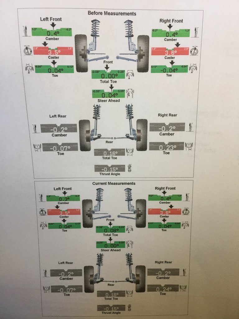

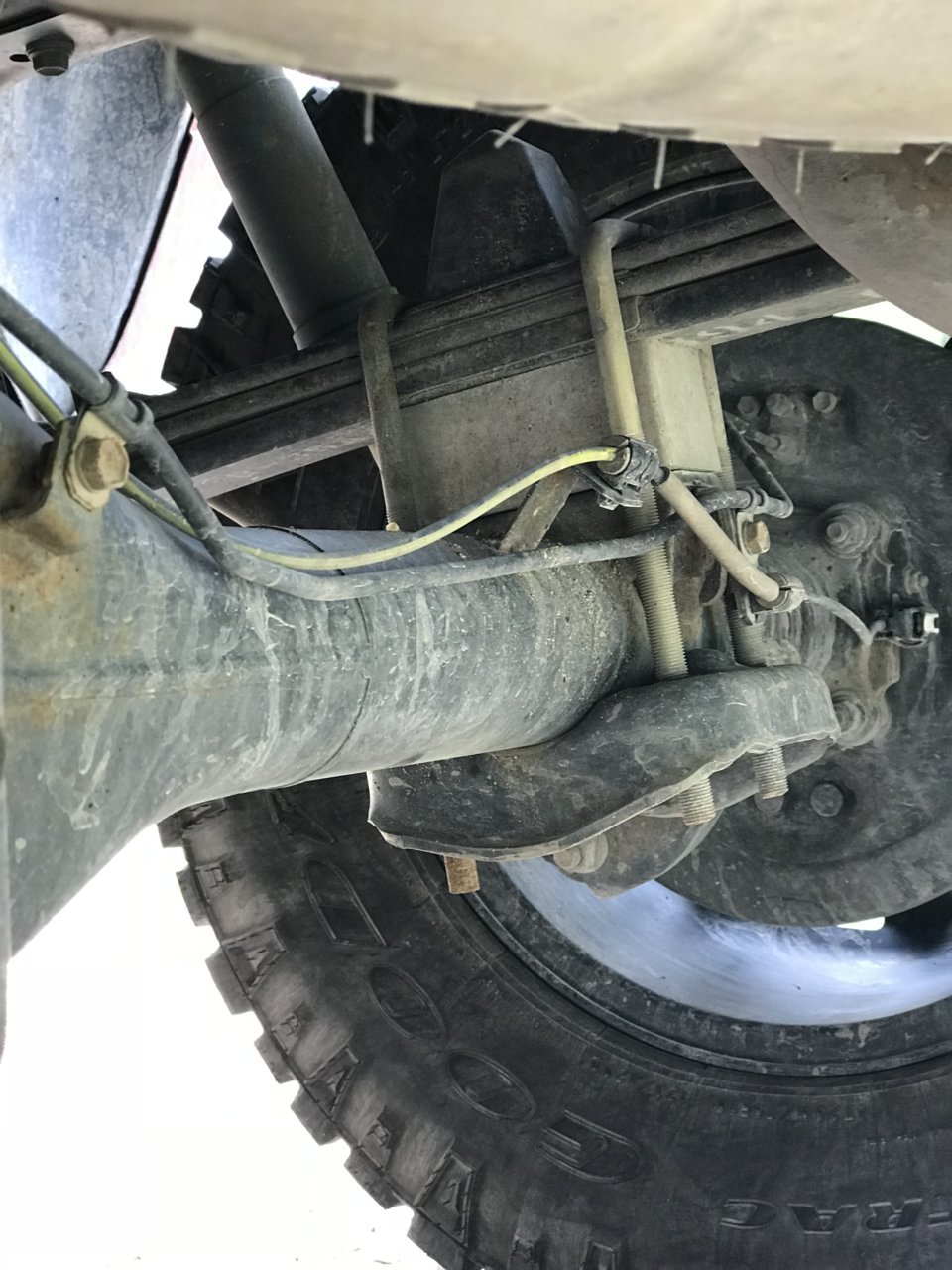

    I was wondering if anybody could help me understand the issue I am having with the rear toe and -.15 thrust angle. Also any other information is helpful. Here is my spec sheet. I have a 3 in lift and aftermarket ucas.

    The rear is not adjustable.

    2016 TRD OFFROAD DCSB MGM
    It can be adjusted.

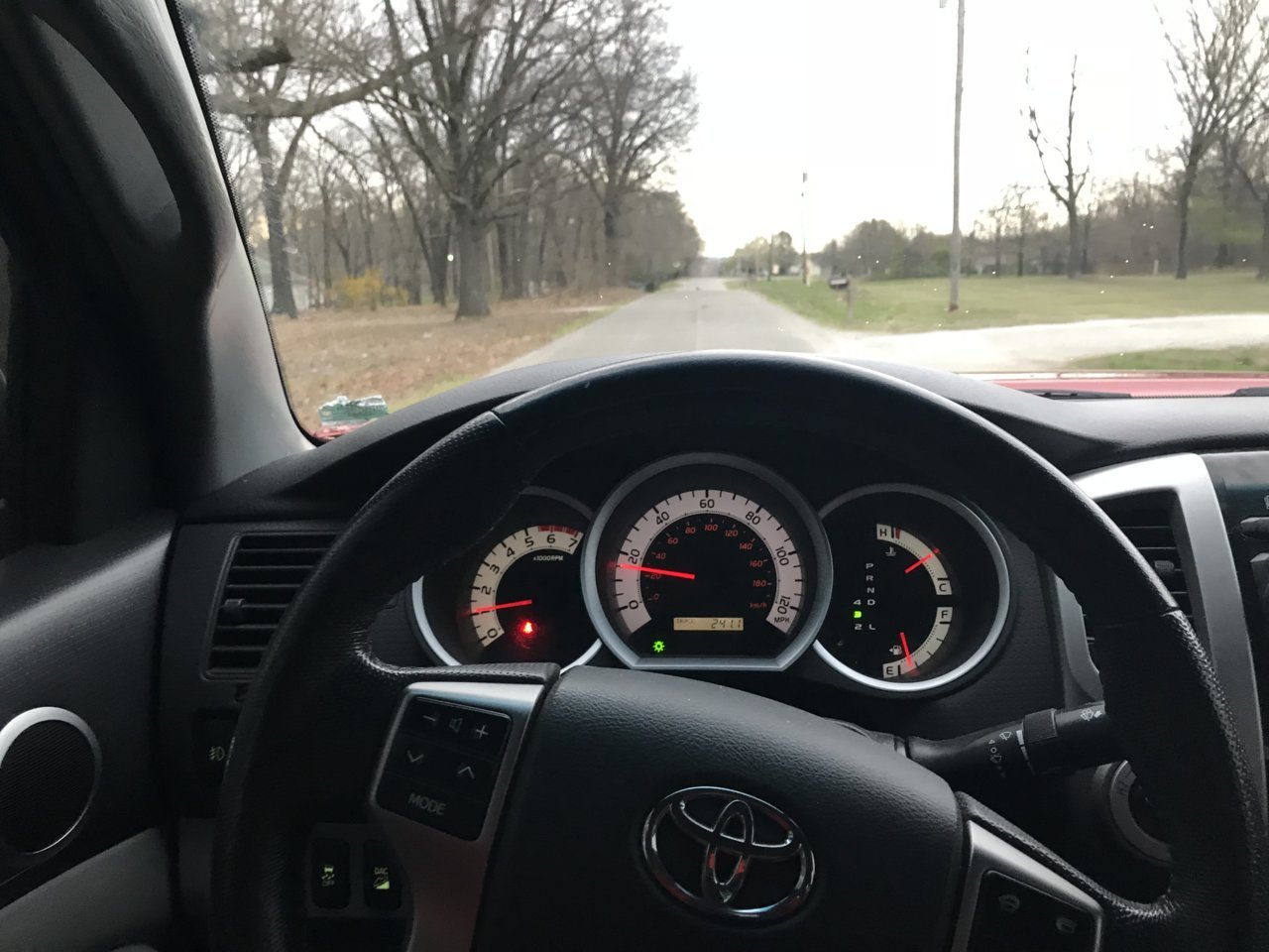

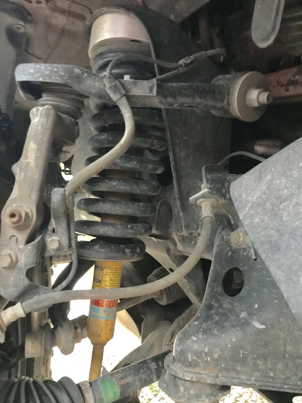

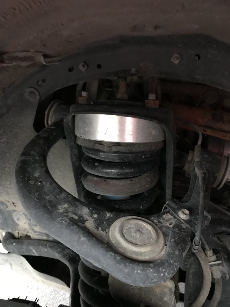

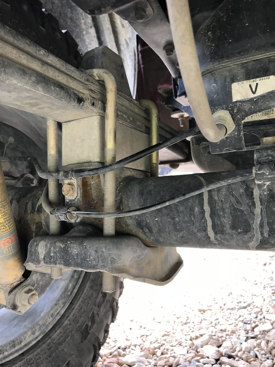

    I recently acquired my dream truck. A 2012 Toyota Tacoma TRD OFF-ROAD. The problem? I bought it used and the knuckle heads who had it before me did some "less than stellar" modifications.
    The 16'' wheels are wrapped with some (absolutely stellar, and darn near new) 265/75/R16 GOODYEAR WRANGLER Duratracs. The problem? She's got a case of the "pigeon toes" due to a lift/leveling kit which was applied by the previous owner. ALL I want (well, maybe not ALL I want) is to save my GOODYEAR meats from wearing inappropriately due to a case of pigeon toe.
    NOW, I am aware that lifting the truck (especially with a cheap leveling kit) will change the alignment of the front end. I understand there are "limits" as to just how "perfect" you can get the alignment with stock UCA's (as I have.)
    But I was told today by "the best alignment man in town" that he "will not touch" my truck, because he feels he would not be able to produce satisfactory results.
    All I want......is for my steering wheel to be straight, and a little bit of confidence knowing my front tires won't wear like and Arkansas citizen's sneakers. (No offense, go pigs.)
    It should be noted, at this time my truck does not pinch, pull, itch, swing, vibrate or veer. It's just a tilted steering wheel.....and a case of expected pigeon toe. SO IF YOU WERE ME, what would you do? :confused::confused::confused: Can this be fixed?

    HER
    The Problem
    The reason (told from the rear, at least.)
    Hands off the wheel, driving straight on flat surface.
    *front shock/struts are original....and equipped with a similar billet spacer (on the top of the coilover, of course)

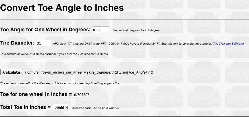

    If that's 1.3 degrees of toe in per side, that's an insane amount of toe in. About 1.4 INCHES of total toe in.

    OMG I'm an idiot. It's .13

    OK, much better. that works out to a hair over 1/8" of toe in.

    Ditch the terrible spacer lift up front and the block from the rear. You'll clear those 265/75 Duratracs just fine at stock height and will be able to get the alignment to spec.

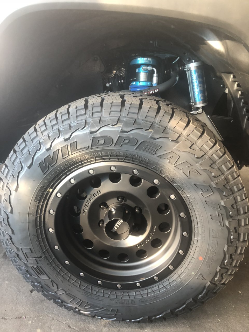

    I’m going to an alignment shop Tomorrow sooo explain to me like I’m a 3 year old? What should I ask them to do? I have 285/70/R17 w/ Camburg UCA and king shock:
    PS does it make a difference if I have a sso slim bumper with a winch?:
