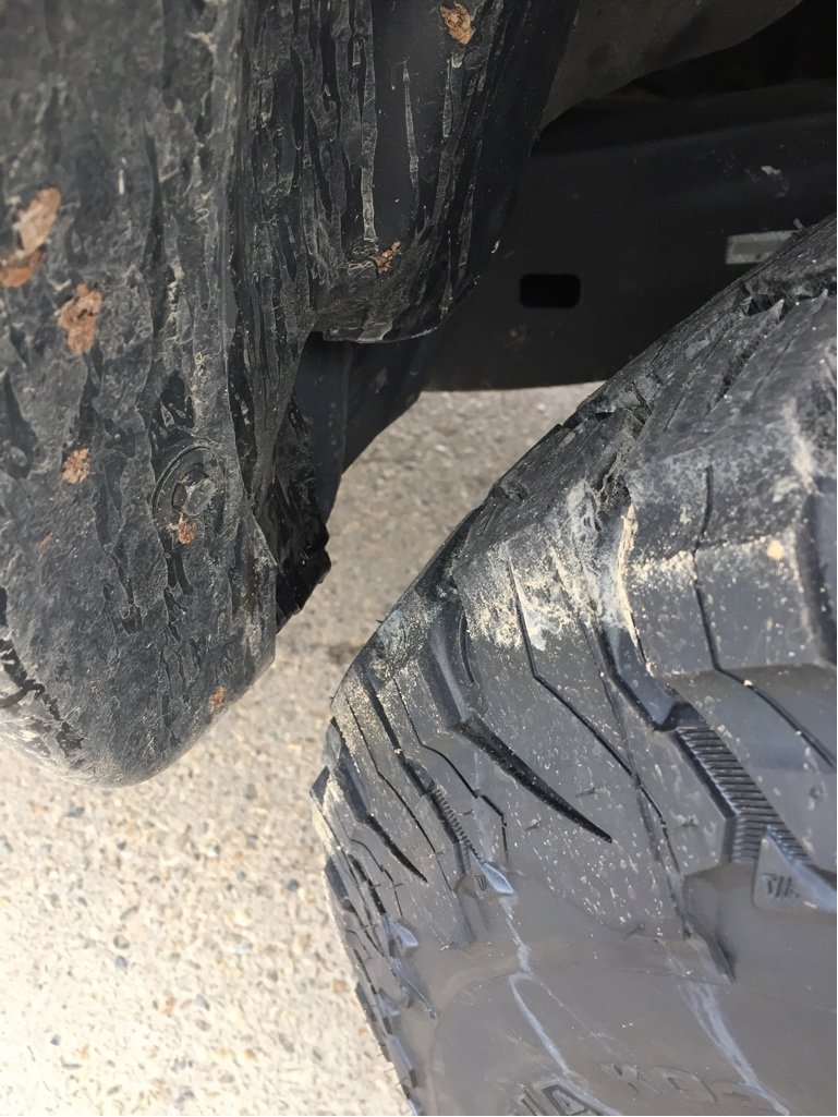

    Took my truck back to the alignment shop and told them to up my caster. He said they were able to up the caster without having to adjust my SPC UCA, they adjusted using the LCA or somewhere on the bottom part of the suspension. He said it was best because if they adjusted the SPC UCA I would have to go negative to bring it away from the fender pinch weld, negative caster was not recommended. Would this work without having to adjust the SPC UCA? I guess what I'm asking is would I have been able to get more caster adjustment, clearance from the pinch weld/fender, if they would of adjusted the SPC UCA?
    As of now it doesn't rub at all under normal driving and reverse.
    At a slight turn, the edge of the tires are about an inch from the pinch weld/fender.

    I think that's perfect. That's what I did as well although I have stock ucas. If you dial in caster at the uca it brings the wheel back and almost necessitates the cmc. When they use the lca for caster there is less rubbing. I think it sounds like you got it pretty darn good.

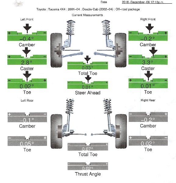

    Keeping the thread going.
    Lift: 2.5 with TC UCA

    Got to ask ya, how does it drive with those numbers?

    Drives pretty well. Seams to pull a tiny bit to the right. Was not confident in the tech that was working on it so I'll be going back in to another shop to try and bring the toe in.
