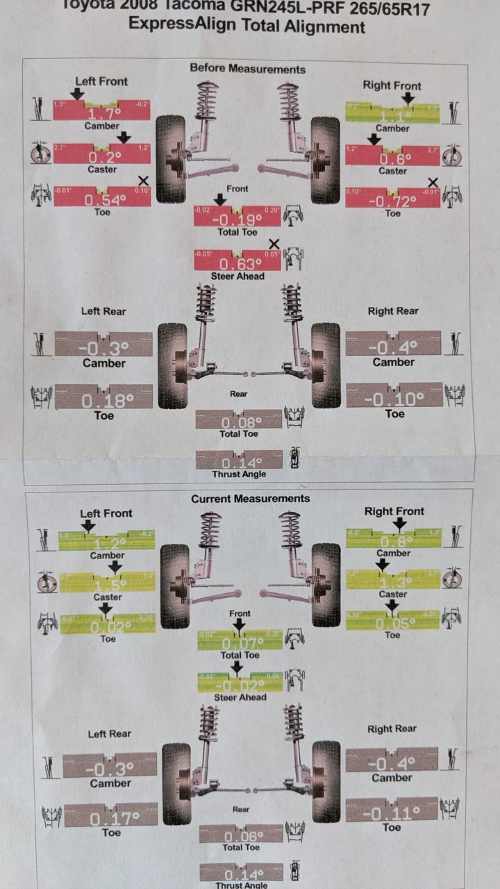

  5. Jun 16, 2019 at 5:59 AM
    #265
    birry
    birry Well-Known Member
    Oct 5, 2012
    #88370
    625
    Oklahoma City, OK
    2008 4x4 DCSB
    OME 885, Bilstein 5100's, Wheeler's (single) AAL
    Here is my recent alignment after installing 885's, 5100's, and 265/70r17's. Currently running stock UCA's.
    The current camber is definitely visible. I'm also experiencing a pretty big dead zone in the steering when centered, and it kinda wanders a bit. Not a fan of the current numbers at all.
    Am I needing a better tech to fix this, or am I in the aftermarket UCA territory? Maybe both...? Given the lift/tire specs above, would I be shooting for these numbers?
    Camber = 0.0
    Caster = 2.1-2.4
    Toe = 0
    Help is appreciated!!!
  6. Jun 16, 2019 at 12:05 PM
    #266
    gotoman1969
    gotoman1969 Well-Known Member
    May 30, 2018
    #254966
    6,898
    Steve
    San Antonio, TX United States
    2015 Silver Tacoma PreRunner
    3" ToyTec coilovers, JBA UCA's, Bilstein 5100's
    Have a 2015 prerunner. 3” toytec, jba hi caster uca’s running 285/70/17 on 17x8.5 -10 offset. Running 4* caster, no rubbing issue front or rear(no mud flaps of course) didn’t need to do the frame chop or trim anything.

    It is Positive caster you want for better drivability

    With your steering wheel centered, and the wheels on the ground, if you turn the steering wheel back and forth do you have free play in the steering that does not move the tires? The max. play measured at the edge of the steering wheel is supposed to be no more than 30mm.

    I already had another alignment shop look at it, and I told them what numbers to shoot for. Its in a much better place right now than it was previously. That said, I think new UCA's would definitely help. Its still not perfect.

    I run 2.8 caster on my taco.. freaking awesome
  12. Jul 19, 2019 at 10:26 AM
    #272
    ToyotaRoamer86
    ToyotaRoamer86 Well-Known Member
    Jun 20, 2017
    #221993
    520
    Brandon
    Frisco, CO
    2007 Tacoma TRD Sport
    You need at least 2.3 degrees for a factory setting. SPC would get you in for 2.5-3.0 caster! Would drive amazing

    I think mine are around 1.5, and you can definitely tell. I'm saving up for Camburg UCAs, and will hopefully get better numbers after that. I've heard some people run 4.0+ somehow.

    I run 4* on my 2015. Drives great!!
    So what's the goal?
    Camber = 0
    Toe = 0
    Caster = high as possible

    Personally I like camber = 0 toe = 0 ( but a slight bit toe in is ok.) caster = 3-4( I prefer 4, but that’s just me)

    There is no way to get more than 3.0 out of a CAMBURG, ICON, TOTAL CHAOS..

    That's fine. I'd love to get over 2.0 at this point. What are people using to get 4.0???

    I have jba’s next n my truck. They have 2* of caster built in to them.
