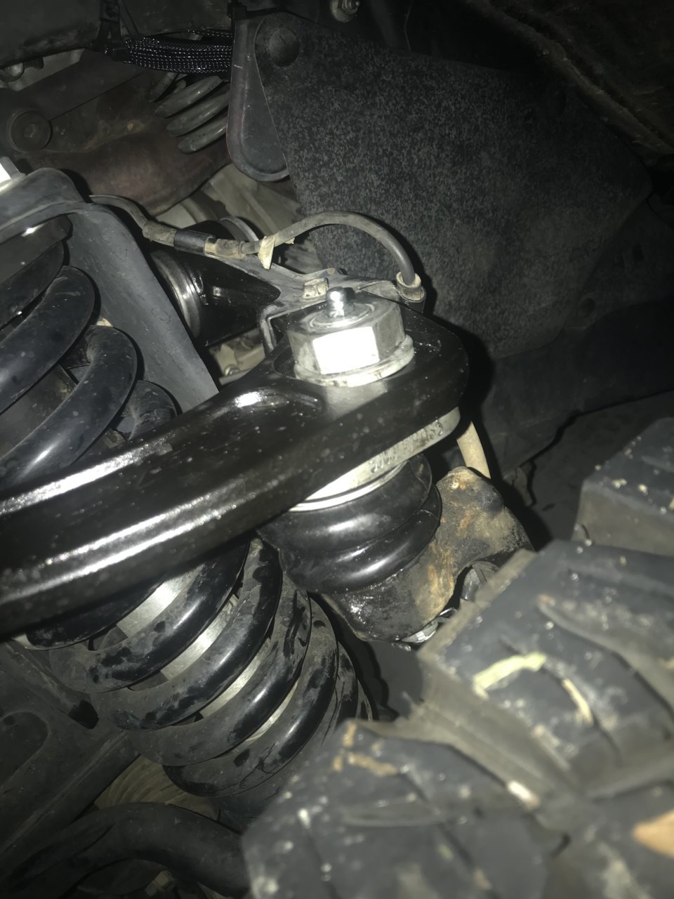

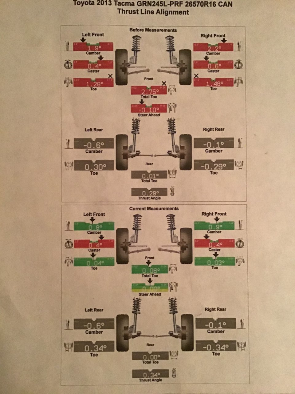

    Filters: K&N Air Filter Engine, Cabin Air Filters Uni Filter Mod 4.88 re-gear front and rear Yukon Gears Suspension: Rago Fabrication Leafpack Hangers Ironman 4x4 FOAM CELL PRO SUSPENSION LIFT KIT FOR TOYOTA TACOMA 2005-2023 Stage 2 Upper Control arms 2.5" Heavy Load Front springs and shocks Heavy load leaf pack Wheels: 17" RRW RR5-S x5 BFG K03 285/70/17 Brakes: Power Stop KC 137-36 Z36 Front Calipers/Rotors/Pads Power Stop KOE15389DK Rear Drum Brakes Electrical System and Accessories: Genesis Dual battery Kit: 201-TT2DBK x2 Full Throttle Group 34 Batteries: FT825-34 SPOD w/Bluetooth w/Custom OTRATTW Rocker Switch Panel Cali Raised Front Pillar Lights Cali Raised 42" Light Bar Auxbeam Rear Ditch Lights Procomp RGB Rock Lights (Bluetooth Enabled) CSI 52qt Fridge ~hardwired w/Anderson Plug Connections to main battery. CSI Fridge Sliding Tray 15 amp circuit breaker on CSI Smittybuilt Air compressor 2781 (Anderson Plug connector Mod) 50 amp circuit breaker w/Anderson Plug Connector Prinsu Roof Rack Plano case with all recovery gear CVT RTT Mt. Shasta w/Awning 23Zero 180* Awning Rago Fabrication bed bars Interior Mods: Installed quad USB charging ports in Dash Exterior Mods: ATH High Clearance Rear Bumper w/Swing Out Tire Carrier Installed Separate Dual Waterproof USB Charging Ports in Truck Bed Rago Fabrication Bed Stiffeners Communications: Midland MXT275 GMRS Radio Midland FRS handhelds BaoFeng UV5R HAM Radio Recovery Gear: Maxtrax (Red) Bunker Industry Mini Traction Boards (Great for Leveling, Red) Bubba Rope 20,000lbs Bubba Rope Soft shackles
    What does the TW masses think?
    2013 Double cab 4x4
    285/70/17’s
    Bilstein 5100s
    OME 885s
    SPC UCAs. ~ installed on D setting. Alignment tech ended up changing the setting to G. So he says. Looks as such underneath.
    Of course it rubs. I trimmed the fenders and the pinch weld. CMC sometime soon but the concern was the fenders. Shouldn’t hit the cab mount until I stuff it on the trails.

    Caster is horrible. He didn’t even get it to factory specs. With the uca’s he should have been able to do that at least if not better like 3.5. With my jba’s got 4* with no problem.
    birry and Muddinfun like this.
  12. Sep 14, 2019 at 7:12 PM
    #292
    Muddinfun
    Muddinfun Well-Known Member
    Apr 17, 2017
    #216500
    7,489
    Agreed, caster is horrible. Not surprising that the tires rub. YOUR ALIGNMENT GUY IS A MORON.

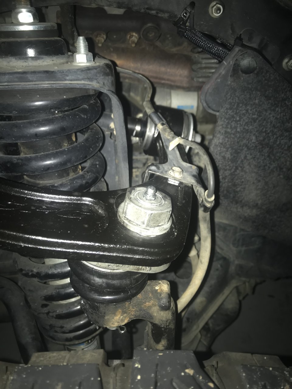

    Pics of balljoint?

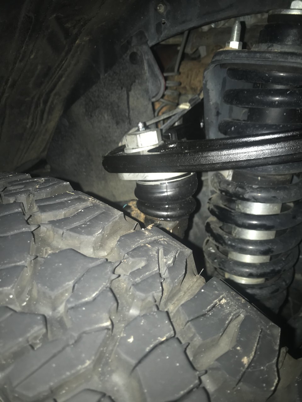

    DFA4E409-B208-4ED8-9FDD-99F103BA92EB.jpg 8A4313CC-38F8-4BAE-91F8-140539786EBD.jpg ABA2DF4C-17ED-4557-BF76-5B9F114DCF94.jpg
    Was thinking same. Even after I sat there to explain it. I have free alignments here and wanted to give it a go after I installed them. For a chance they’d save me $$. But I have an appointment for Wednesday at an off road shop in Ormond beach. Pics as good as I can get for now. Raining hard.

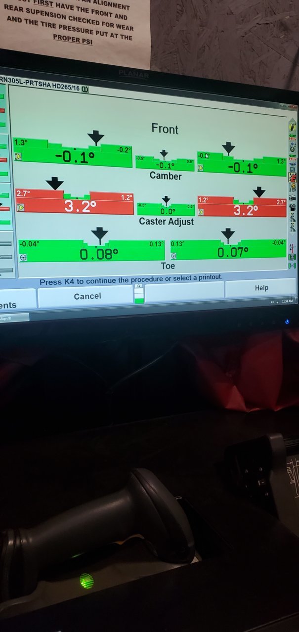

    I think I’m going to take it to the same “company” different location by work. I think I can explain it to them at this location and get better results. Or hell I could probably just set the UCA in the position I want and let them dial it in from there.
  18. Sep 14, 2019 at 7:54 PM
    #298
    Muddinfun
    Apr 17, 2017
    #216500
    7,489
    Hopefully they have someone that actually understands the principles of alignment, and not just someone that does what the computer tells them to do.

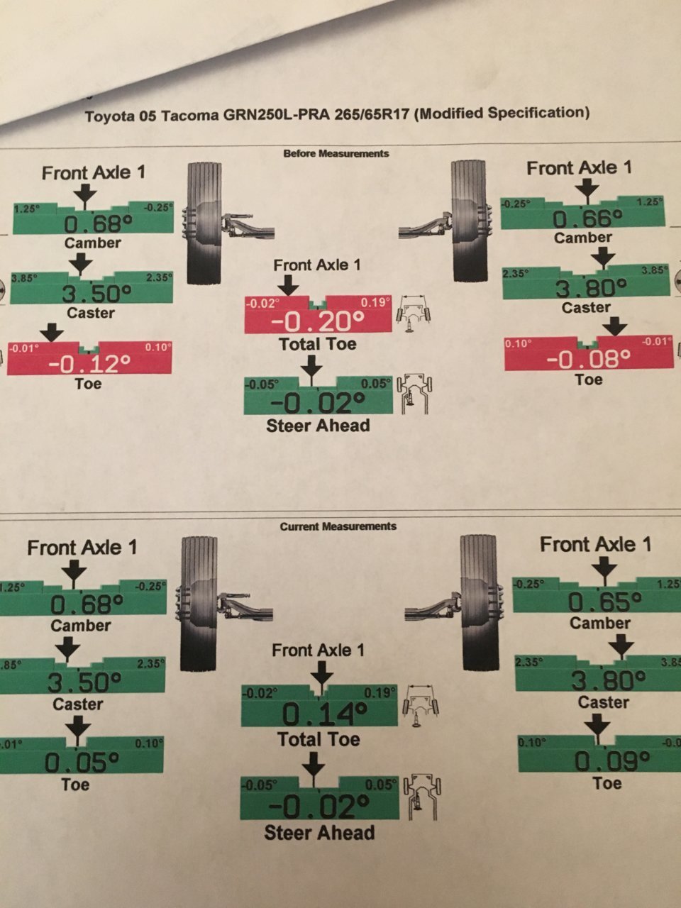

    Big body sittin on chrome
    Ok alignment guys, just had mine done after new lift and new tires. 2015 DCLB limited, 3" Toytec lift with AAL, 265/70r18 wildpeaks.
    Here's a pic of the results, let me know what you think:
