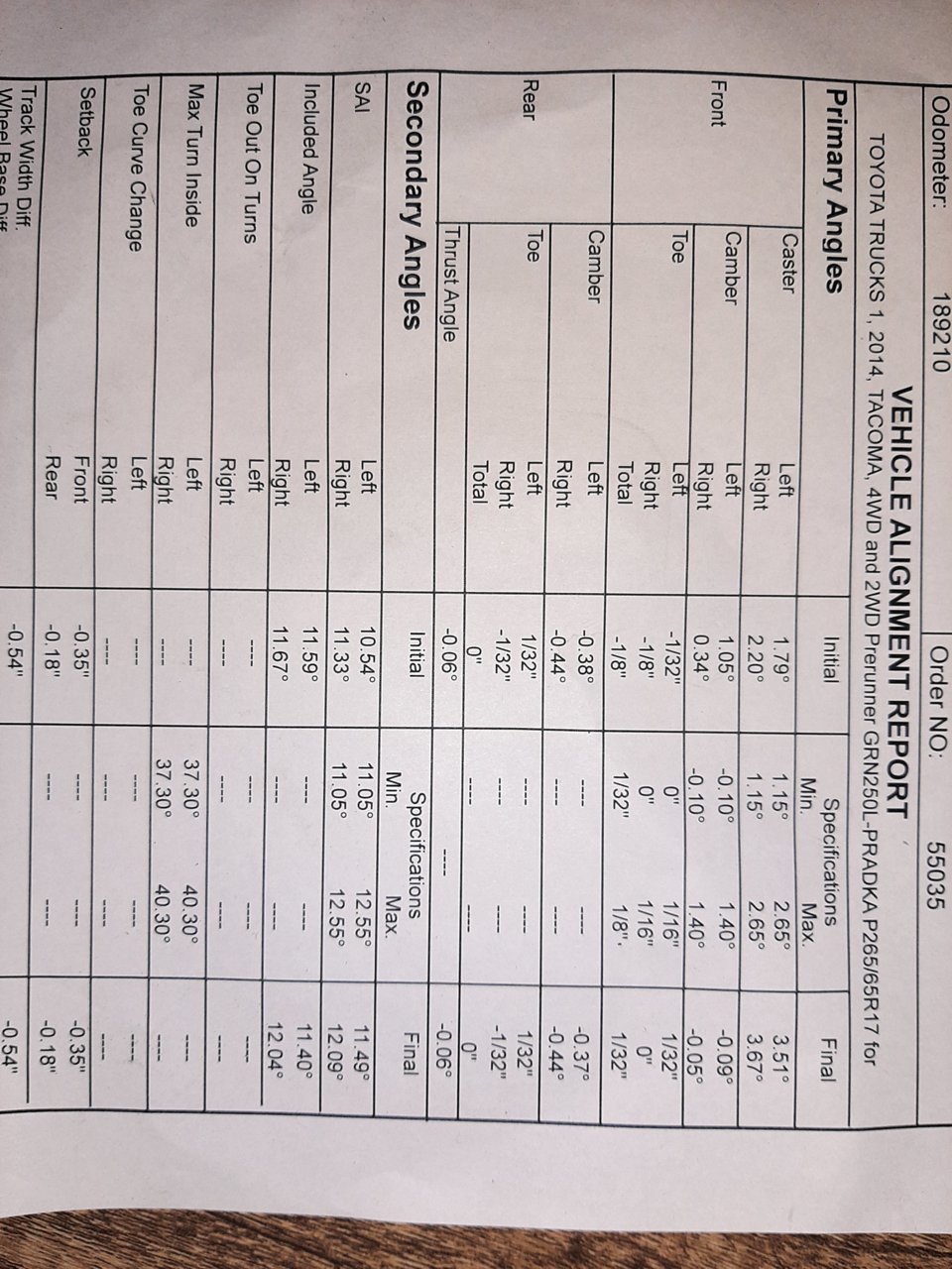

    Here is mine with spcs
    CBrob likes this.

    I'm running 33s and it tracks great. Steering is tighter and drives perfect.
    CBrob[QUOTED] likes this.

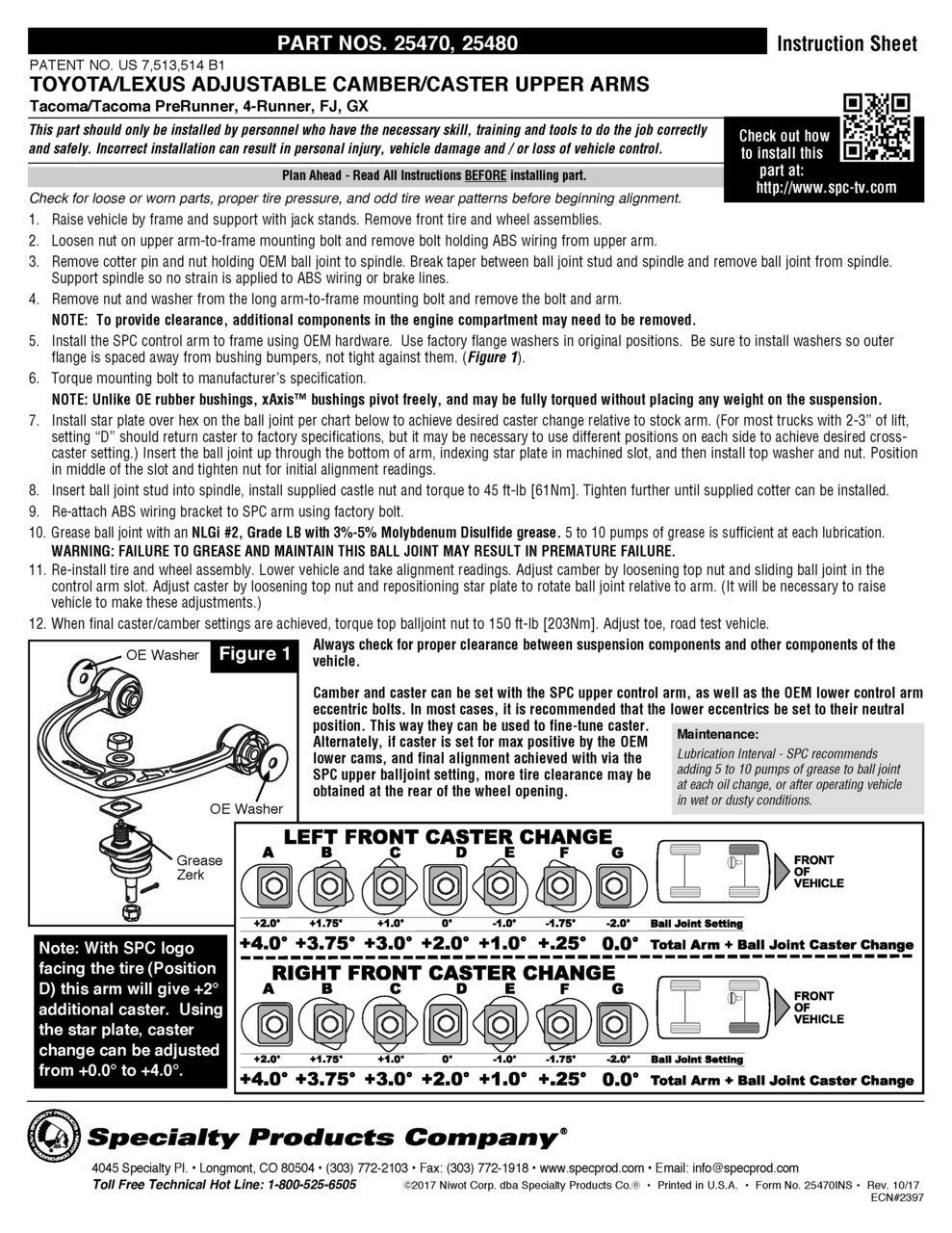

    The SPC instructions say that setting (f) will give and additional +0.25deg of caster, while setting (g) will give an additional +0deg of caster. The OP is basically telling you to not use the benefit of having the SPC UCAs. With the OPs "recommended" settings, the tire will essentially be in the same position as the stock UCAs. People should be starting off on the (d) setting which gives an additional +2deg of caster. This will push the tire toward the front and away from the cab mount. When done with 33s you won't have to do a CMC for clearance. The misinformation should be fixed in the OP.

  17. Mar 14, 2022 at 8:10 PM
    #317
    toku58
    toku58 [OP] Well-Known Member
    Oct 10, 2008
    #9882
    2,534
    On a Rock in the middle of the Pacific
    Mall Crawler!
    21' TRD OffRoad 2" 887 OME on Bilstein 5100's. 285/70R17 General Grabbers G3 17x8.5" Icon TRD wheels (Gun metal gray) 4.75" BS
    I am the OP.
    You want to correct the Camber.
    And NO start at "G" and if you need Caster then use the SPC's to add Caster.

    Setting "F" (+.25 Caster) with your LCA moved fully forward, and use the SPC's sliding bolt to get the Camber and you'll be "Golden"!

    yup agreed. Really "D" I think is not the best default (which is why I set it there originally) per SPC for what most are trying to accomplish on this forum. I was originally scared of moving it in case it threw off an alignment guy in some way...but seems like I got a good one now so I'm more inclined to get it just right.
