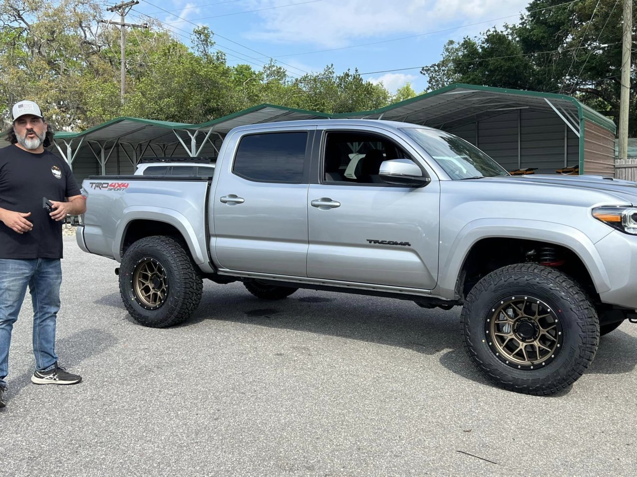

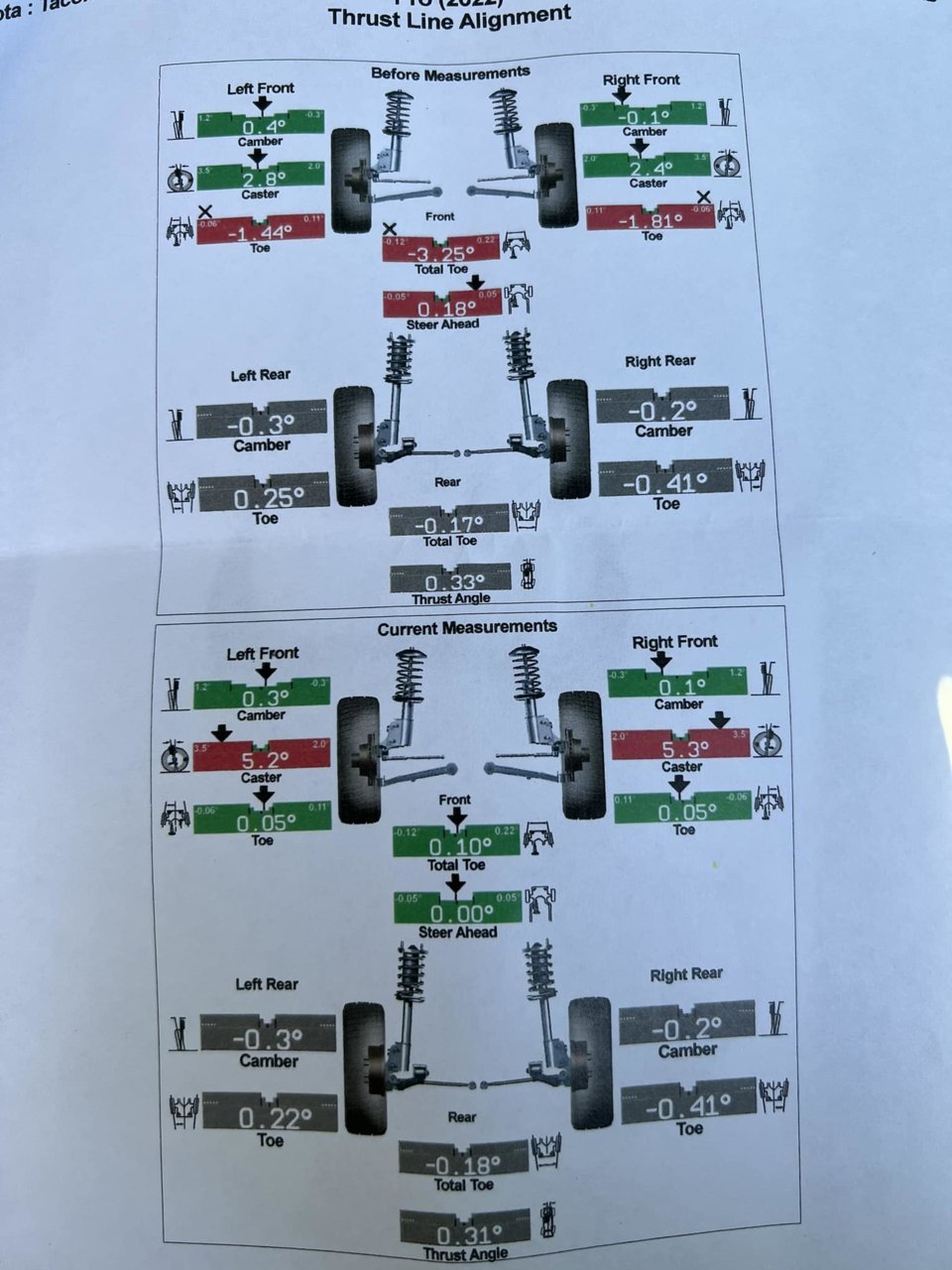

    read all the pages, learned alot. thank you.
    i got an eibach stage 1 on 2nd notch and icon 3leaf 1.5 at the back that leveled the truck with JBA UCA.
    i took it for alignment after the lift and i am now rubbing on the lower control arm on full lock forward (u turns), i dont rub on full lock backwards- on stock wheels and tires, TRD Sport 2023 17x7 +30mm offset.
    the shop put my caster at 5.3, took the truck there 3x and they still cant get it right.
    So now am gonna get 285/70/17 with 17x9 -12offset to bring the tire away from the LCA. Gonna have it aligned after the new tires/wheels are on and i'll shoot for 4.5 caster as suggested by JBA spec sheet.
    any feedback to getting a -negative offset wheel to prevent the tire from rubbing the LCA?

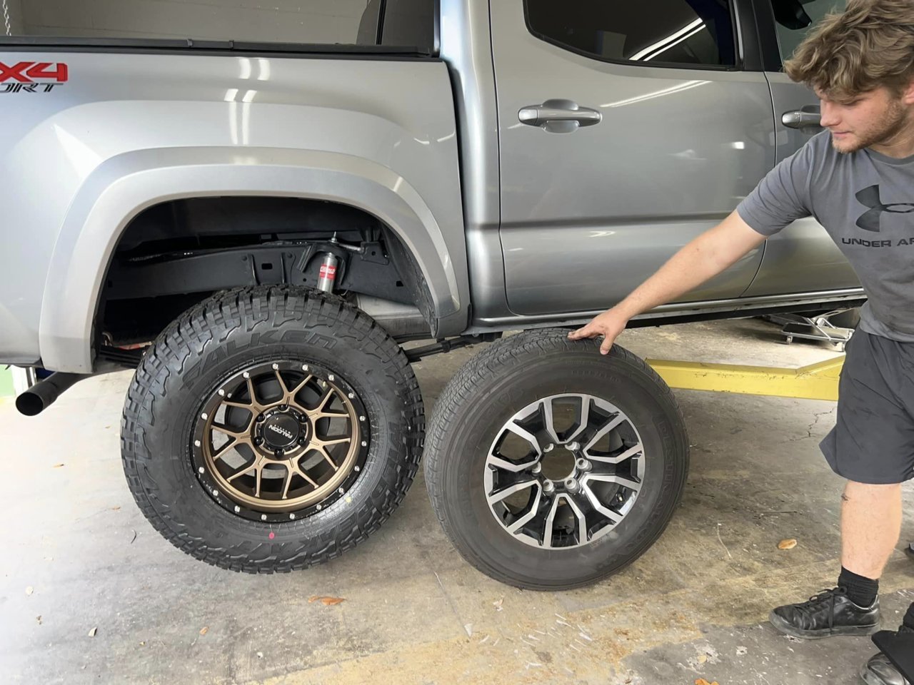

    update to my #324 post.
    got new wheels falcon offroad 17inch with -12 offset and 285/70/17 wild peak tires, got new alignment too, caster is still at 5degrees, toe is .03 and camber at .04, no more rubbing, no rubbing on LCA which was my problem on full lock. no rub full lock forward and backward. the closest the tire gets to the palstic is half an inch and half an inch on the cab mount. will probably rub on full articulation so am doing viper cut and cmc since i'm going to MOAB.
    thanks to roamoverland in tampa, fl.
