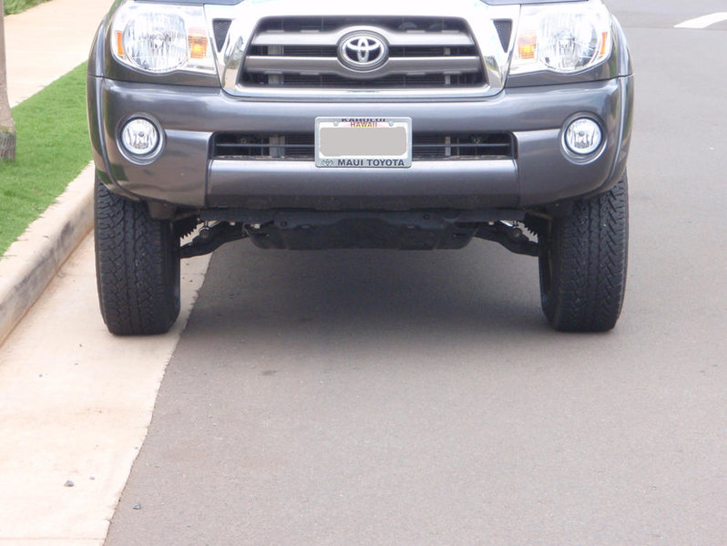

    I have the Toytec Ultimate kite set at 3". Stock UCA's. I'm running 265 75 r16 on stock rims. I have been in twice for alignment and it still sits wrong!
    Here are the specs for the latest alignment:
    Front Left Front Right
    0.4 Camber 0.3
    -0.3 Caster -0.3
    -0.2 Toe .02
    11.9 SAI 12.5
    Cross Camber 0.1
    Cross Caster 0.0
    Total Toe 0.00
    Yet my truck looks like this in the picture I've attached.
    Can someone please help me with some suggested settings? I'm getting frustrated going into Sears every week.

    Your caster is way off. Don't take it to Sears. Try a different shop.

    Where should my caster be with my setup? Has anyone adjused this themselves with any success?
