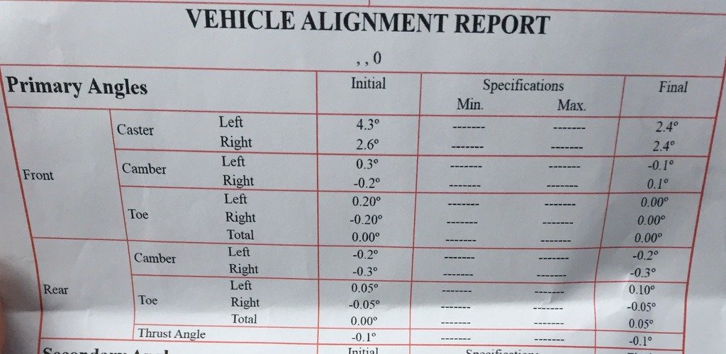

    I have a 6" lift w/35's with original UCA's. Here's my alignment today. It's all green but do you see the need to upgrade an UCA? This was done at a stealership but had no issues and did it quickly..

    PoweredBySoy
    PoweredBySoy Well-Known Member
    Nov 10, 2014
    #142066
    1,846
    Jesse
    Minnesota
    2013 DCSB SR5
