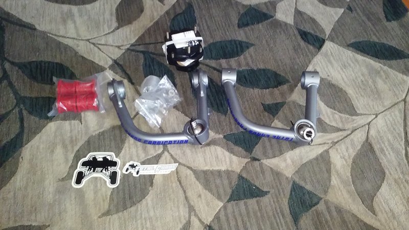

    0711161536.jpg Just got my 3in spacer lift, diff drop and TC uca's in after I get it all installed I am headed straight to the alignment shop

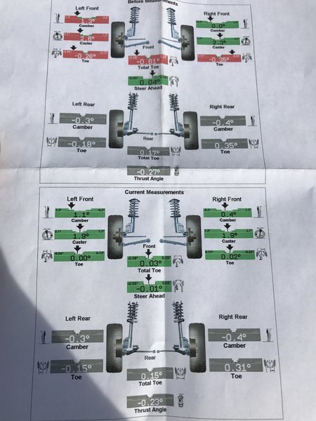

    I got my truck lifted today. 5100s at .85 with eibachs so I got about 2.5 up front. Had light racing UCAs installed as well. Went and got an alignment and these are the numbers guy gave me
    Caster left 3.8/ right 4.0
    Camber left 0.9/ right 1.0
    Toe left .05/ right 0.0
    Does this look okay? The high caster (from what I understand) has the wheel sitting further back in the wheel well. I'm not hitting mud flaps and I'm not tracking left or right since they are almost equal. Do I leave it at these numbers?
    And what about camber and toe?
    I'm thinking the tech had no idea how to adjust my UCAs and just tried to get me outta there. Any advice would be awesome.

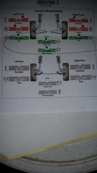

    How much does caster affect wheel position? I switched from an OME kit to Icon with uppers. Now I get rubbing on rear plastic and cab mount. No change in tire size.
    They put my caster at 1.4 and 1.8. From this thread I see that 2.4 is more desired. How much wil that actually move my tire forward? If it's not much I don't want to go pay another 70 bucks for nothing.

    #158945
    3,513
    If there is more positive caster available it will bring the tire towards the front of the vehicle. What is the camber at currently? Which uppers do you have?

    Imposter

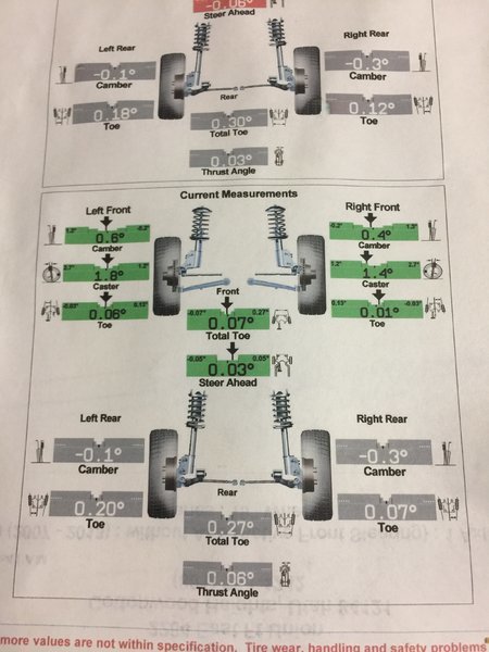

    I have the Icon uppers. Here is the alignment sheet.

    3,513
    Icon tubular? They might have to fudge camber to get your caster higher.

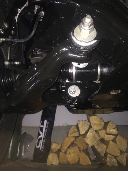

    That's usually the case. If you could post pictures of your lower control arm alignment tabs we could know for sure. Driver or passenger side.

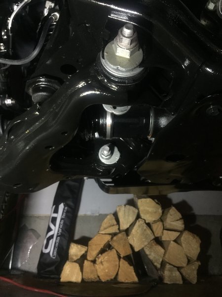

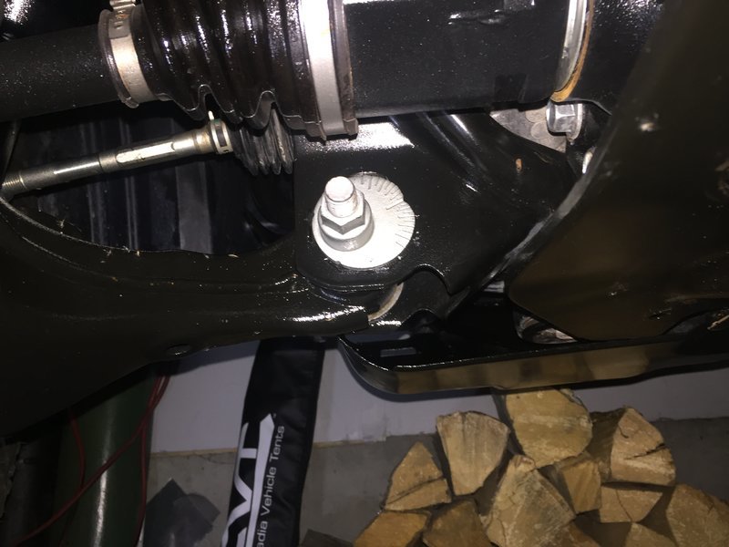

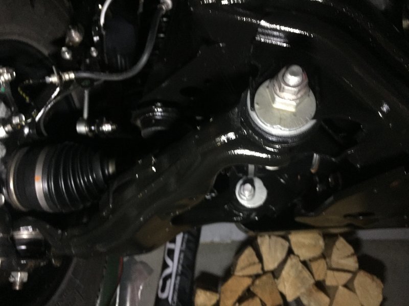

    Here are some pics. I fluid filmed it a couple days ago and my phone will not focus on it. I'm guessing it's because it's so glossy. I took about 20 and these were the best ones. This is the driver side looking forward at the two bolts.

    3,513
    It looks like they can't take out anymore camber, but they can add caster which will likely bring your camber slightly higher.
