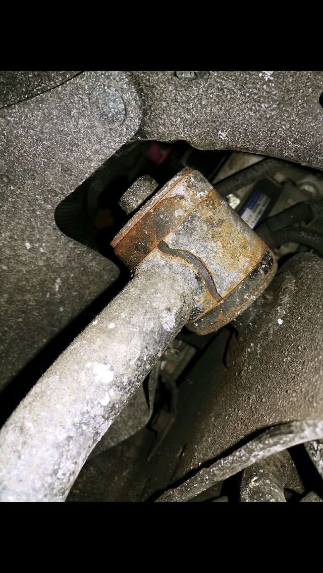

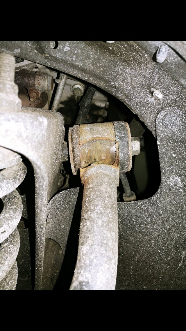

    I have Light Racing UCA’s on my 2012 OR model. One is cracked and the other is broken...
    Looking for “affordable “ replacements. They have on my truck about five years, had NO idea they were lost.

    Those are definitely NOT total chaos arms.
    Chaos arms have this gusset to prevent exactly that from happening.

    I guess they weren’t Total Chaos, I know I got them from Wheelers Off-road when I ordered the lift.
    They were around $450-500.

    Definintely not TC arms in that pic. TC would be gusseted, and not only that the bushings and sleeves on the TC are much beefier than in the pic

    Light Racing maybe??

    Lots of dust and custom dents, Check Build
    They look to be SPCs based on the bushings.
    If so, I would contact them directly about a warranty replacement. They had some issues with them in the past that they acknowledged.

    Show some pics of the Ball Joint and that will tell who they are.

    I got SPC Light Racing UCA's off a member here brand new in box for $250 shipped. That was a steal. If you can get a deal I highly recommend them- they've worked great for me. Total Chaos arms seem to be the best though.

    SPC just told me they are covered under warranty, even after 6 years. Waiting on Toytec to start the process.
