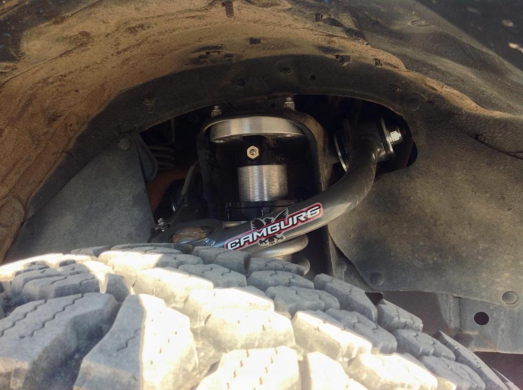

    I love my uniball ucas except there needs to be a cap for the top replacing the uniballs next weekend had them for about 6 mths imagejpg11-1_c80aad9b0ec198e21b3af49e0fc5c33a4715ed1e.jpg
