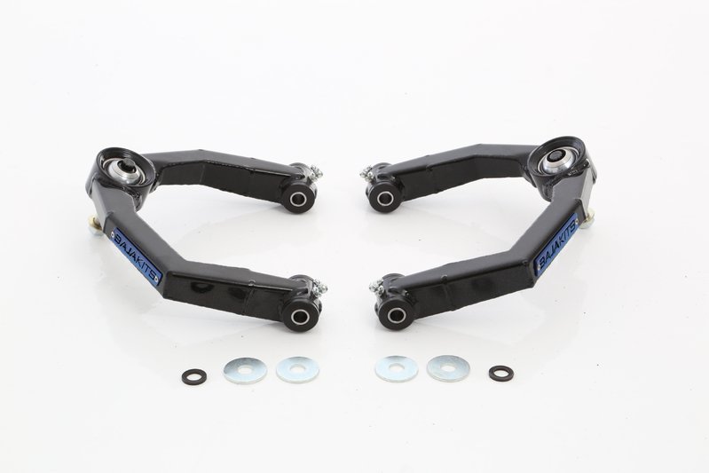

    Can I throw in our UCA into the mix?? :wave:
    3Q6A2887.jpg 3Q6A2896.jpg 3Q6A5844.jpg 20160814_103108.jpg IMG_5727.jpg Tacoma Chase Kit.jpg
    MonoJoe[OP], 90yota and Coot83 like this.
