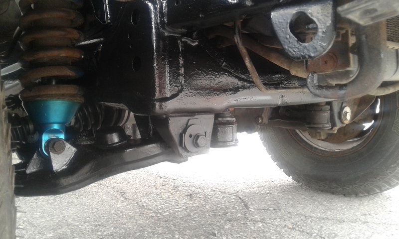

    @ devinzz Just speaking from personal experience my truck has been "aligned as it can get" and if I don't rotate my tires often this inner tread gets really cupped out. It drives straight though when the tires are good, when they are wearing down then the alignment feels off. If i keep them rotating they stay more even. I definitely don't have them turned more than 2.5 inch lift. I was changing a CV today, the boot has been ripped for over 4 years, and the lower control arm did drop down a little more after i unbolted it from the spindle. So yeah i agree you can get more travel with a new UCA. I dropped my passenger side king out to change the spherical bearing at the bottom today. Ill throw up some pics tomorrow.

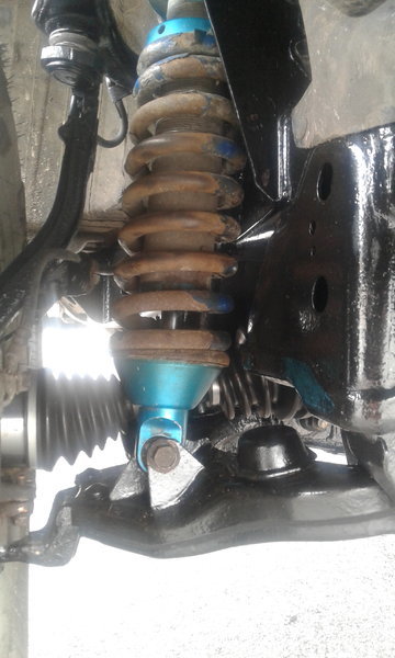

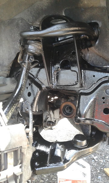

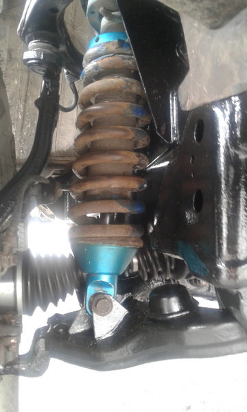

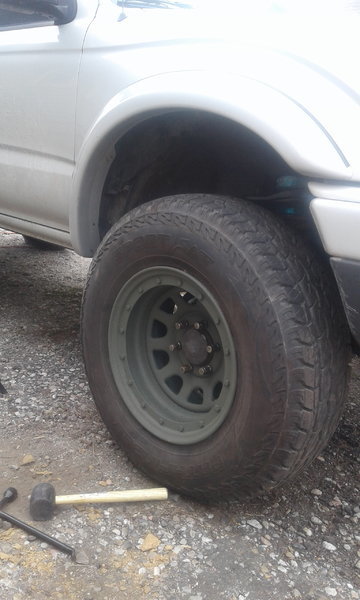

    Just passenger side work so far. Replaced the spherical bearing on the bottom of my king, put in a new CV, and wire wheeled rust off the frame then POR 15 on it. Only the passenger side so far but liking the POR 15 a lot. A tip on the King install, unbolt the lower arm from the spindle and push down on the arm to get the shock to fit in easy. It is a lot harder if you dont unbolt the lower. And repainted the steel wheels they were getting super rusted
