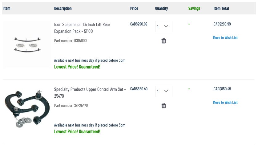

  15. Mar 12, 2021 at 10:28 PM
    TacoRocco
    TacoRocco [OP] Well-Known Member
    Feb 2, 2009
    #13213
    141
    Niagara Region, ON
    09 Tacoma TRD OffRoad
    OME 2 inch lift
  16. Mar 14, 2021 at 7:28 AM
    #16
    Hunter gatherer
    Hunter gatherer Well-Known Member
    Aug 25, 2013
    #111142
    609
    Andy
    Lillooet B.C.
    13DC4X4BaseModel
    If your sitting at 250000 KM just do the whole Icon rear leaf pack. Your original springs are probably next to useless now. I am just in the process of doing mine and my originals had one broken leaf and I'm at 130000Km.
