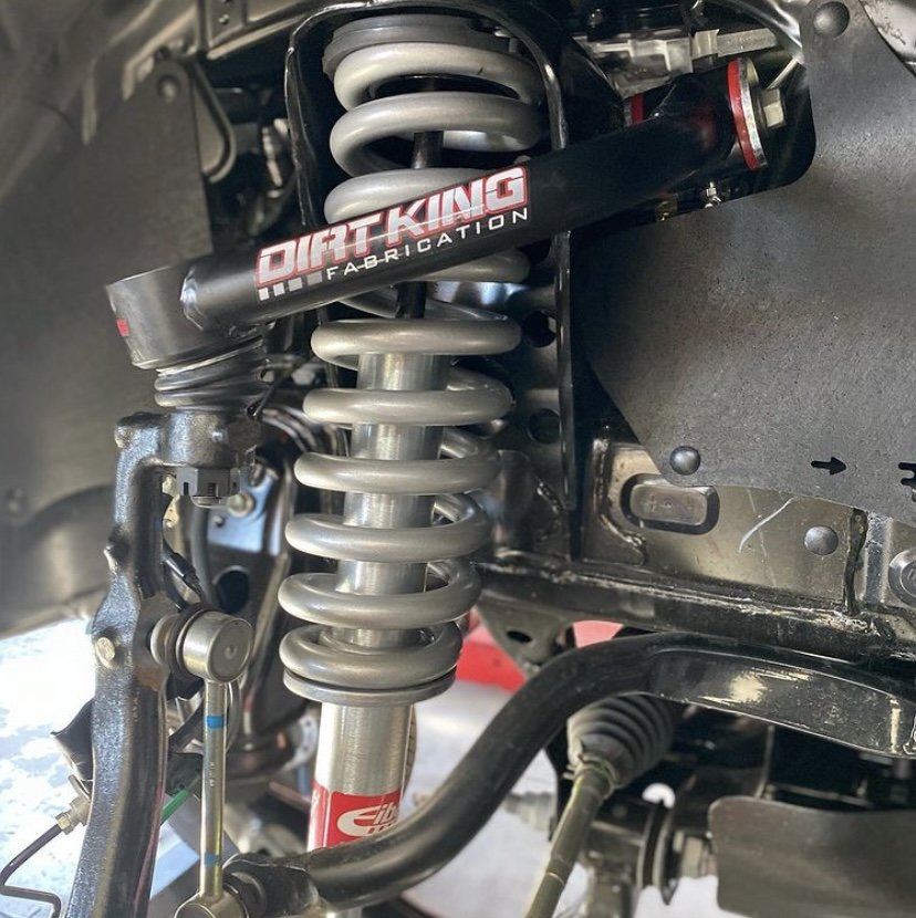

  13. Feb 9, 2023 at 4:42 AM
    FLAK-TAC
    FLAK-TAC Only banned twice…so far
    Nov 29, 2021
    #383400
    442
    SW Florida
    2022 TRD OR LB

    I run OME UCA's
