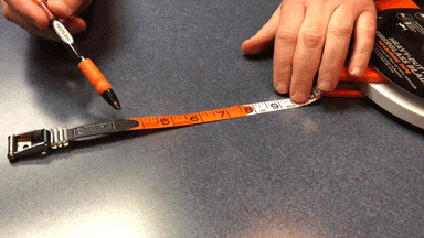

    so it's highlighted up to 8" but he's only pointing between the 4" - 8" marks
    either way I'm impressed
