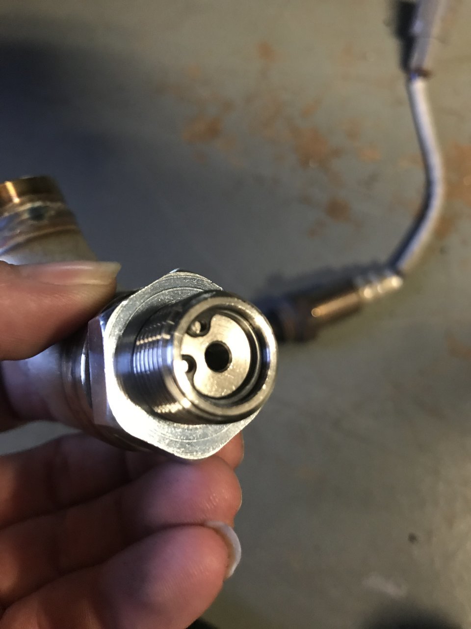

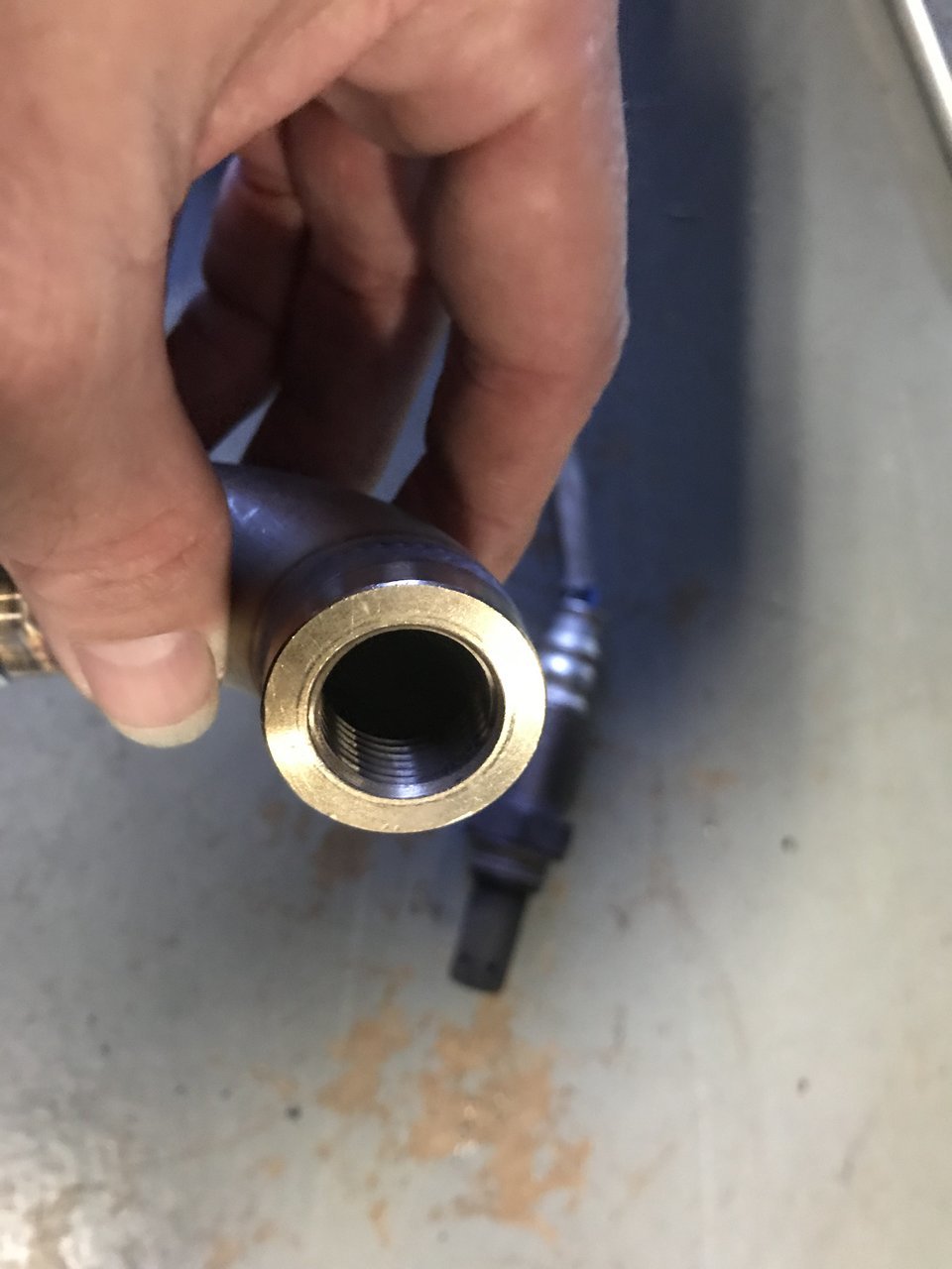

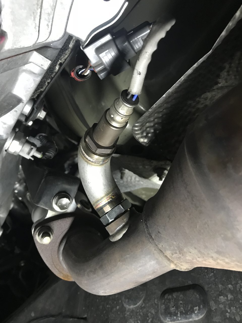

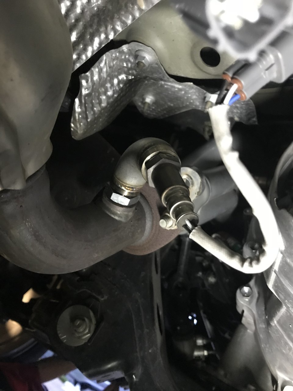

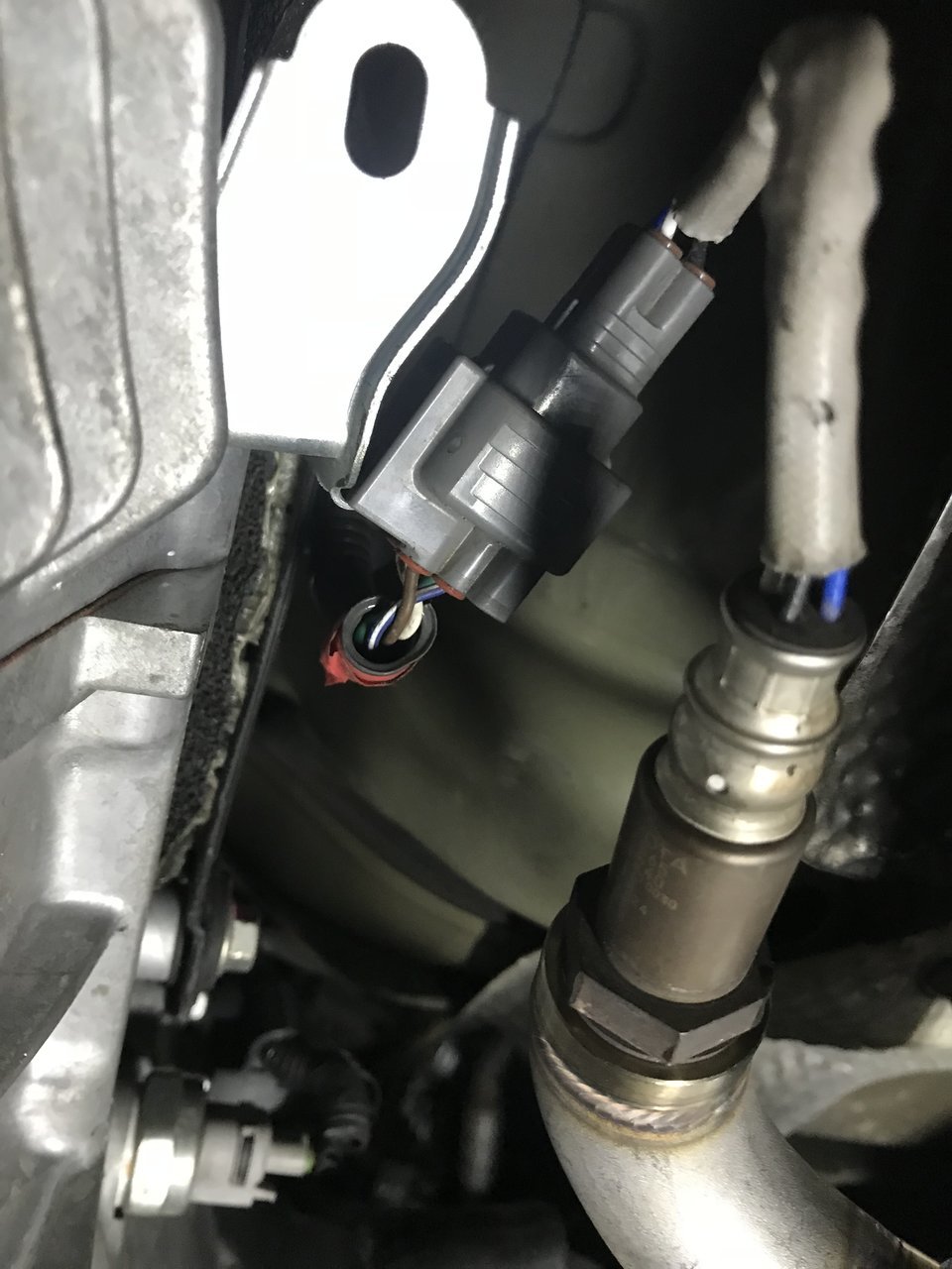

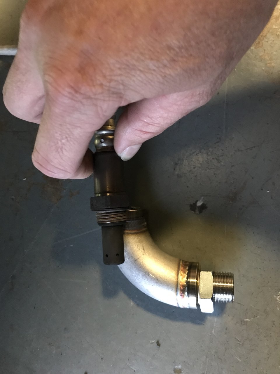

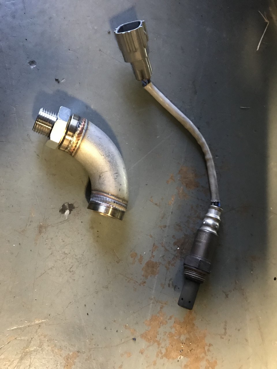

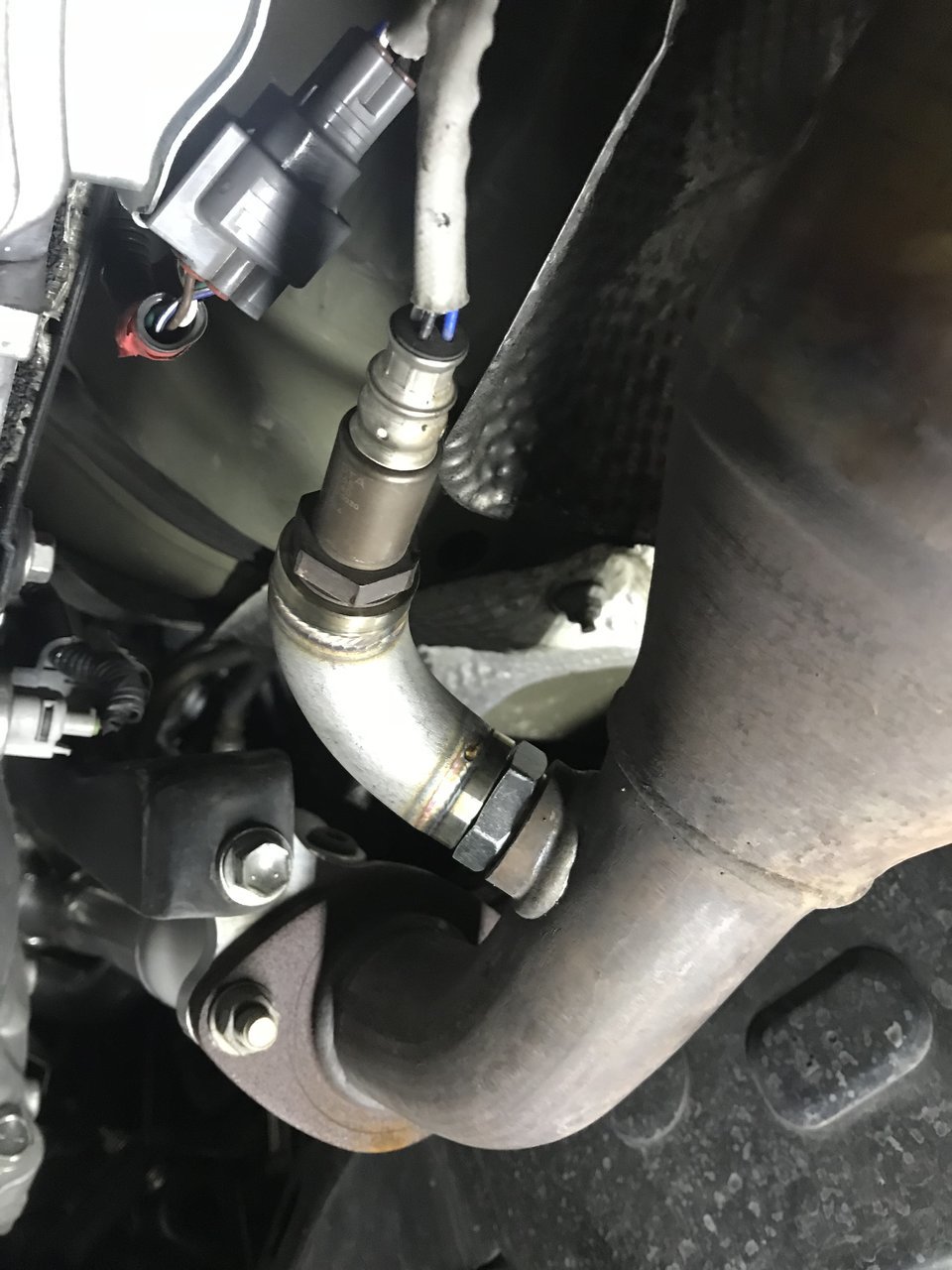

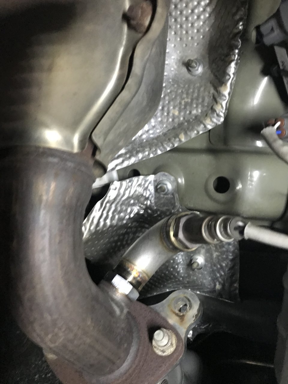

    Well I just got it in the mail today and installed. No problem with the sensor fitment in the j-pipe. I did have to bend the wire harness bracket on the passenger side so the wires would reach. Also had to remove the exhaust bracket on the drivers side to install, it when back on with no problem once installed. I went straight to the smallest insert.
    Also this is on a 2015 X-runner
    Some photos of the install
    IMG_2220.jpg IMG_2221.jpg IMG_2222.jpg IMG_2223.jpg IMG_2224.jpg IMG_2225.jpg IMG_2226.jpg IMG_2227.jpg IMG_2228.jpg IMG_2229.jpg

  19. Feb 28, 2018 at 9:59 PM

    Curious about your findings now.
