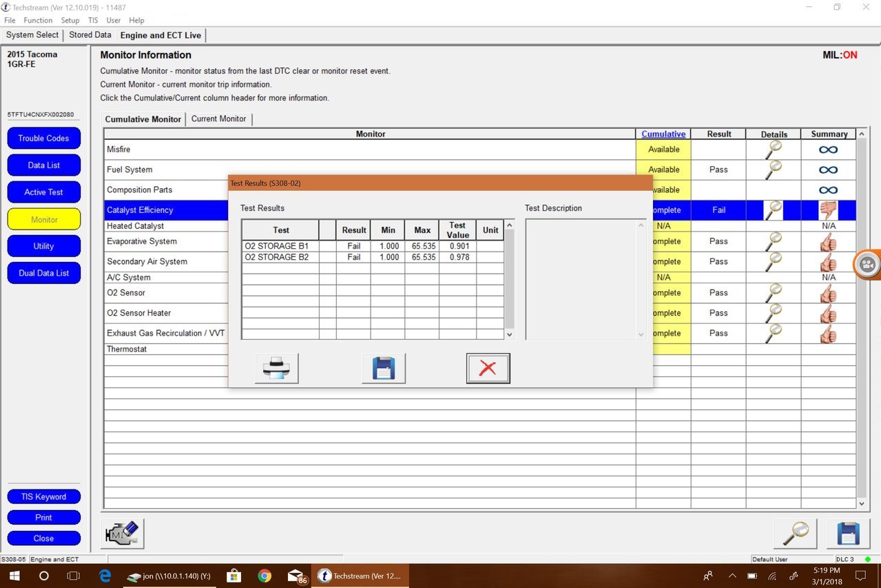

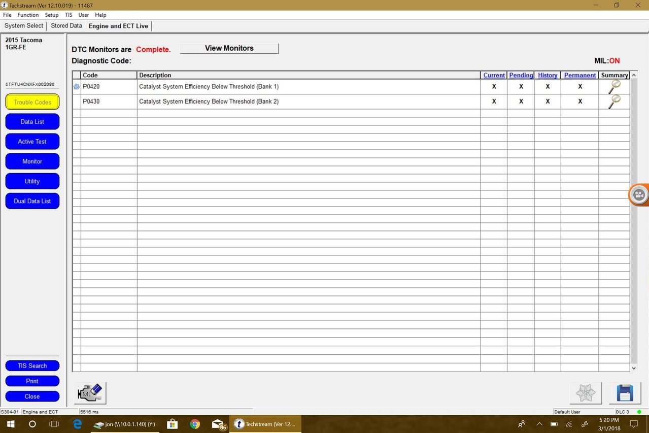

    Well after 2 15 mile trips the light is on.
    But it looks like it is really close to passing
    So I reinstalled the URD sim with the vibrant sim and I'll see how it goes. I should of looked at the values with the URD sim alone.
    I will be taking the same trip tomorrow and Saturday it takes 3 cycles to actually fail so by Saturday I should have an answer.

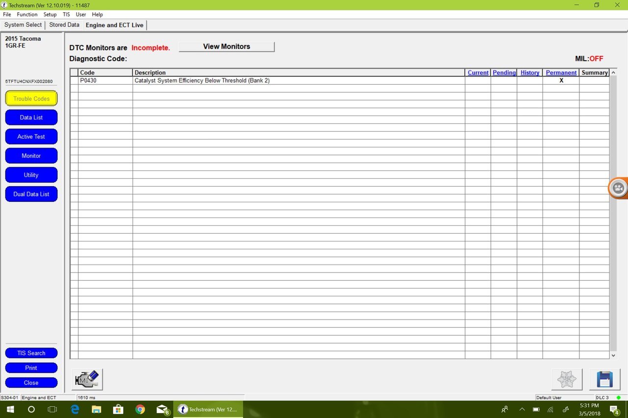

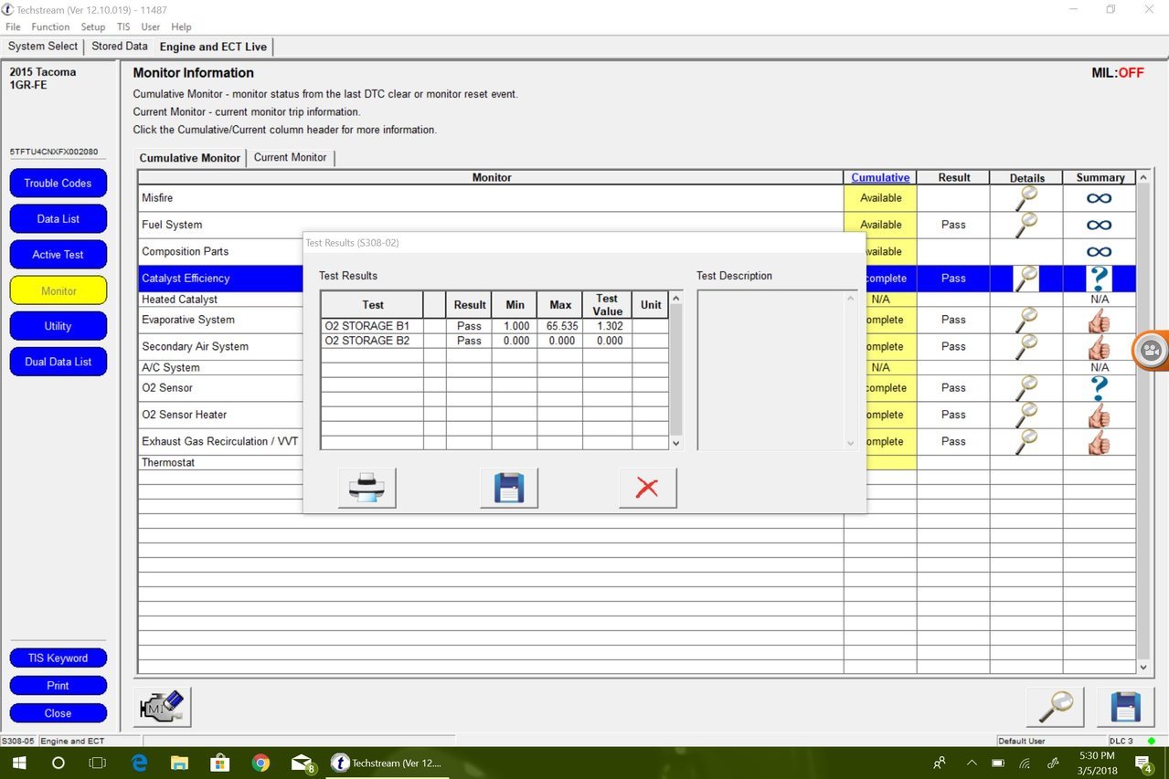

    Well I guess I won't be selling mine, things are looking up.
    Hopefully a few more trips will yield more good results.
    The fact that the permanent code is gone shows this is a good fix.
