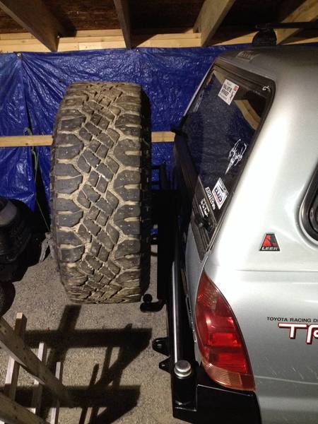

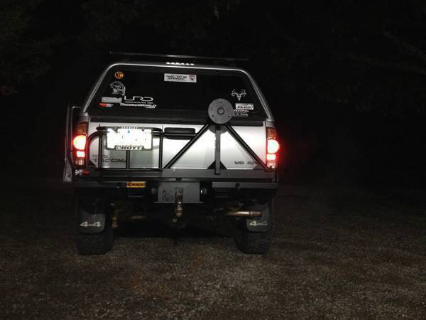

    Installed Brute Force Fab rear bumper with swing out for spare and utility basket!

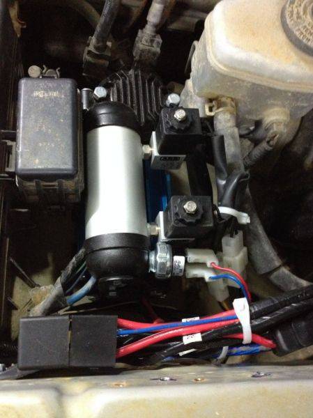

    4.10 gears and ARBs are in too!

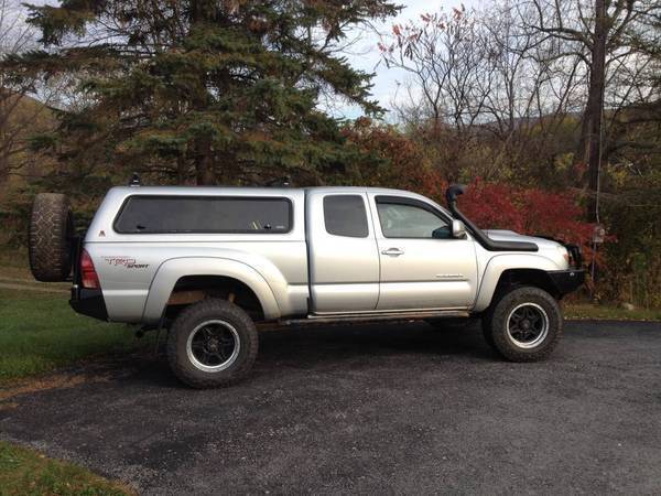

    Here she is on 4/10/13, the only changes are the D2XL OME AAL and a roof rack. Also replaced both CV's and did the ECGS bushing!
