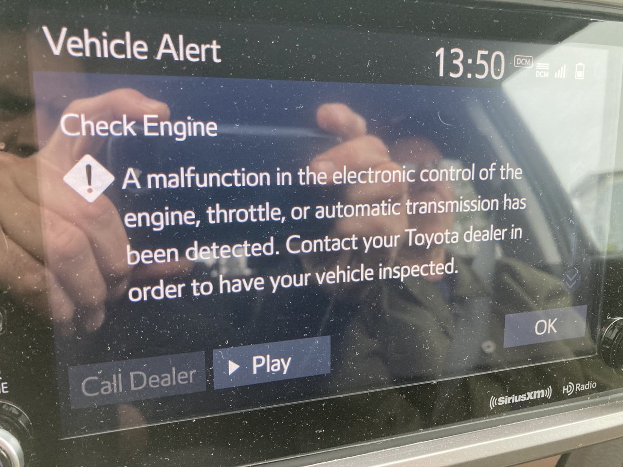

    I have a 2020 with 30k on it. Just got it a month ago from dealer. Waiting to hear back about how to figure out the warranty ,
    But curious …. They asked if I had just added gas or anything ….
    Funny part is, I just filled up week ago but had added the chevron
    Fuel system cleaner … and part of me is wondering if that was a stupid idea …. anyone thrown a code over something so dumb? Trucks runs perfect but just has the light on solid (not flashing )

    Techron is not going throw a code that I know of. Good stuff, used it for years. That info doesn't sound like your didn't put the cap back on correctly but go check.
    Do you have a cheap $20 OBD reader and free or $5 torque pro app? Really nice to have. Good luck.

    I use Techron additive all the with time no issues. You can always try disconnecting the negative battery cable and then connecting again to see if light comes back on.

    Autozone will check codes for free. Have them plug into the obd2 port and tell you the code, then google it to see what it is and what the recommended fixes are. Have you unscrewed and rescrewed your gas cap back on securely?

    A) don't throw additives into your fuel tank. The truck doesn't need it.
    B) that's a straight-to-dealer message. Especially since you don't know the history of the truck. Take advantage of that warranty, and ask for a copy of the codes they pulled.

    Thanks
    I’ll give it a shot. The truck has a warranty so I’m hoping it’s something dumb simple
    I’d rather have a facepalm I’m a dingus moment than something actually being wrong

    Thanks for the tip
    They checked for free , and gave me a print out. P013C
    Sensor 2 (02) is responding too slowly/rich to lean)
    Off to the dealer I guess
