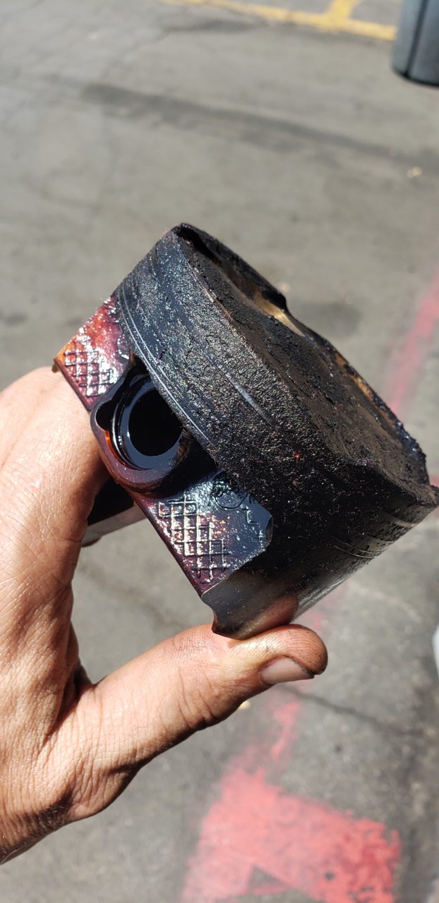

    Maybe my customer should have added some of that magic in a bottle stuff to his Ecoboost motor?

    I don't think it would have helped..... Did it get hot and burn the oil on the piston eventually causing blow by or was it caused by blow by?
    or did someone just dump oil down the intake?

    I know all too well that those types of additives in todays modern engine is nothing but snake oil ...
    To answer your question though, I'm certain blow by from high idle times. Piston 1 and 3 were normal. This was from a City Utility Truck that had 70k on the OD so you can imagine the idle times. So far this is the only 3.5L Ecoboost that I've had this issue with.

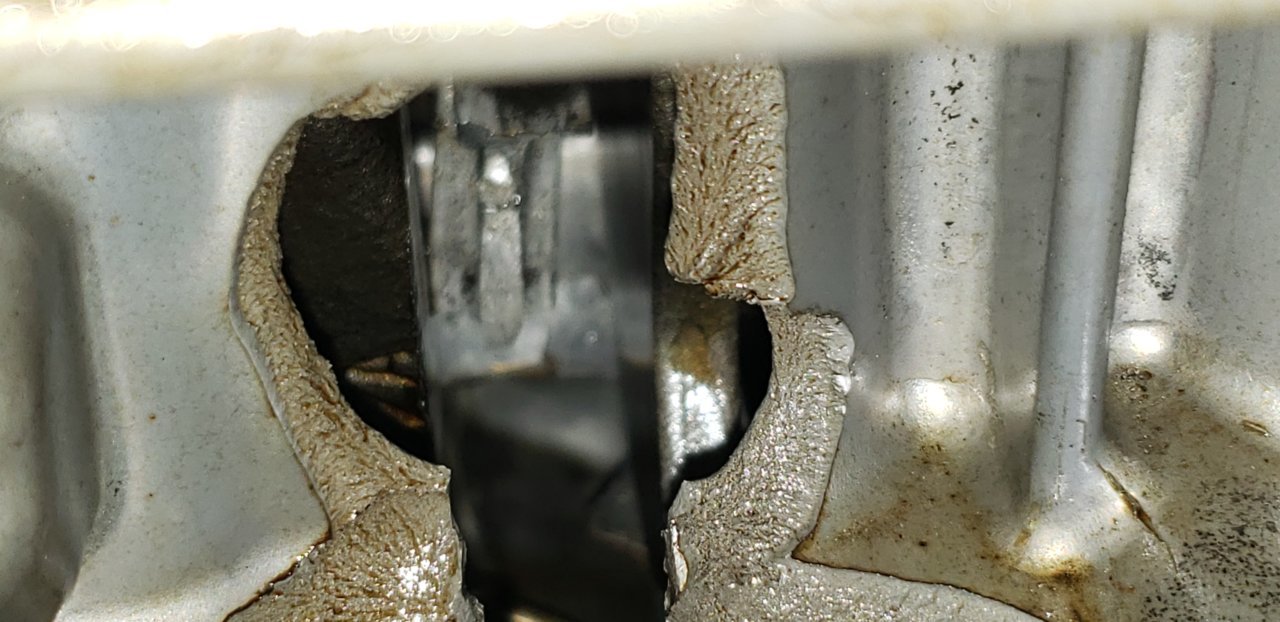

    Usually I'll see this with the 3.5L's..
    On a Raptor that I'm currently in the middle of..

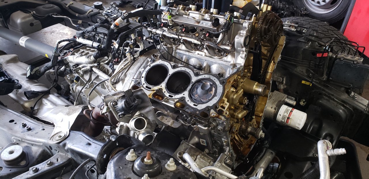

    From a Cop Car Explorer not too long ago ..

    Most likely a mixture of direct injection only, high cylinder pressure and positive crankcase pressure blow by
