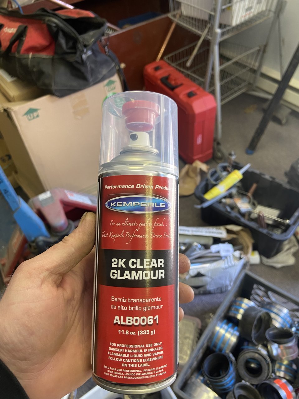

    I went with this stuff. Went to this awesome paint shop I didn’t even know existed. They told me it was just as strong as factory clear.
    Had to put another coat of primer so won’t know how it goes for a few days.

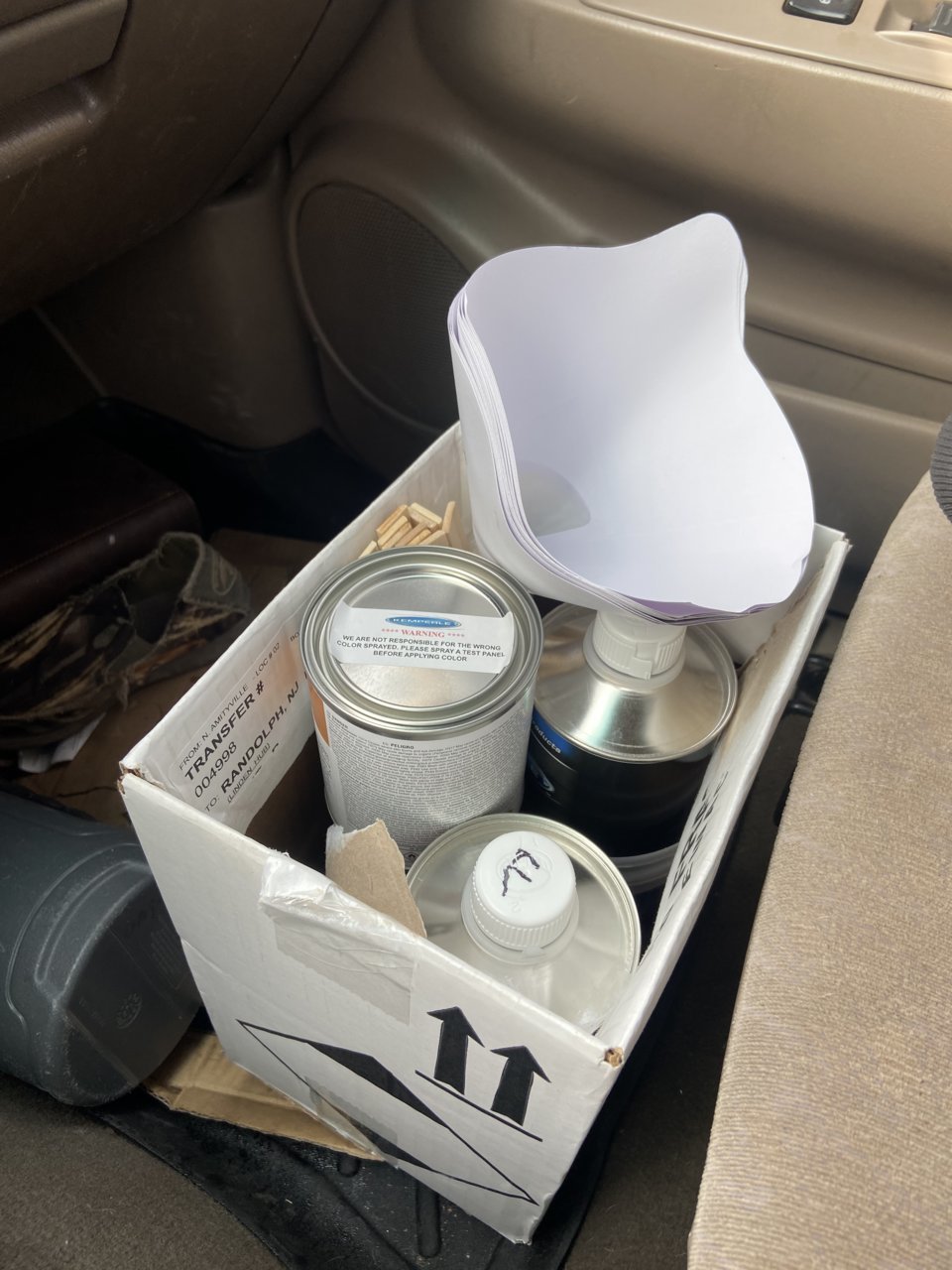

    Going w a pewter metallic base. They told me 24 hours before applying clear. Spraying base on today.

    i totally jumped ship and went the proper route. Base clear. Gonna go get a gun tomorrow.

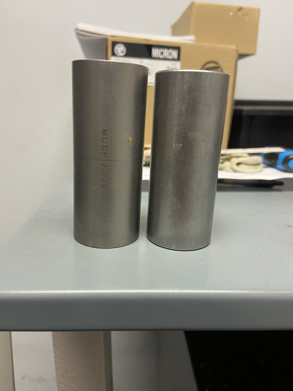

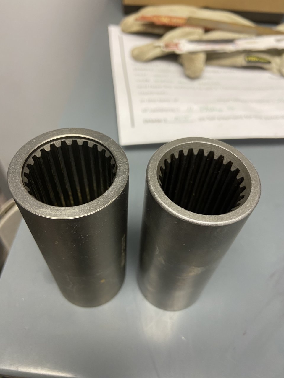

    Got the coupler today. Marlin left, Trail gear right. The pic is deceptive. They are about the same height but exact same width. The trail gear one slid on trans shaft like it was too big. The Marlin I had to beat on with a mallet and hammer to get it all the way down.

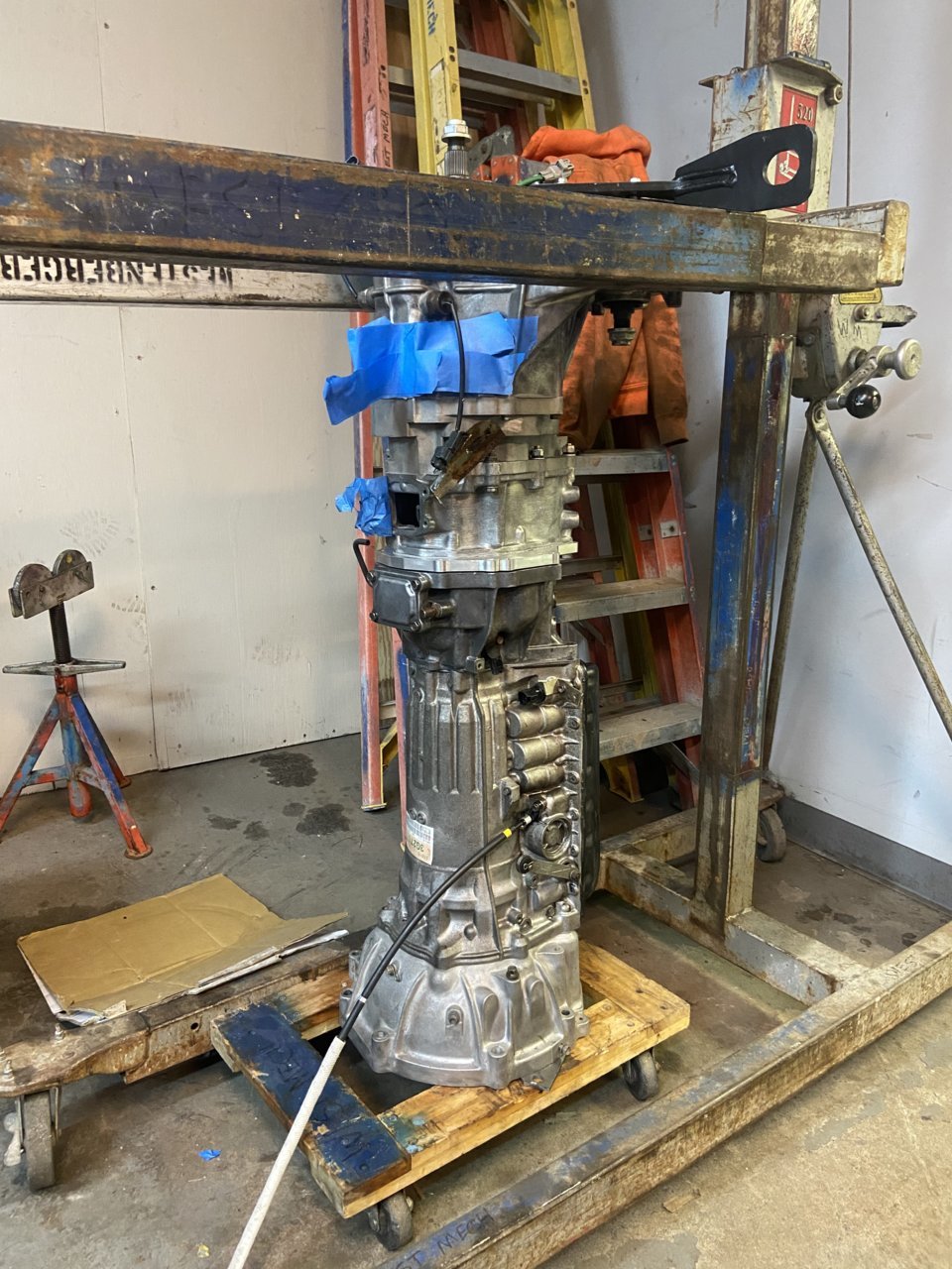

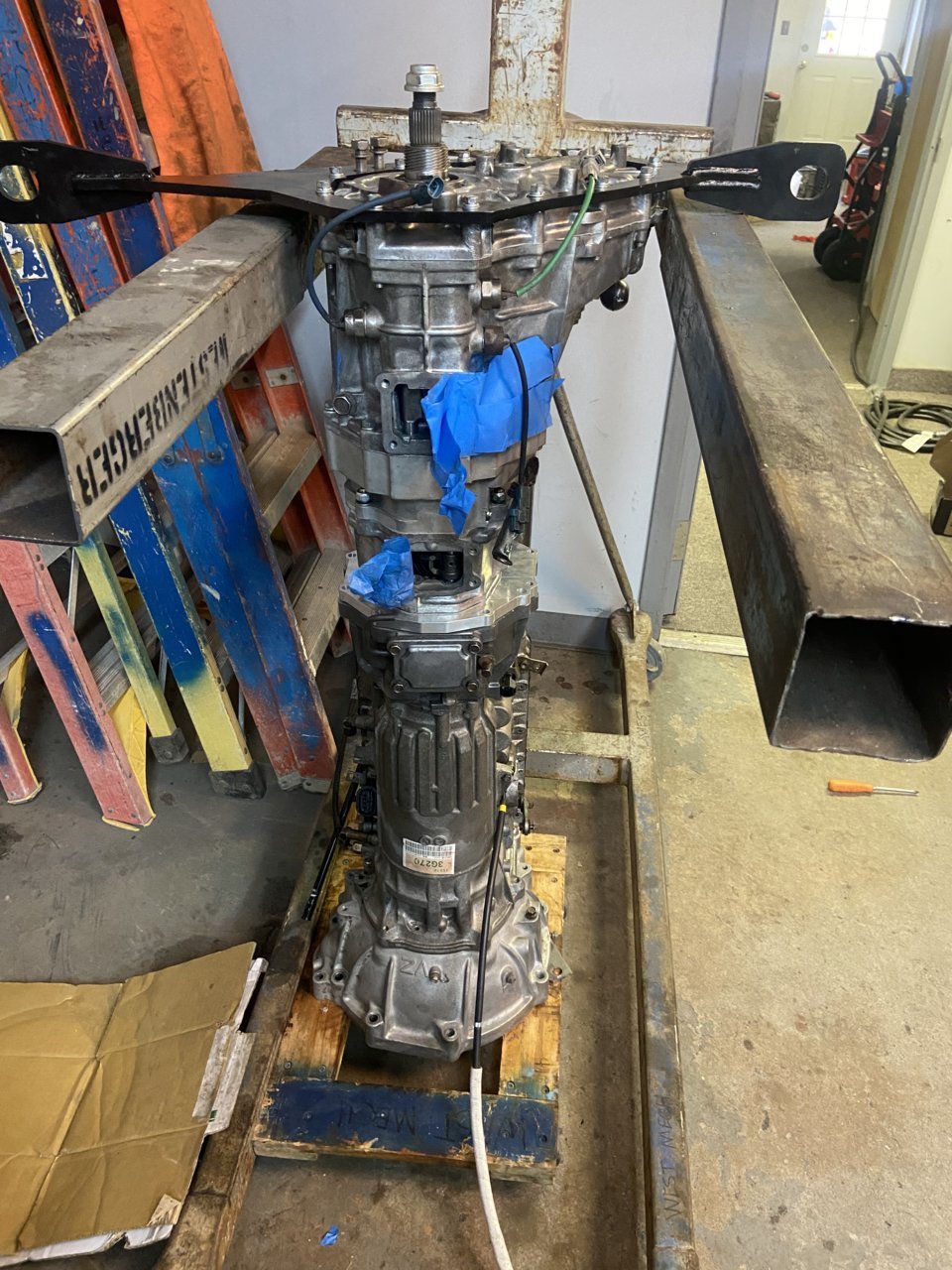

    This lift is so handy. Have used it for every aspect of this project and it came through again today.

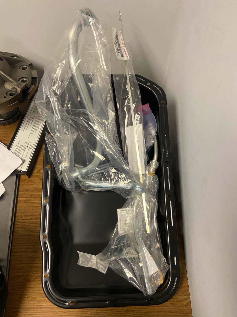

    Got all the oil pan crap finally! Went with a 2wd t-100 pan but I’m seeing why people use both 2wd and 4wd. The 2wd has more front to back clearance, but it is def lower to the ground by at least 1/2-3/4" than the 4wd. Im prob gonna have to cut it down in the front a little and modify it to clear the track but I already planned for this in my head and the 2wd has an easier structure to change than the 4wd. Here are the part numbers I went with. Ill update on whether they all work. lol
    Part Number Part Name Price Quantity Total
    12101-65030 Pan Sub-Assembly, Oil $157.47
    15104-62060 Engine Oil Pump Pickup Tube $66.64
    15147-62020 Engine Oil Pump Pickup Tube Gasket $3.05
    15301-62060 Gauge Sub-Assembly, Oil Level $17.13
    11452-62060 Guide, Oil Level Gauge $24.31
    90405-10033 Union $7.56
    96721-19010 Engine Oil Dipstick Tube Seal $2.10
    Subtotal: $278.26
    Estimated Shipping to 07866 via Expedited Shipping: $27.47
    Tax: $10.13
    Total: $315.86

    I had to do the same shit with my 26spline marlin coupler on my w59 4cyl trans output. 5lb sledge.
    I hope I never have to take that thing back off....

    Yeah, that thing is super tight! Ill take tight over loose any day though!! Trail gear coupler was like a used up 50 yr old hooker compared to the MC.
