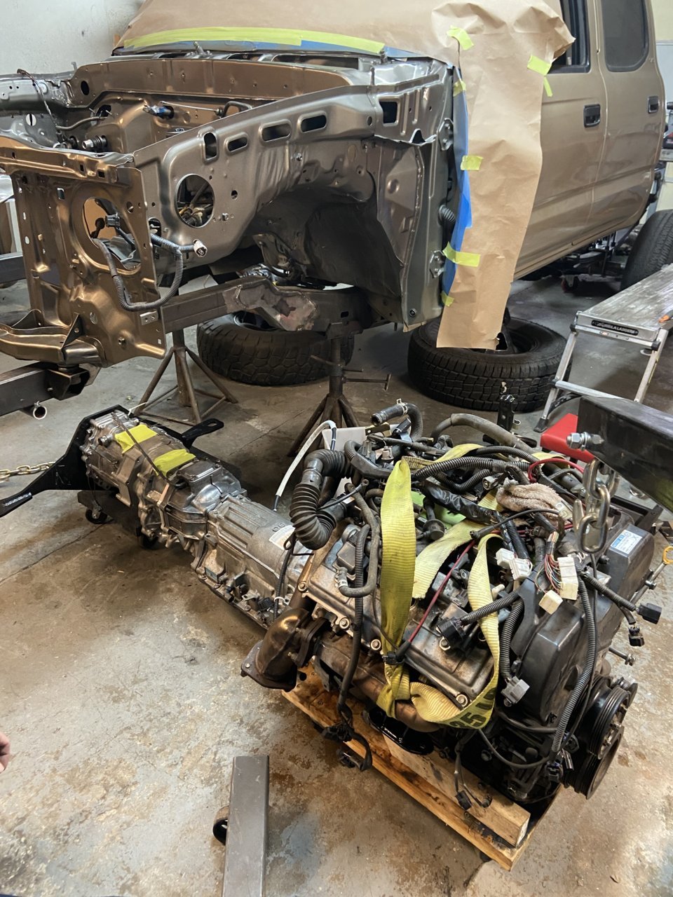

    1st gen
    ls turbo, tons, 40's and a partidge in a pear tree

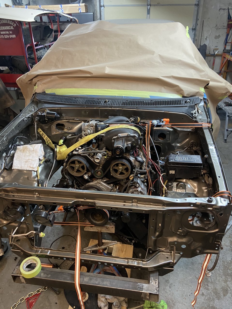

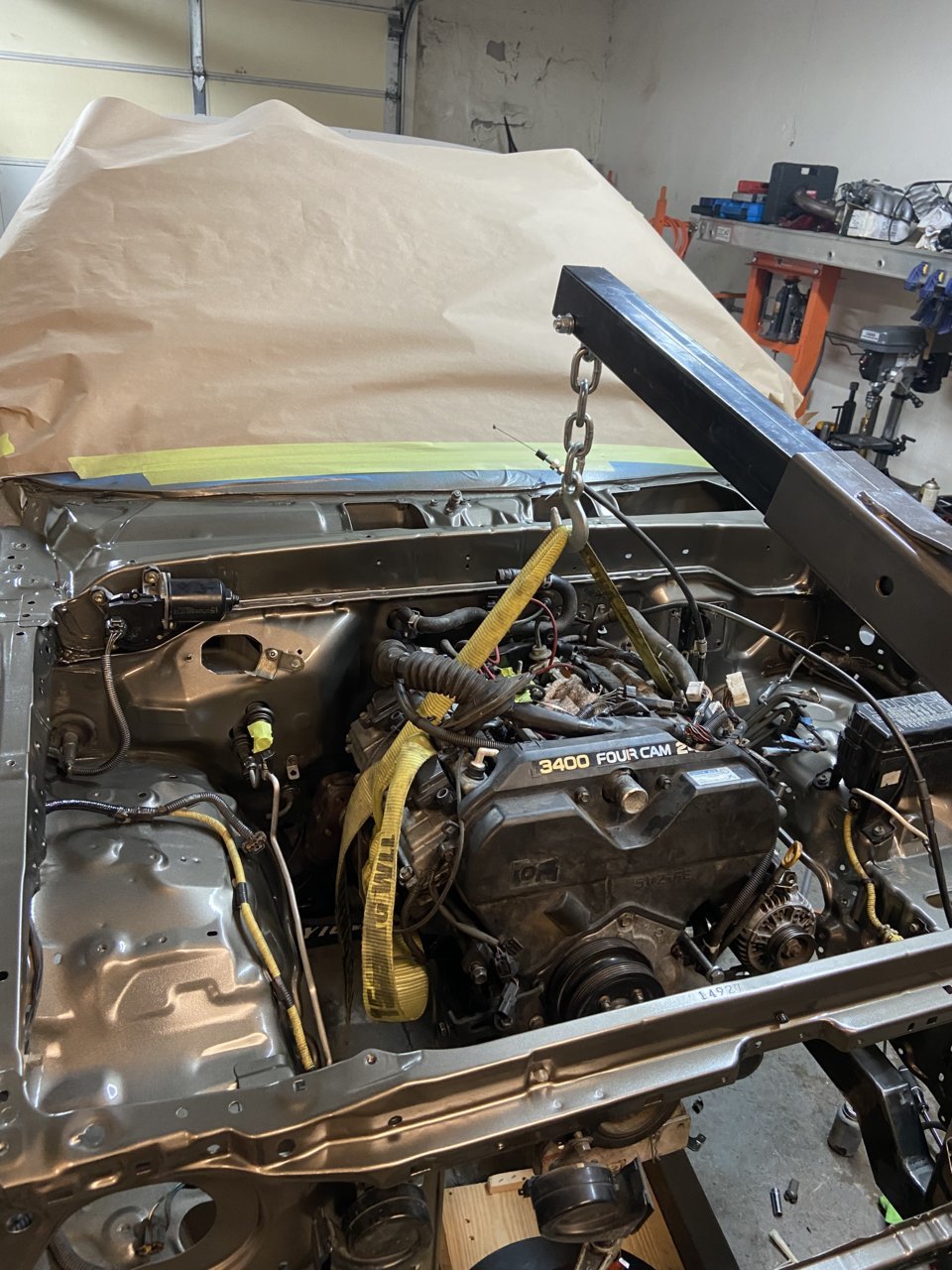

    Dealing w this whole assembly is difficult w no existing mounts. It’s long and heavy. Got the engine close to in place but need to spend an hr or so measuring. Need help tomorrow for safety concerns. Make mounts and should be done w this motor shit.

    Its killing my body but I love it! Have 10 hours to spend on it tomorrow so, should get it done if I don't have to drive around buying shit. Still don't know how im gonna change the t case brace to a solid mount but have a few ideas.

    Did you get the trans and motor in w/o removing the trans?!
    Edit: realized you don't have the IFS x members - reason to SAS alone.

    Yeah, I put in all on those small ass harbor freight dollys and rolled it in there. I swear, I can bang any kind of shit out with ease mechanically but I always get my assed kicked by tranny installs. I always try to keep them together at all cost. On ifs I just pull the motor w trans if I have to take trans out. Motor takes me like 45 min to prep for removal. So, much easier.

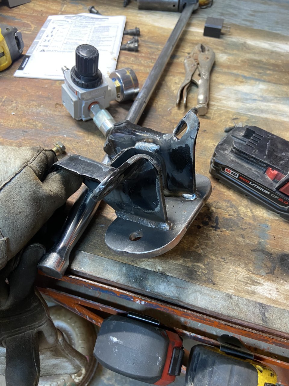

  13. Mar 30, 2022 at 2:59 PM
    #293
    Yota X
    Yota X [OP] Some say dresser, I say dryer.
    Jul 11, 2019
    #298961
    5,268
    NW New Jersey
    1st gen

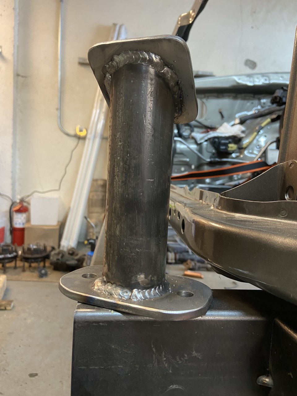

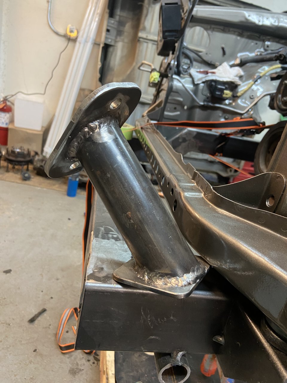

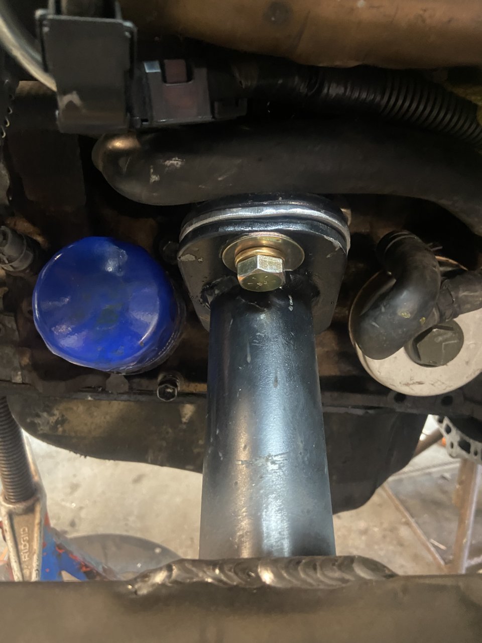

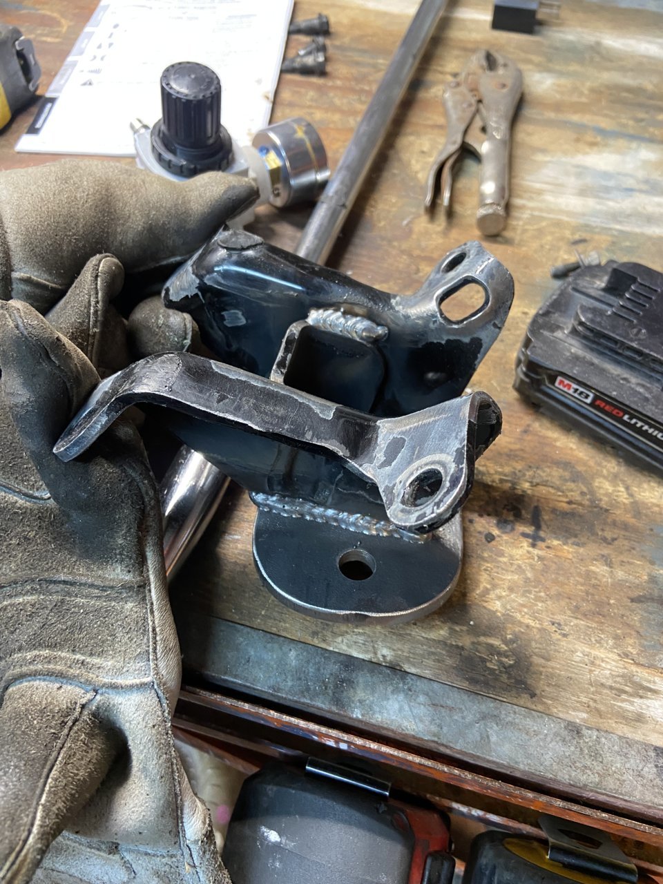

    The motor mounts took 2 full 8 hour days to figure out and make. Getting the motor and cases in the perfect position was the most time consuming part. Had to use a shit ton of ratchet straps.
    I decided to redo the mounts entirely. Gave them some better angles and the square tubing wouldn’t work on the oil filter side anyway. Way too tight. They came out nice I think. DOM is super hard to weld around but clean. Gotta give credit to @malburg114 as well for the idea. I knew he used dom and now I know why. Thanks!

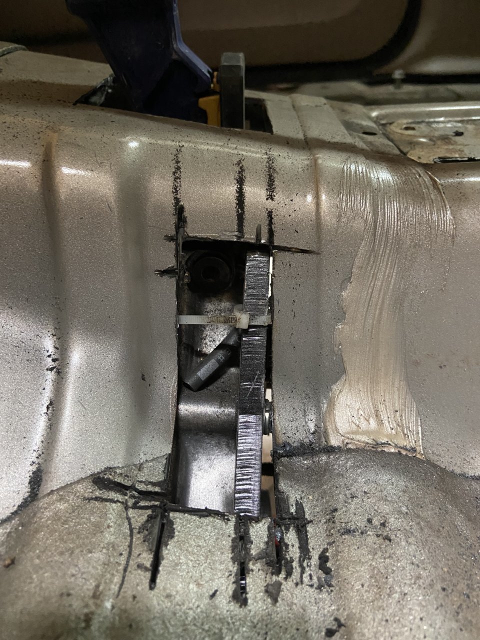

    Had to cut a little for the t case. Ended up with the motor 2.5” higher at cams and 3/4” back. Cases are as high as I want them.

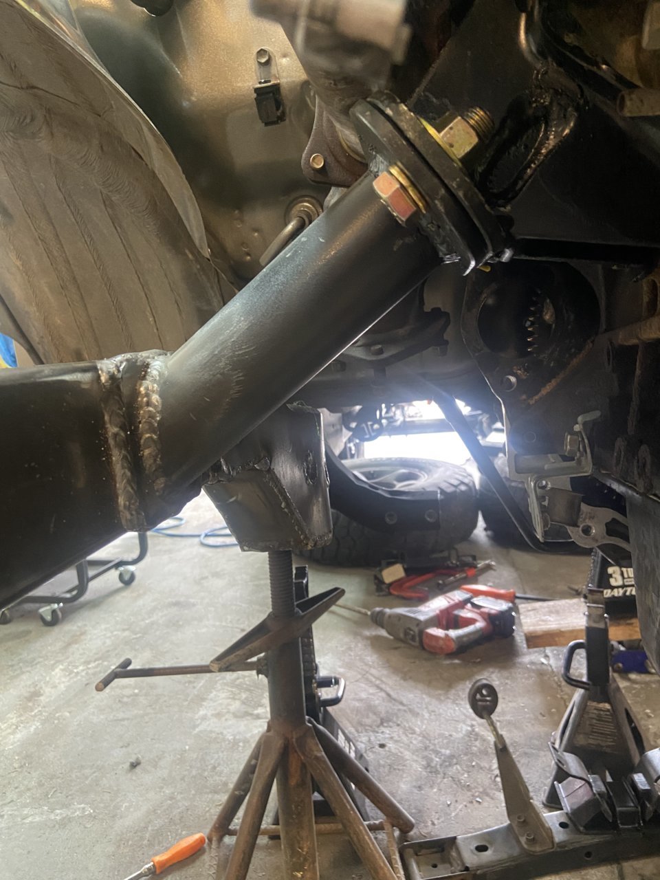

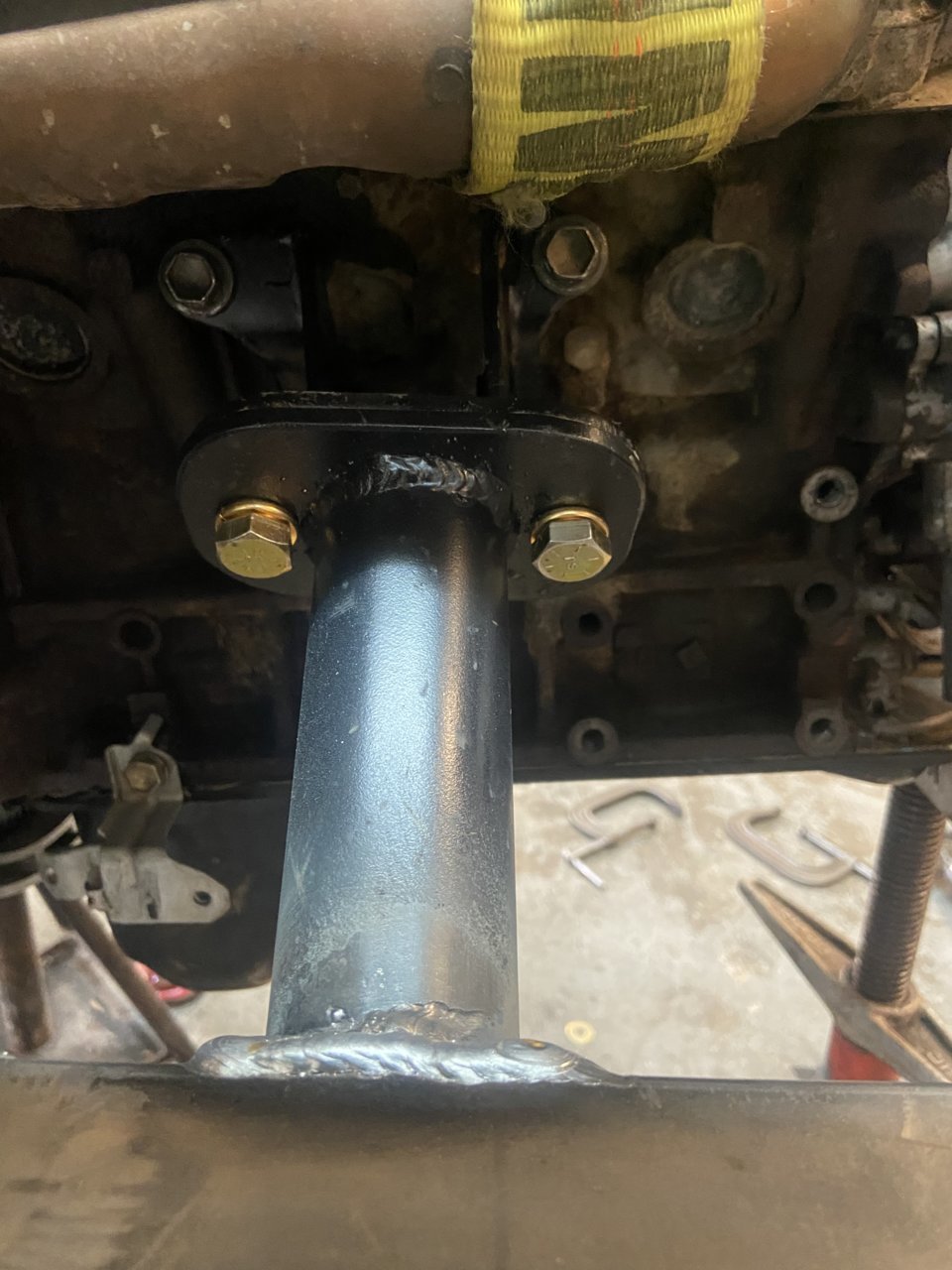

    Final mount setup.

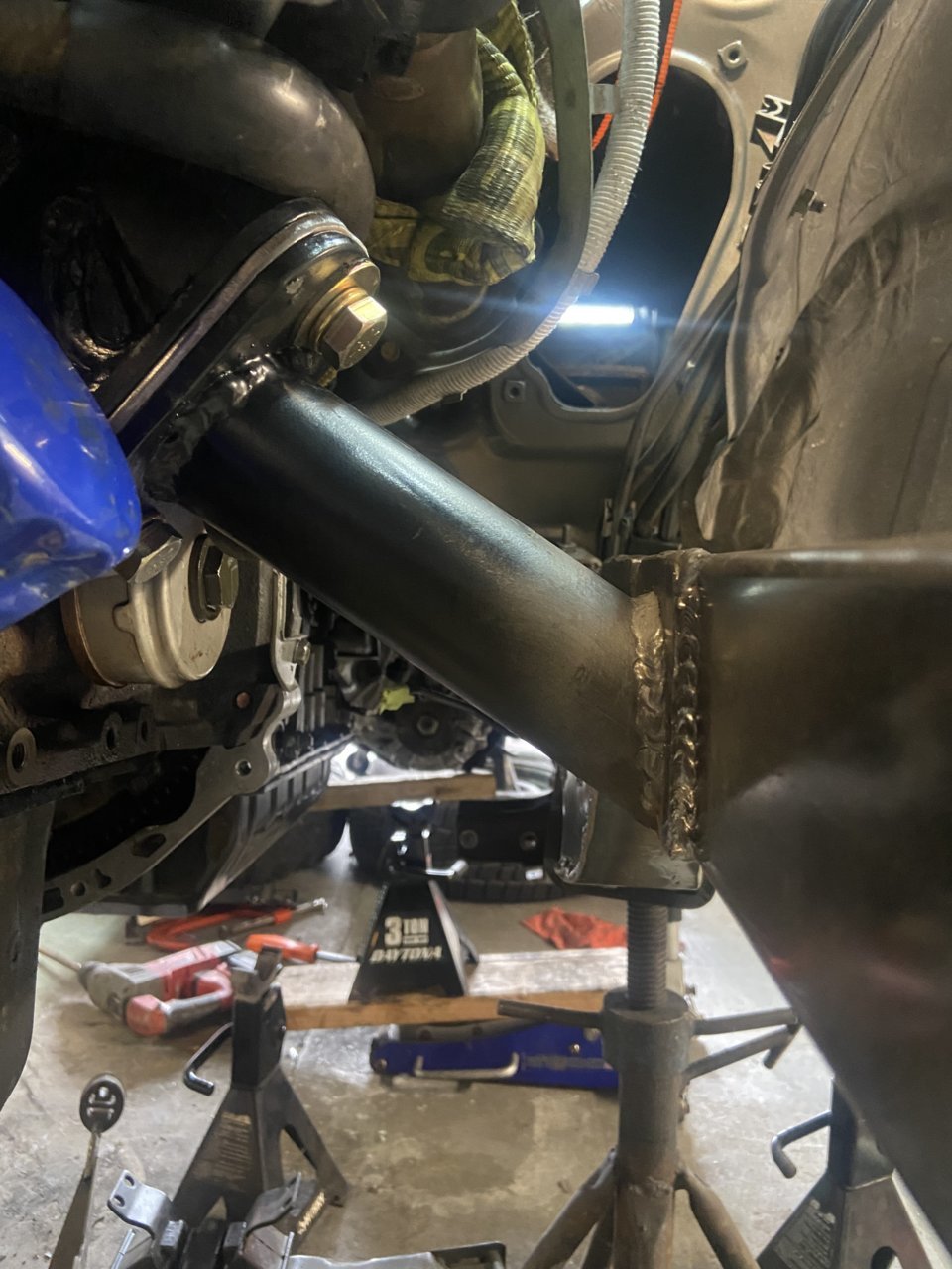

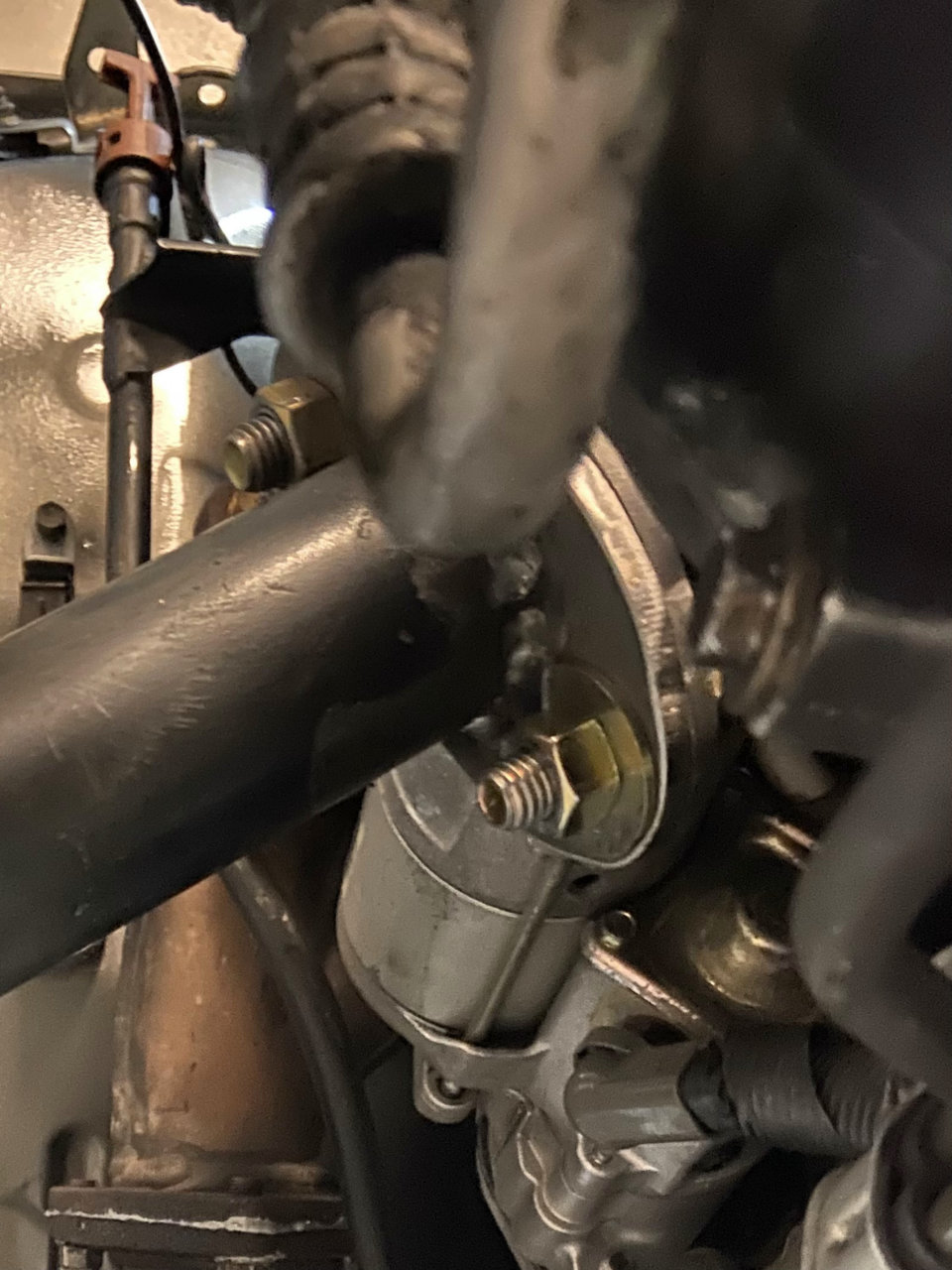

    1st gen
    Mount Update - Made an absolutely massive mistake. Thought I could squeeze the starter in no problem when the pass side was getting final welded. I was wrong. The starter is way bigger than I thought. Spent an hour grinding and trying to make it work. Not happening.
    So spend 4 hours cutting the existing dom from frame back 2" and cutting engine mount back, replating it and adding 2" of dom on that side so the joint was far enough away from starter. Then switched the joint to vertical vs horizontal bolt up and had to weld the tube on the truck so it isn't as nice either. Really pissed at myself but its done.

  17. Apr 1, 2022 at 1:35 PM
    #297
    Kwikvette
    Feb 27, 2019
    #284735
    81,638
    Fresno County
    4 run, 2 don't
    Fuck...damn.
    That's the thing about custom work; least you found a work-around.
    Yota X[OP], jubei and Slashaar like this.
  18. Apr 1, 2022 at 1:42 PM
    #298
    Slashaar
    Slashaar Trail Limo Supreme & Certified Hole Massager
    Nov 23, 2017
    #236717
    15,529
    Josh
    Kansas City, MO
    2015 Tacoma TRD-Sport DC LB
    Coastal HC Front, 6112s+650lb King Coils, JD 62 Swap + 14" Fox 2.0s
    but you know when the thing is out tearing it up, the smile on your face will be worth the effort.
    skeletron and Yota X[QUOTED][OP] like this.
