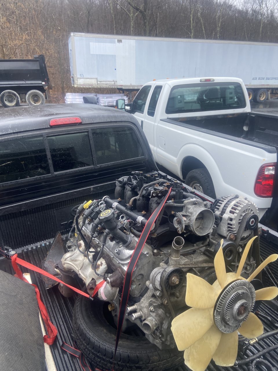

    I don't have to worry about emissions as much here but I know its tough to get it done. I actually cannot find one for under 3k anywhere. Im going to look at an LQ9 tomorrow. Its gonna suck trying to get it in there but Im on a serious time crunch. Pulled motor today. Kinda upsetting but fuck it.

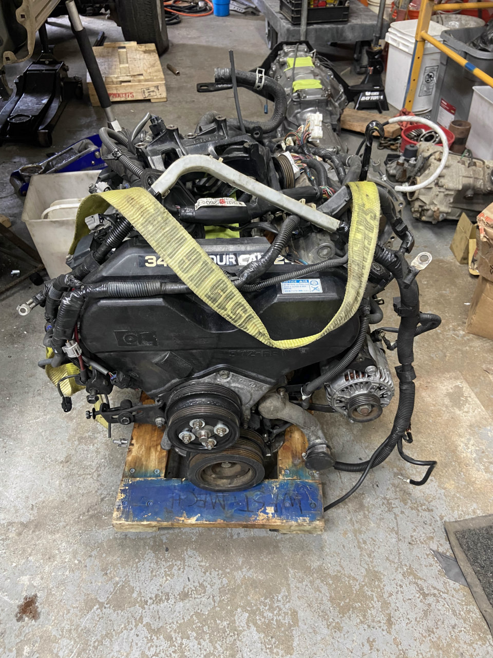

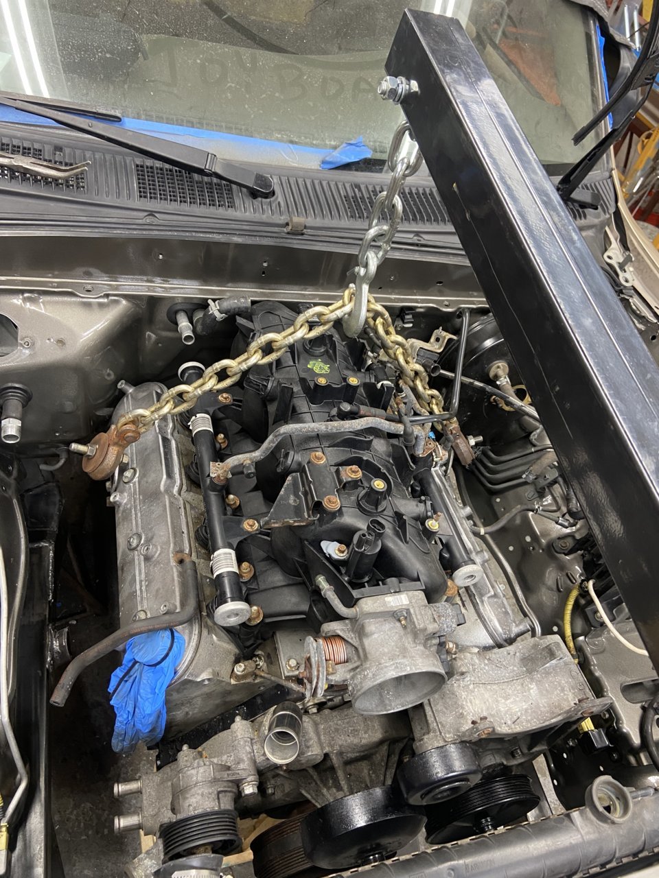

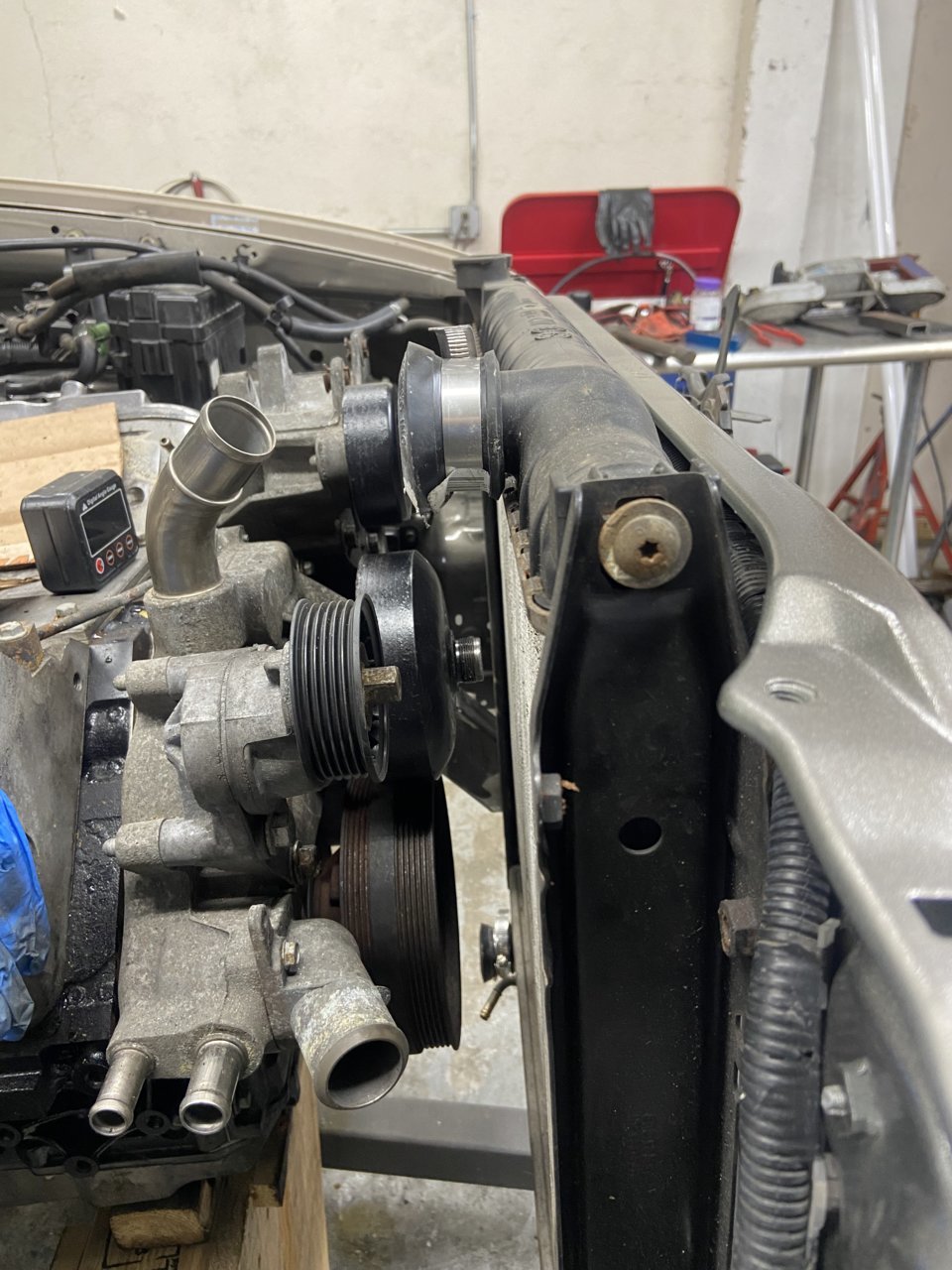

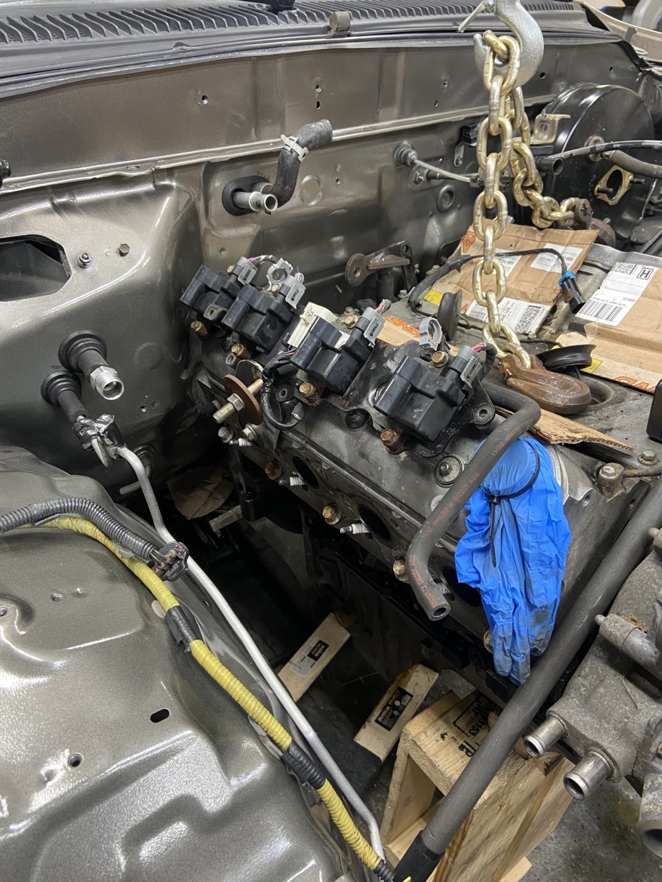

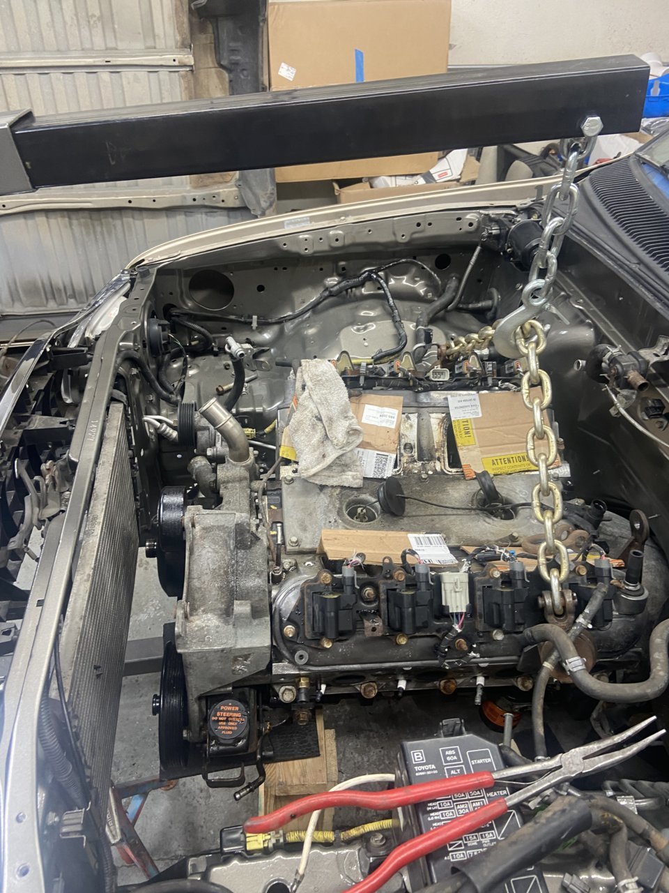

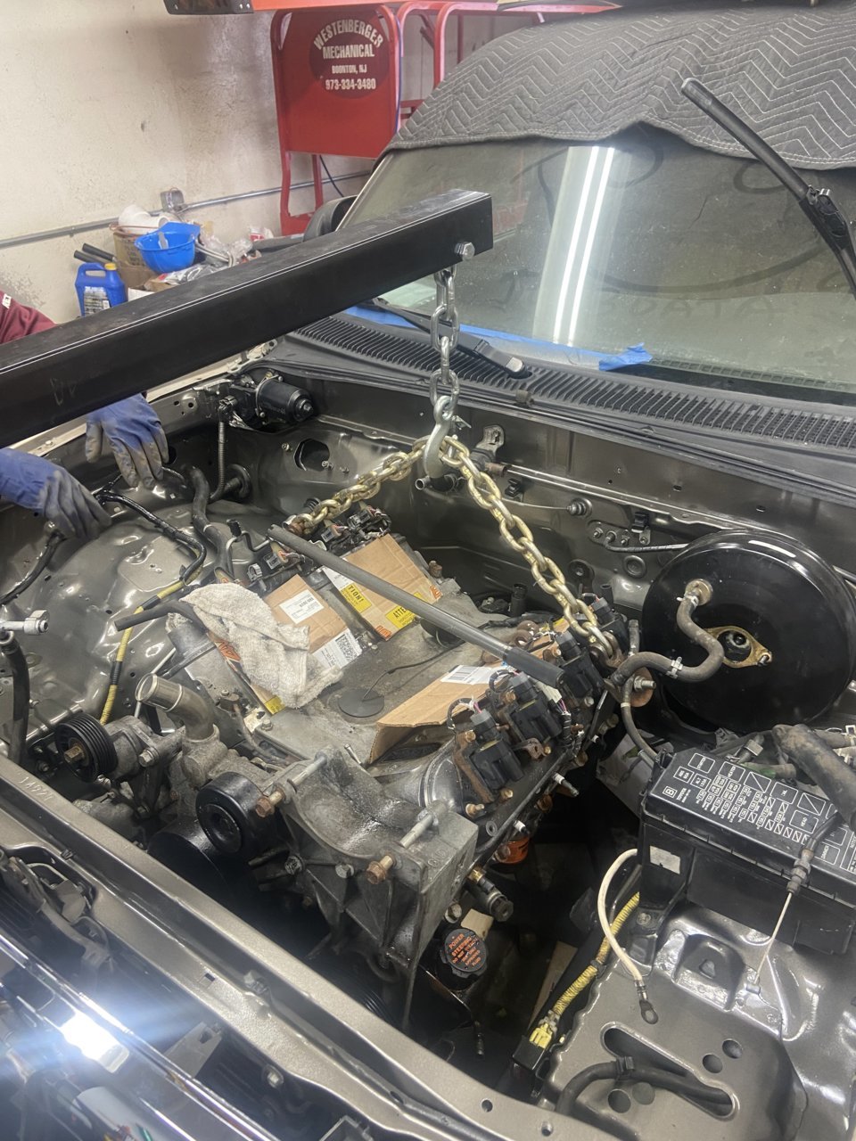

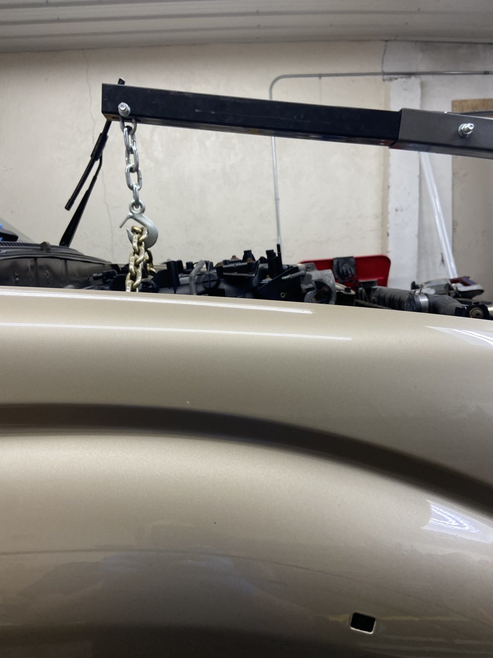

    It’s tight but it looks like my brake booster is actually gonna be the biggest issue. Have to relocate the coil packs. Beat the firewall in a little and I should get another 2-3 inches back from this pic. Prob have to shim the condenser forward also to fit radiator and an electric fan. Gotta get an alt relocation bracket also.
    Once I get a low LS intake I can keep the height where it is I think.
    UPDATE- IF YOU DO AN LS SWAP GET A LONG BLOCK AND A 4L80 TRANS. DON'T BUT A COMPLETE CAUSE NOTHING WILL WORK... PERIOD. YOU CAN USE ALTERNATOR AND COMPRESSOR/COMPRESSOR BRACKET BUT COMPRESSOR IS PROB JUNK ANYWAY.

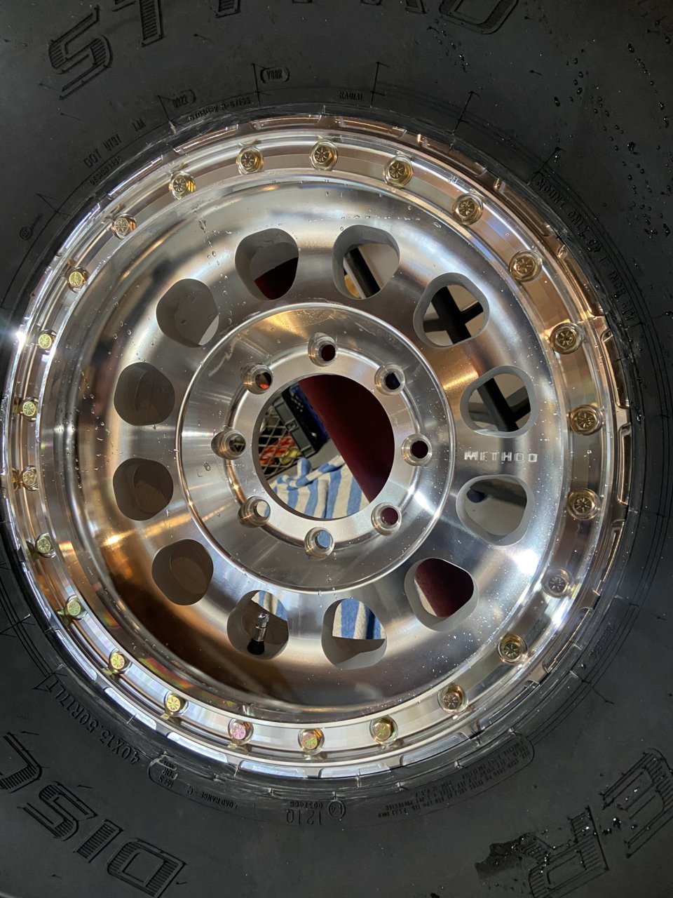

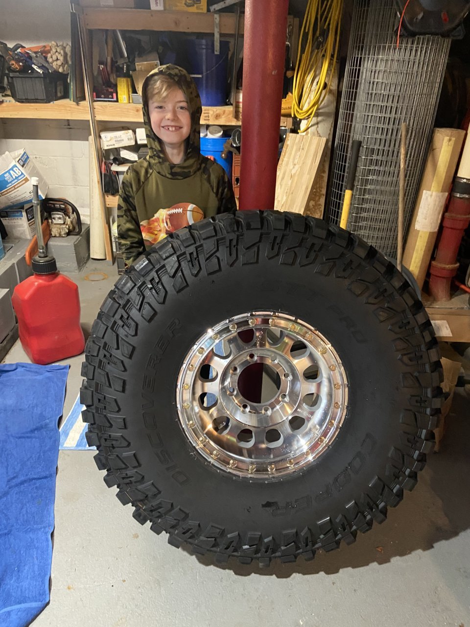

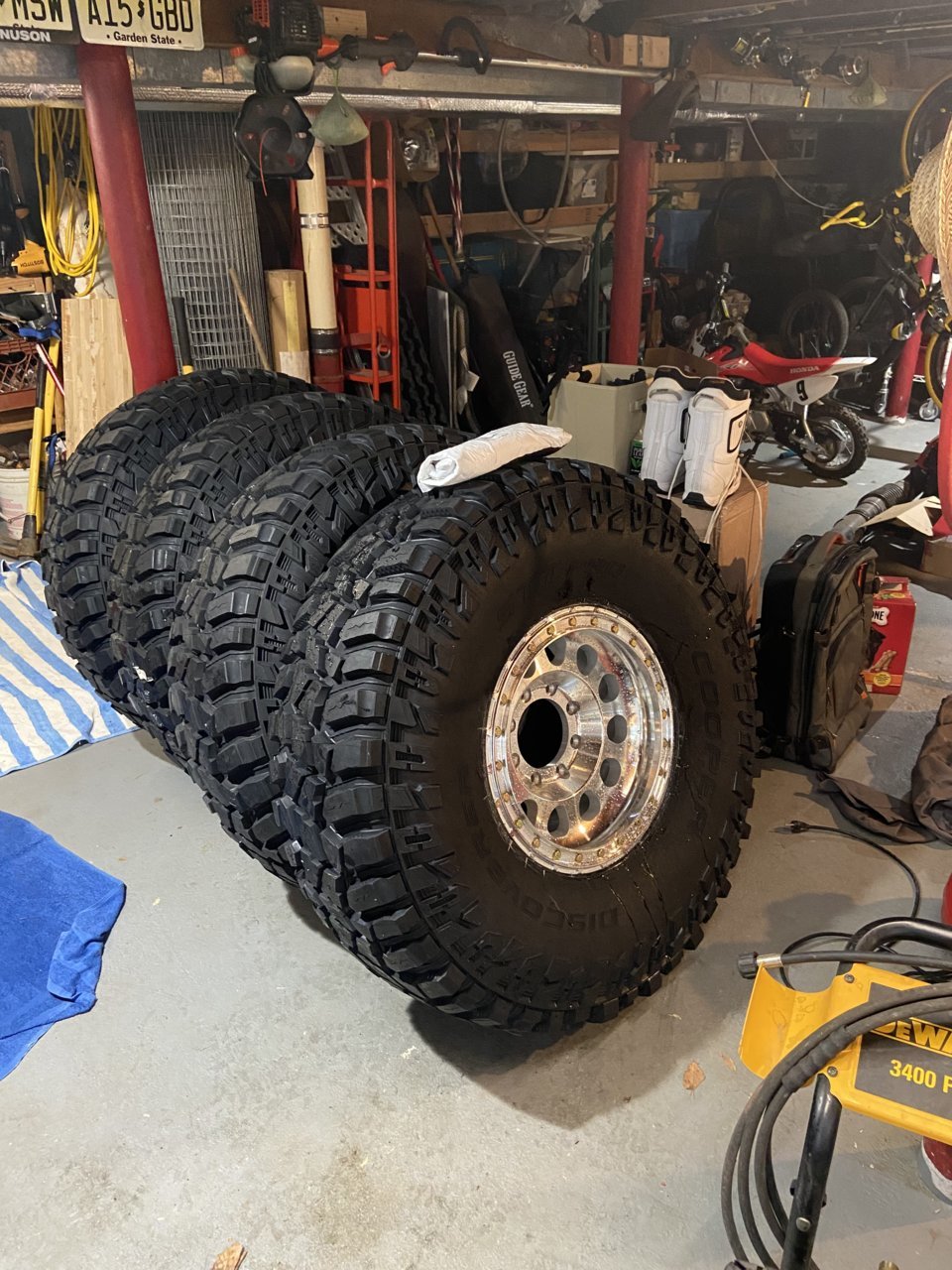

    Got the wheels today. Kind of big.

    Im really glad I ended up with the coopers over nitto. They are a really good looking tire.

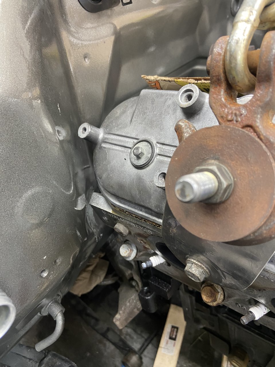

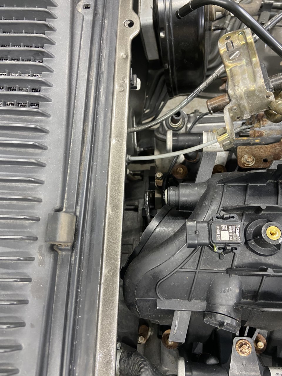

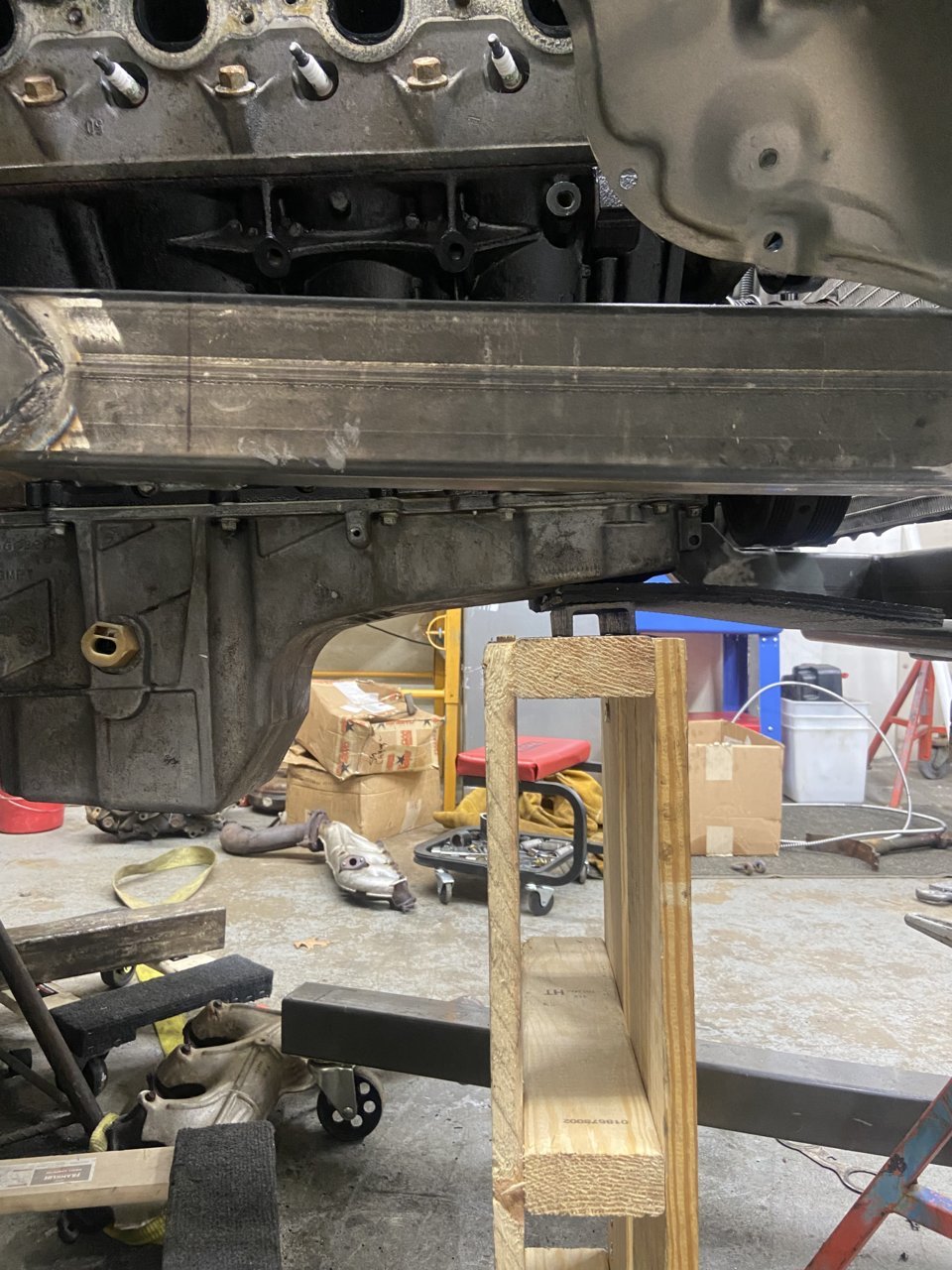

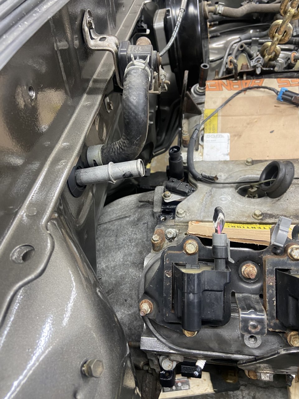

    Looks like the exhaust is gonna be the biggest issue. May have to cross over to pass side to stay away from upper link. Which means I need a tig welder. Fun but more money.
    Completely ruined the paint on firewall tunnel. Had to push it in about 2” deep and about 8” towards back of truck. Otherwise, this is how it will sit. May get 1/2 back at most. Pan is 1” lower than the 3.4 but they make a million pans for these things so I’ll get a slim one.
    Obviously this intake is out! Way too high!
