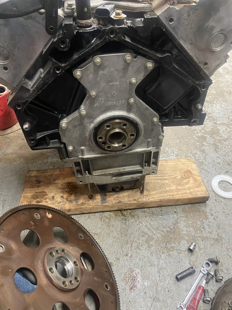

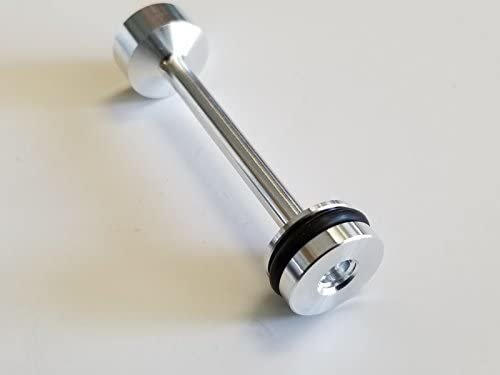

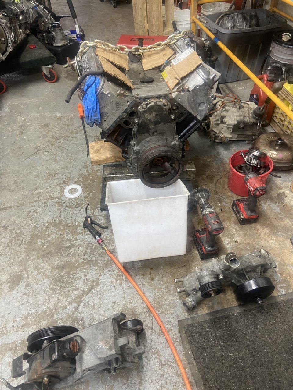

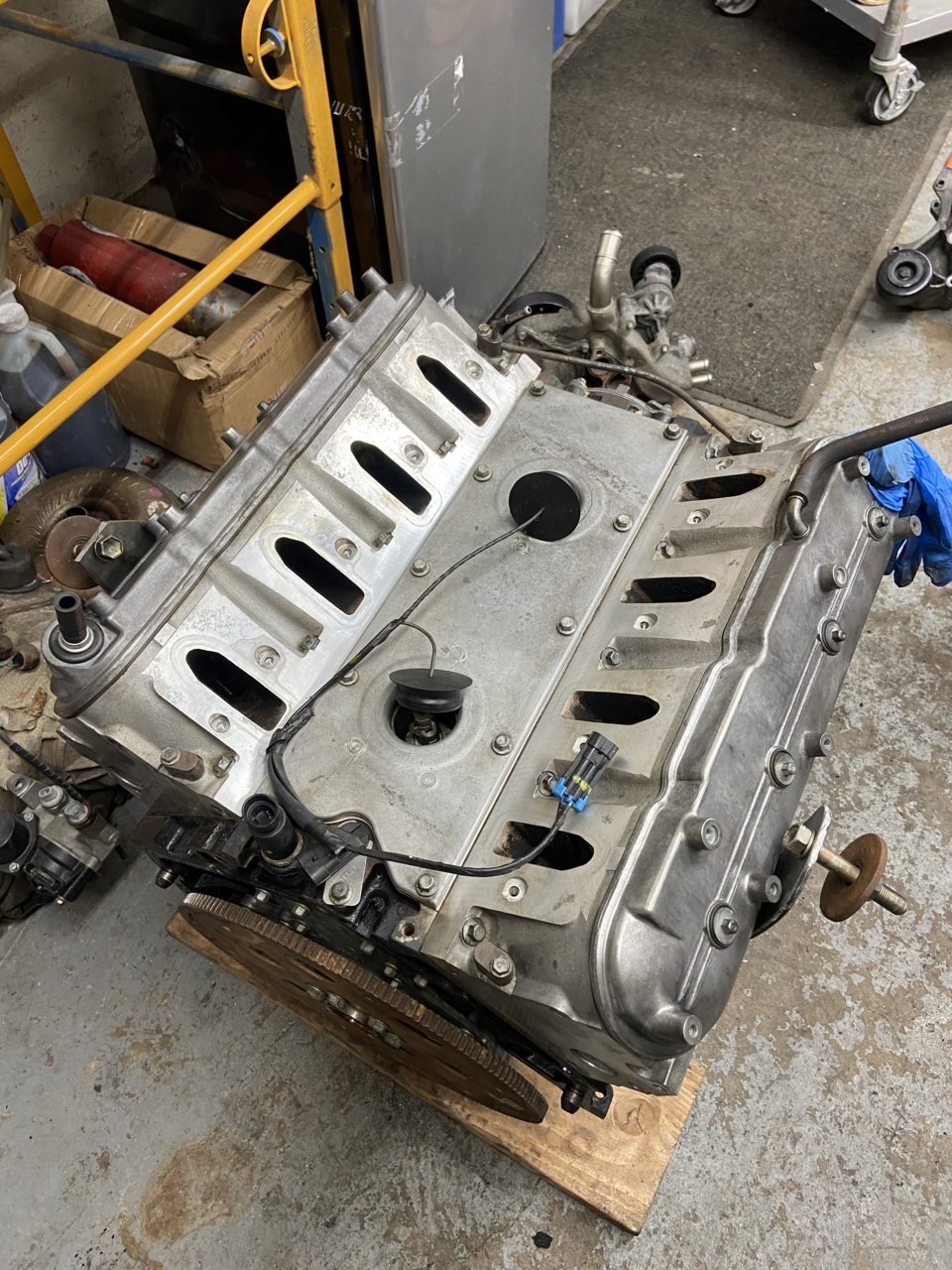

    Did some maintenance with the limited time I had. It’s ready to clean up now.
    Did rear seal and gasket. Forgot to take pic but put this aluminum oil diverter in. I guess the oem ones cause oil pressure issues according to drift guys.
    These motors are so easy to take apart it’s comical.
    CAB07040-CB74-4853-B971-9BEF2F3F1D52.jpg C753A9A4-5752-4C33-BA2F-0DDDD67BB665.jpg 0896B5C3-EFC1-4D06-B205-04B28082FB02.jpg

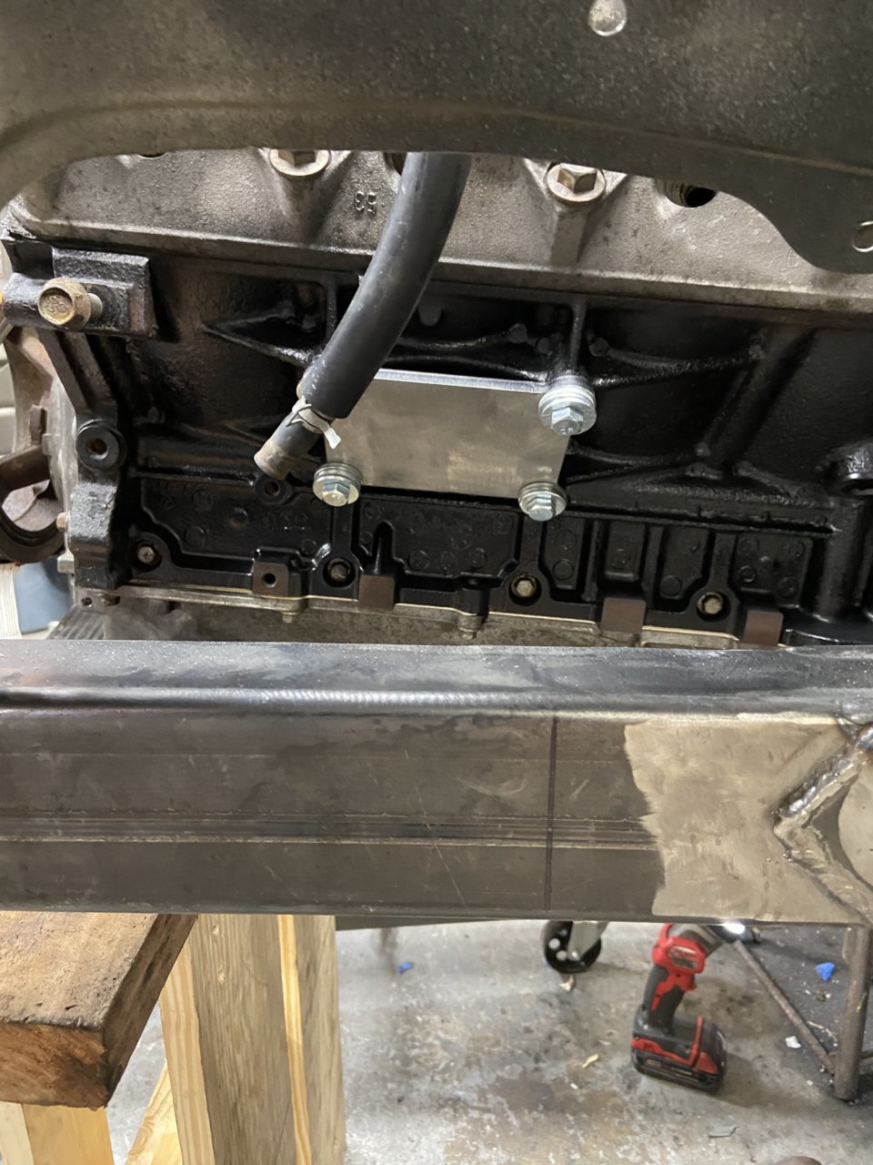

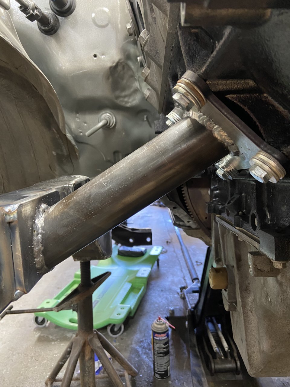

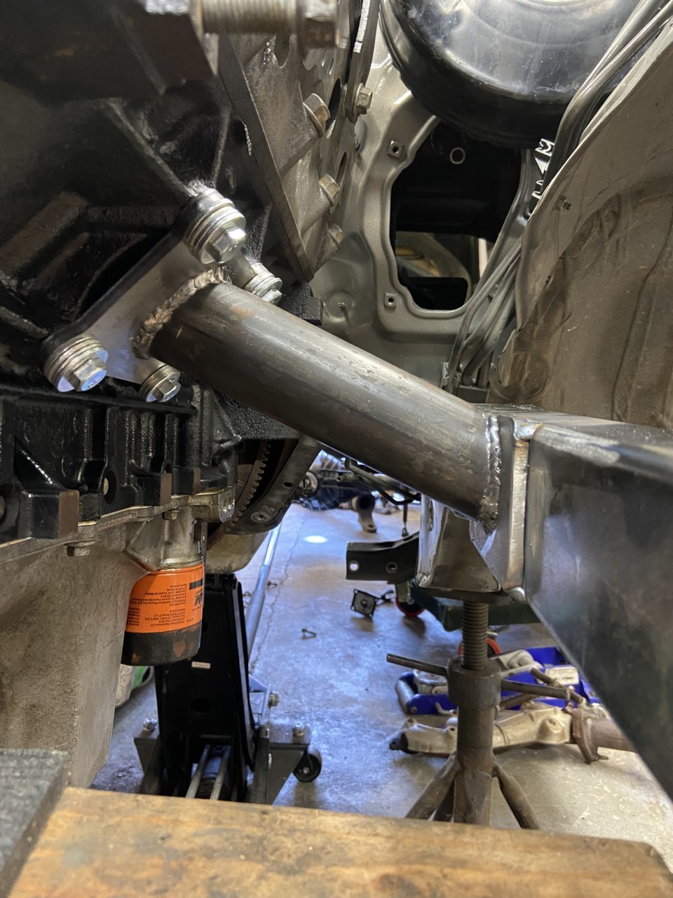

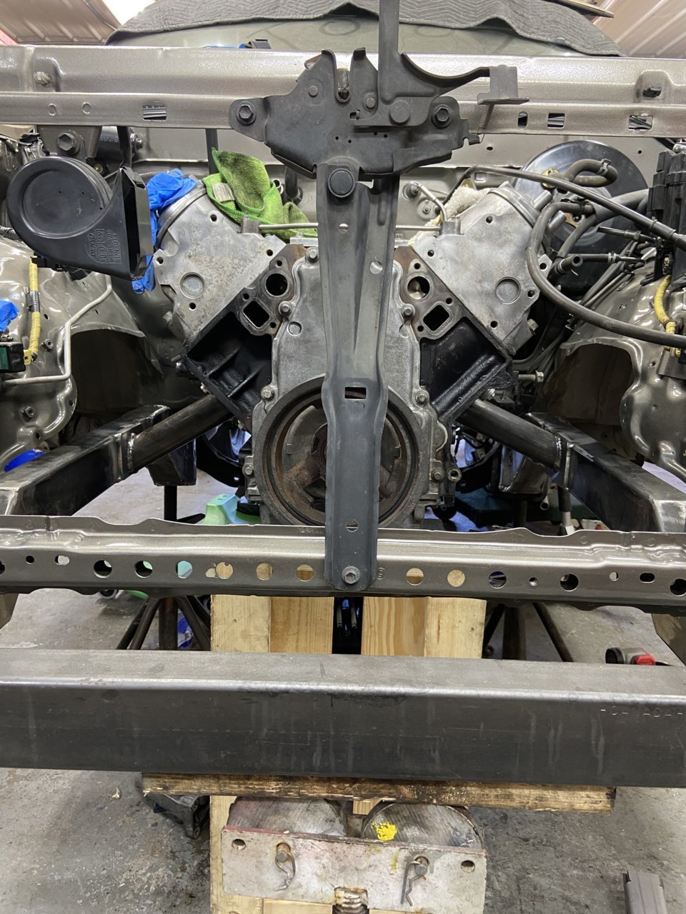

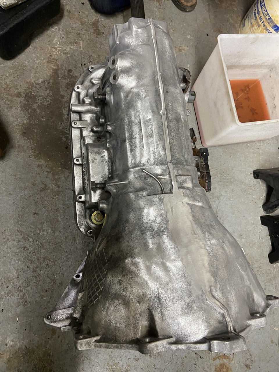

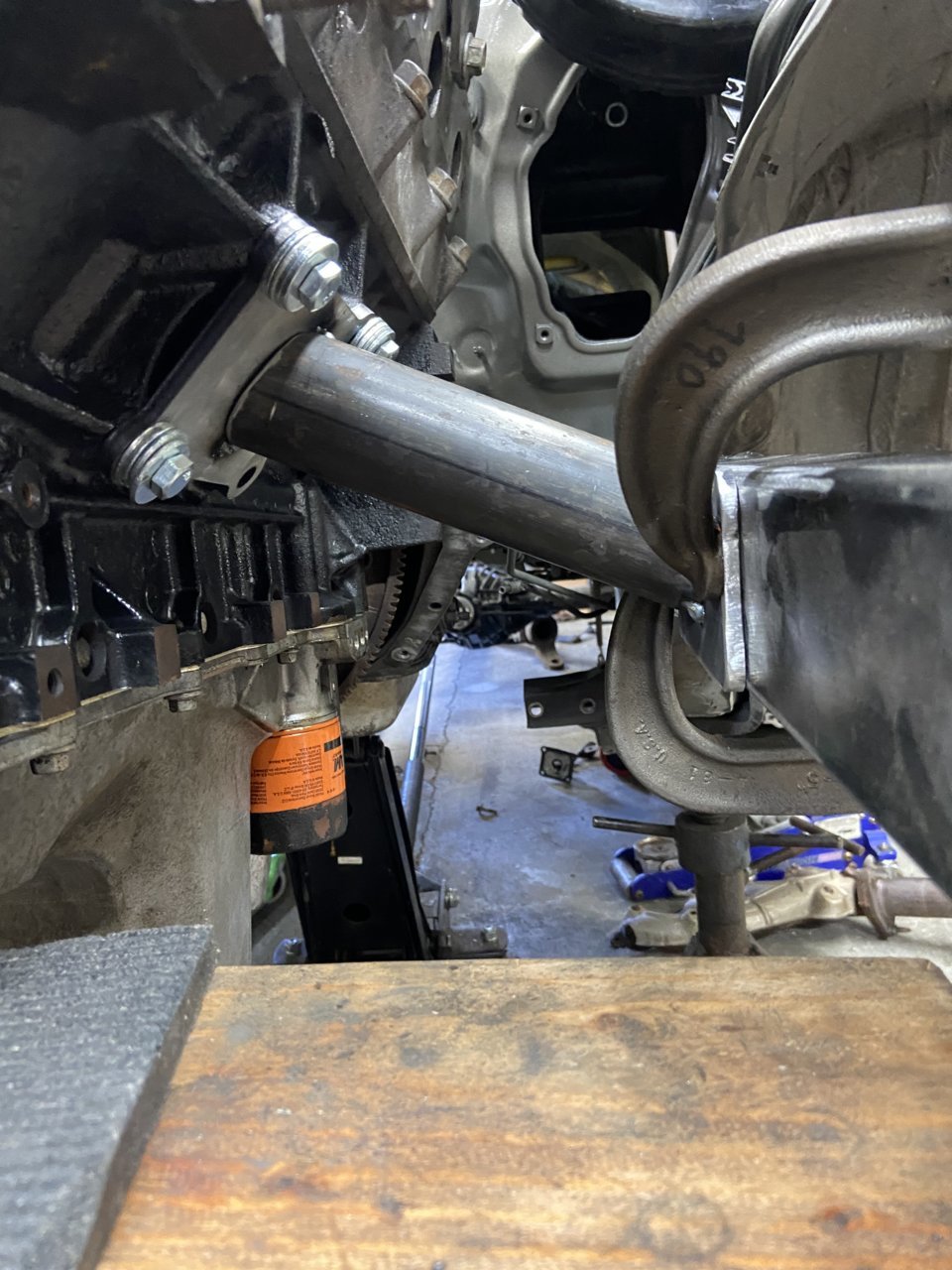

    Wire brushed trans and motor. Did all motor seals and gaskets and put It back in truck. Gonna do mounts tomorrow.
    Did a little mock up and it’s looking like with the current pan I will get 2” of static uptravel on pass side before trac (estimating 26” high on pass side) hits pan starting with the axles being flat and not taking into effect the vehicle moving to the driver side as it raises on pass. Idk if that will turn that into 5 or not. That’s at 23.5 frame height also which gives me some room if need be. New pan will get me another 1”.
    Bottom of crank is currently 30.25” from the ground which will be same height as the new pan.
    58D5AC5A-A1AD-40AA-806C-D7939BD6EBD2.jpg 905D28F0-0970-45AC-9016-6619C5803FC1.jpg
    jubei, T.Barn, skeletron and 2 others like this.

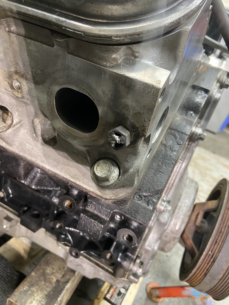

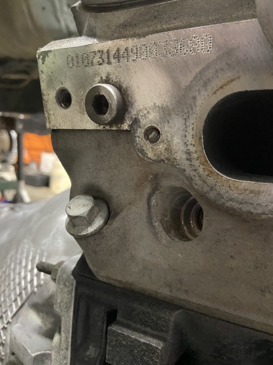

    Broke manifold bolt removal.
    96348CA3-B014-43A4-8442-4C240463B780.jpg 2832ABAD-1BE3-4307-BFE0-C09C630DD604.jpg
    Slashaar likes this.

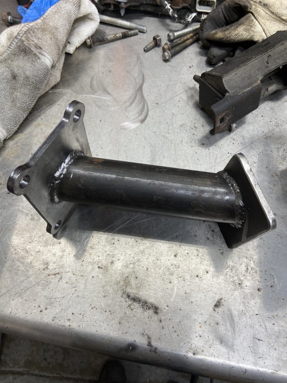

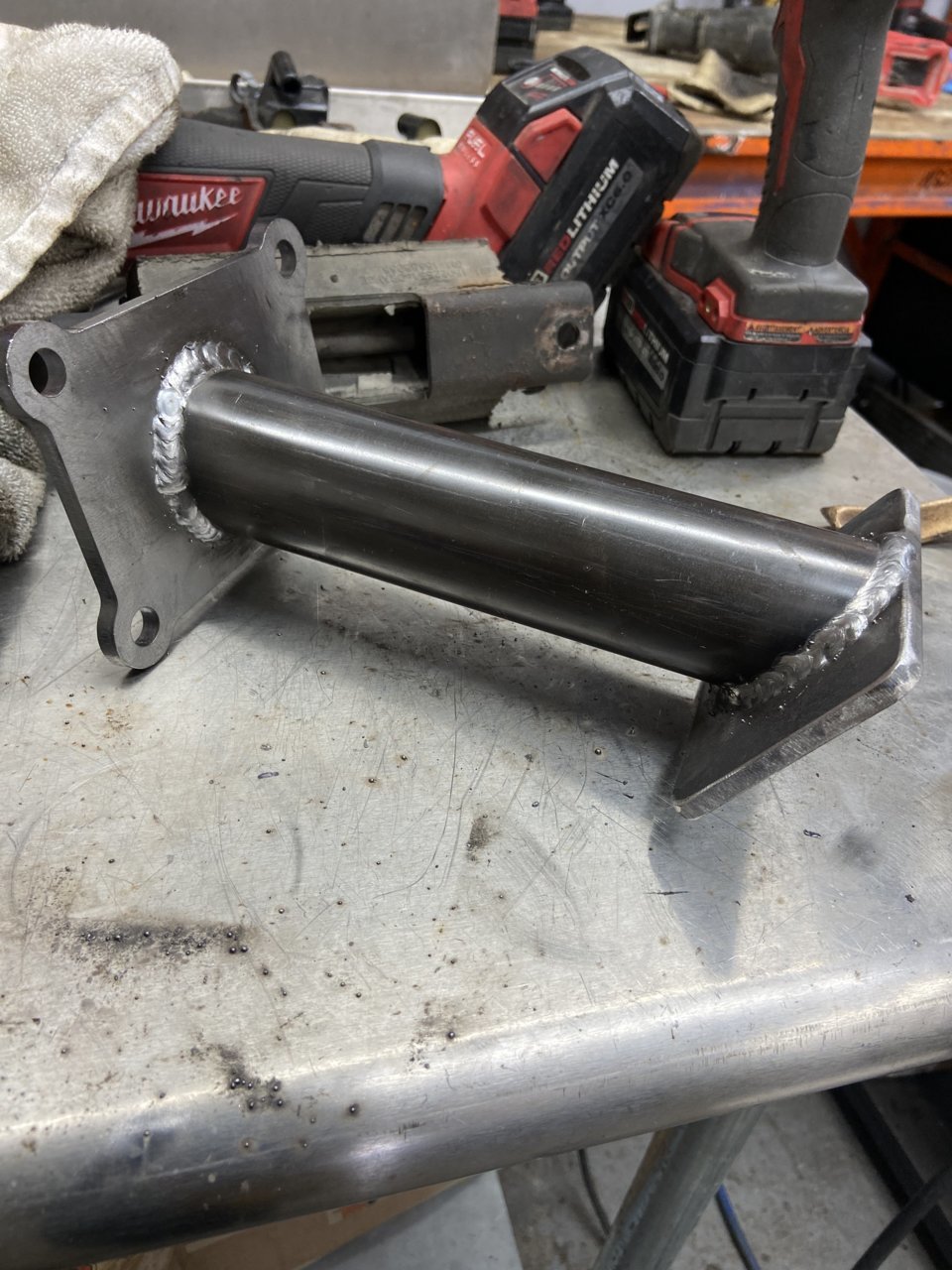

    Got one side done and tacked but was about 1/2” short on dom so on way to get more.
    613A95B1-BADF-47BC-B163-ED5CC09BB415.jpg AF666FC1-EF2A-4BA3-8CED-F84047CF3E0C.jpg
