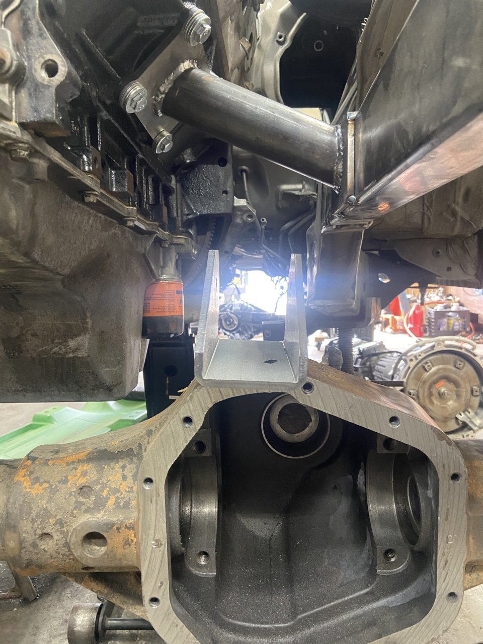

    I agree. What I’m saying is, I may have to go to a dry sump to get the clearance I need to keep axle back so spending 400 on a pan and 600 on a pressure regulator starts to cover half a dry sump setup. My axle is going in tomorrow so I’ll know.

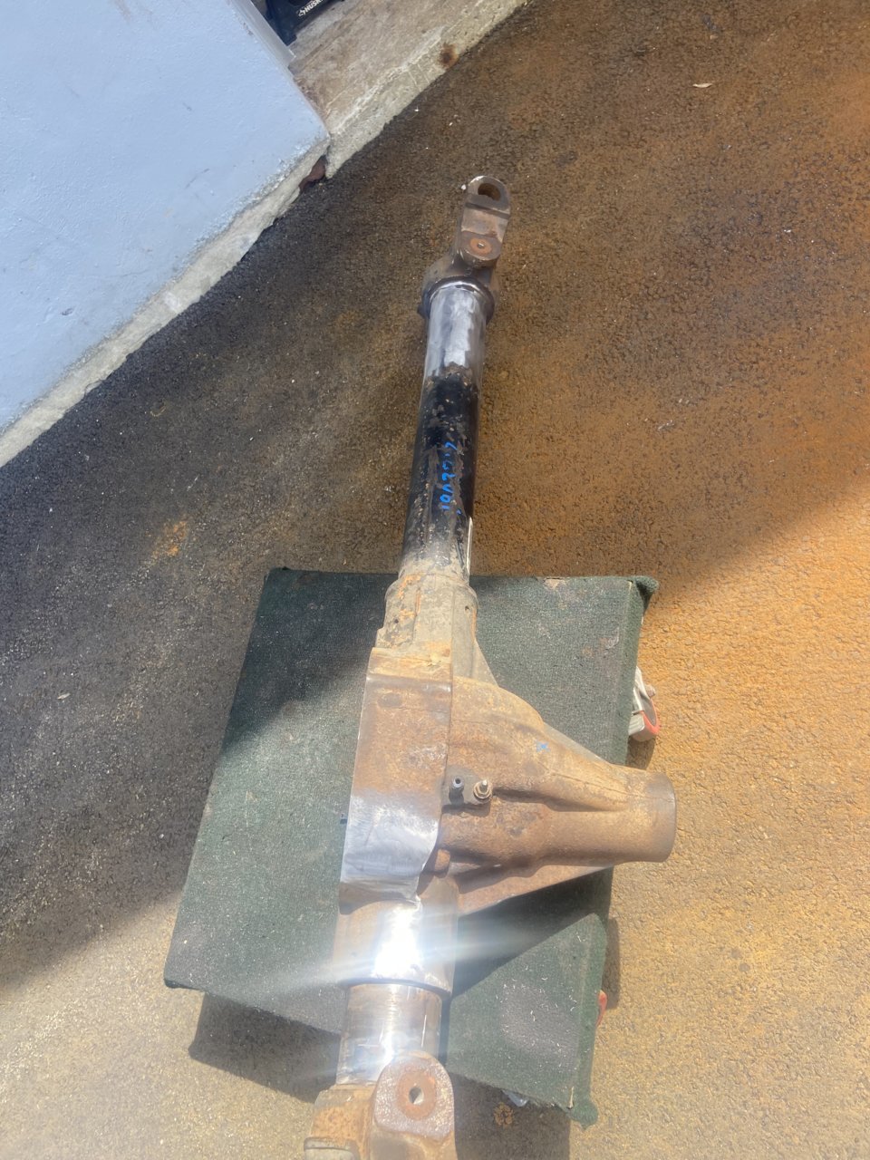

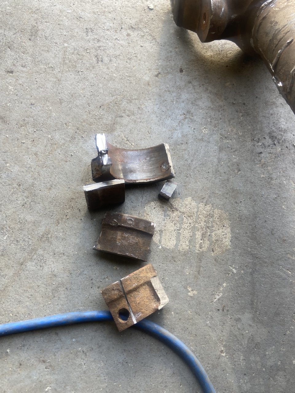

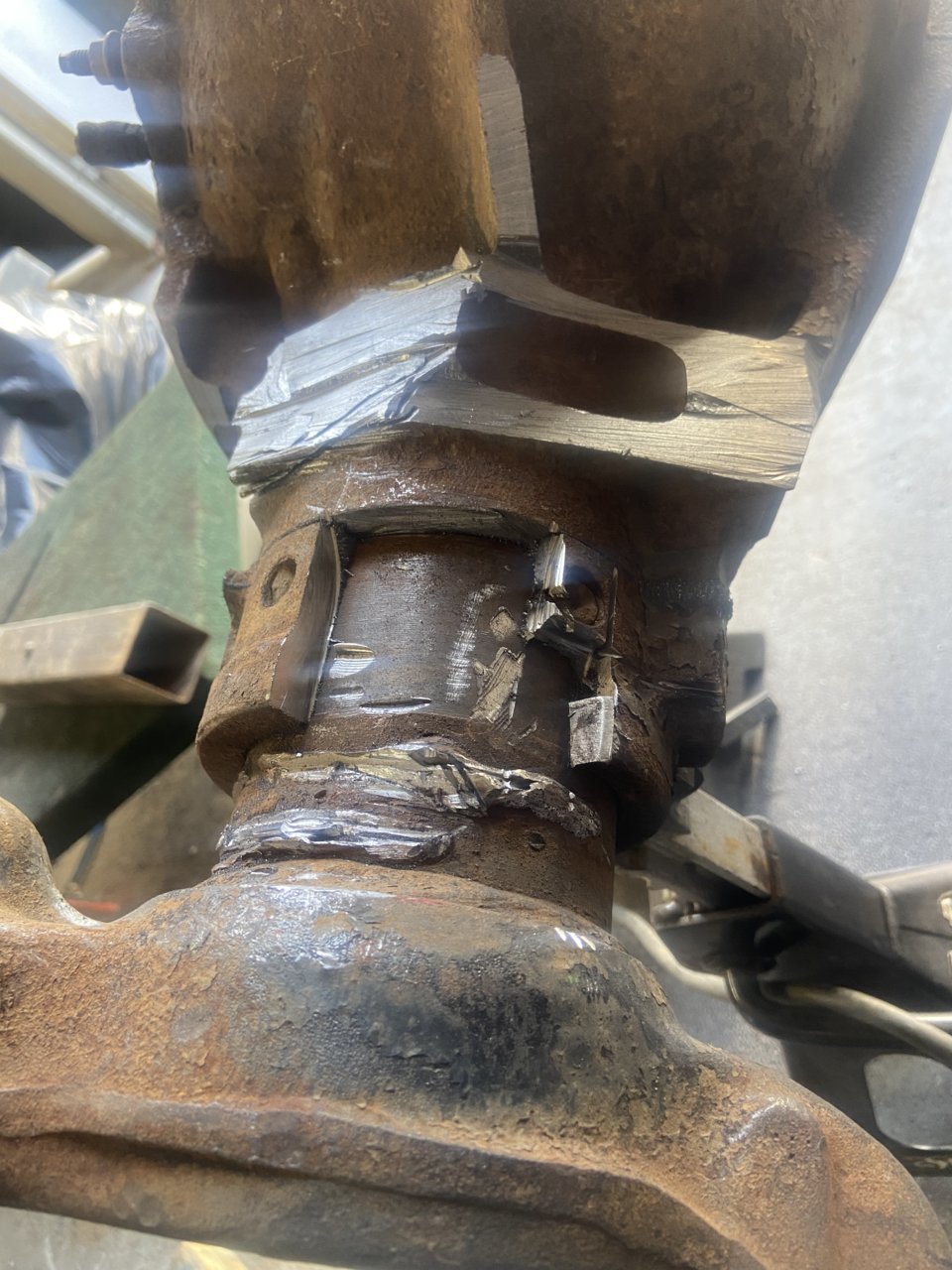

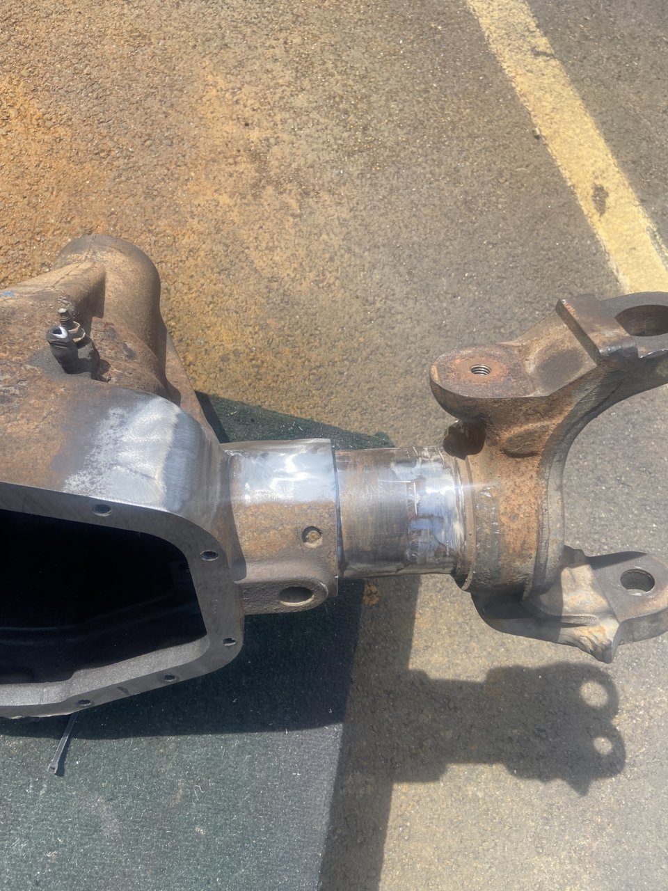

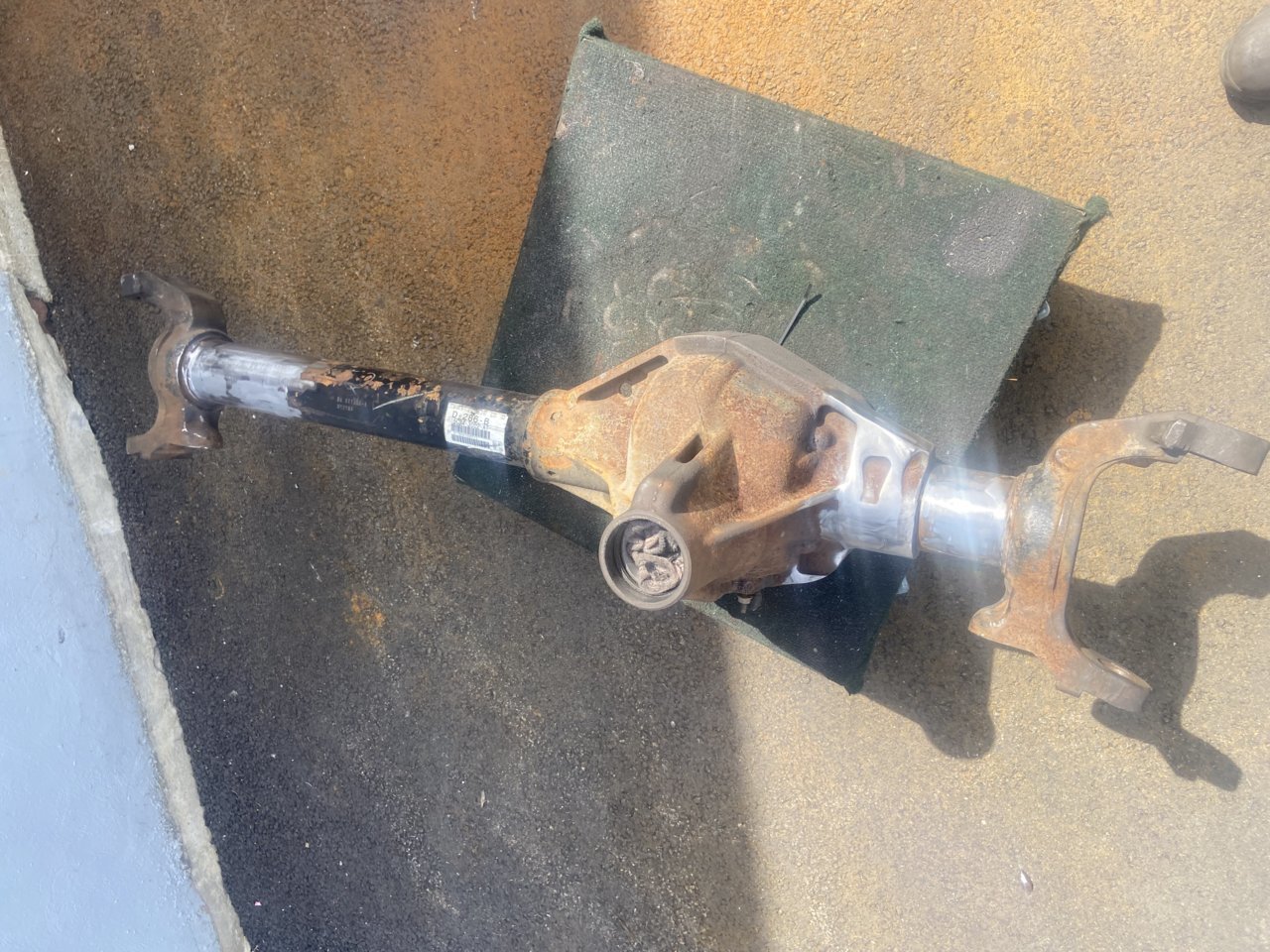

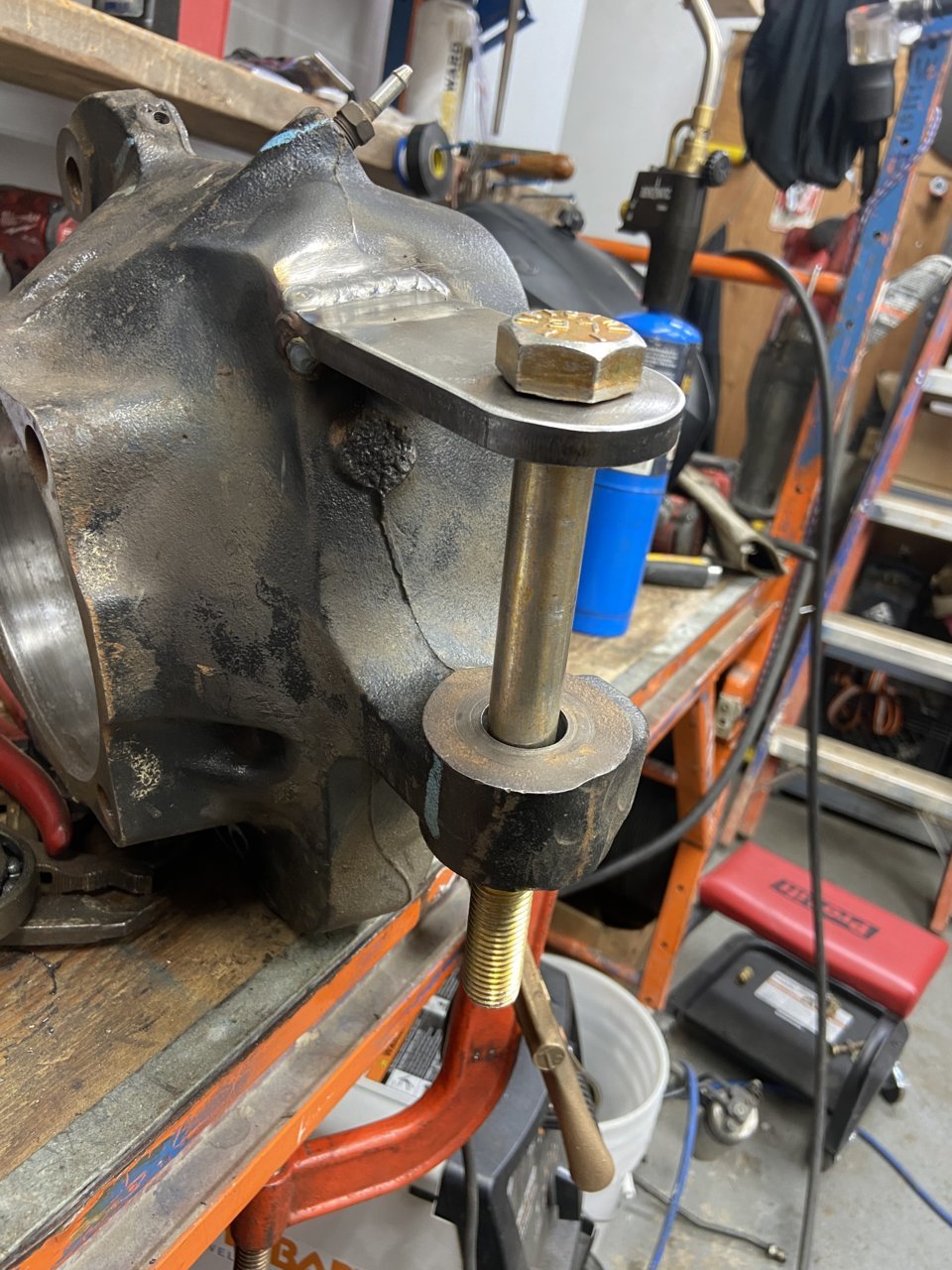

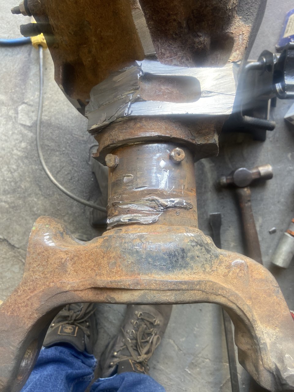

    Finally got a few hours to finish cleaning the SD. Lot of work man! Looks a lot better stripped. When link stuff is on I’ll final grind everything real nice. Plus at least 60lbs comes off with all the bullshit brackets.
    UPDATE- DONT USE THIS AXLE. GET A LEAF SPRING MODEL FROM LATE 90'S INTO 2000'S. WAY LESS WORK AND BASICALLY THE SAME. 35 SPLINE VS 30 SPLINE I THINK. ILL TAKE 5 SPLINES LESS TO ONLY HAVE TO CUT OFF A LEAF SPRING PERCH AND SOME MOUNTS.

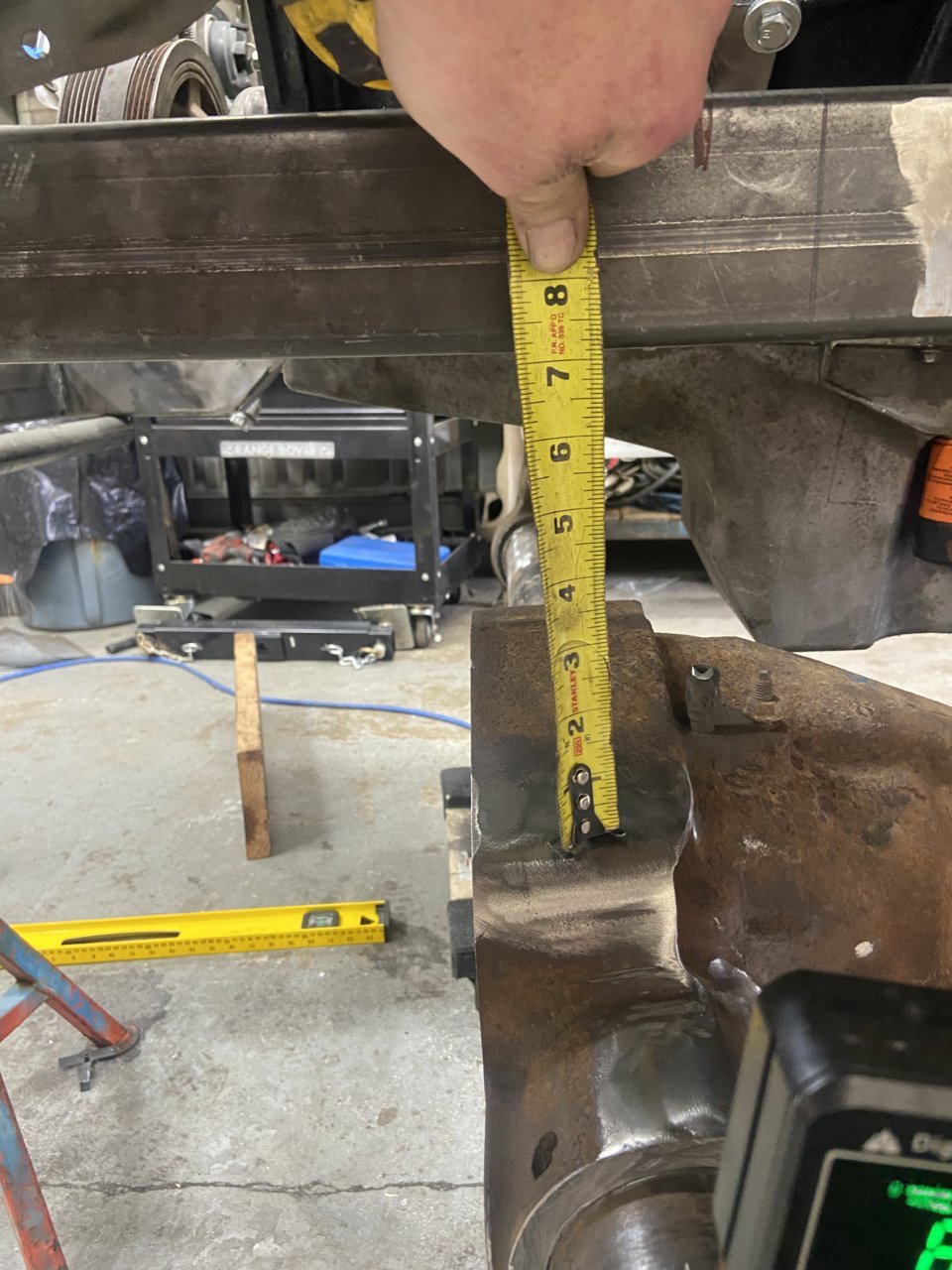

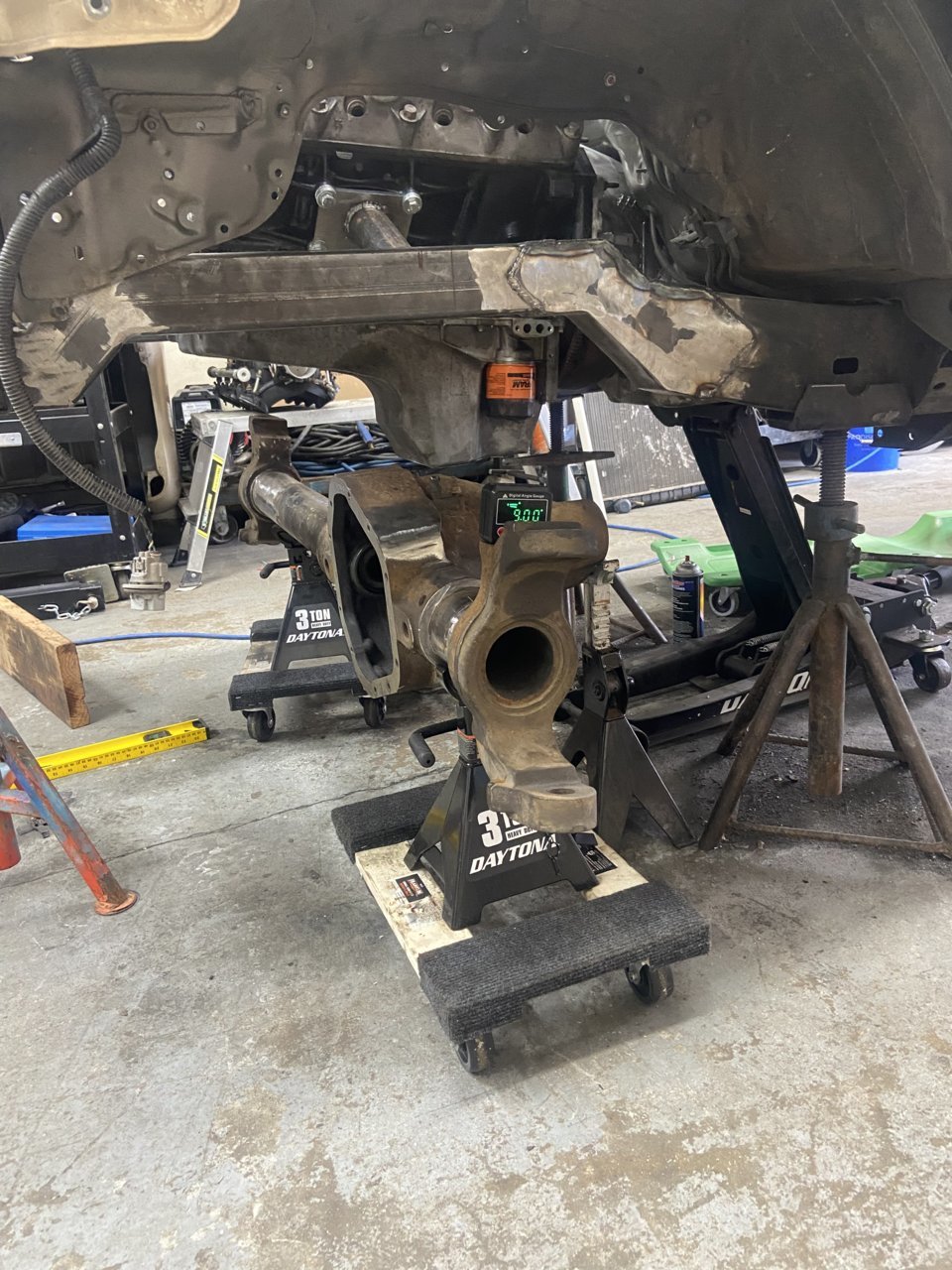

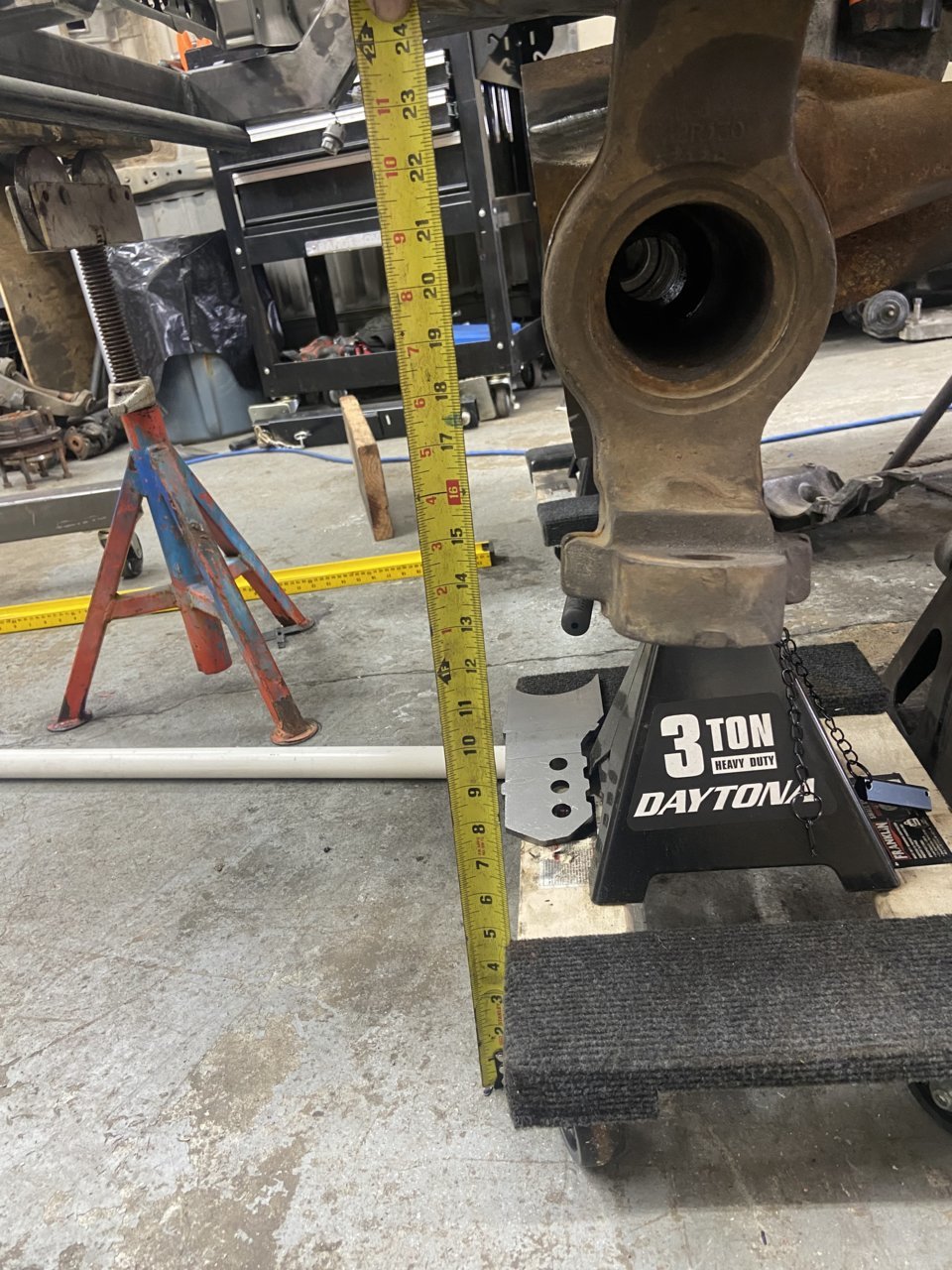

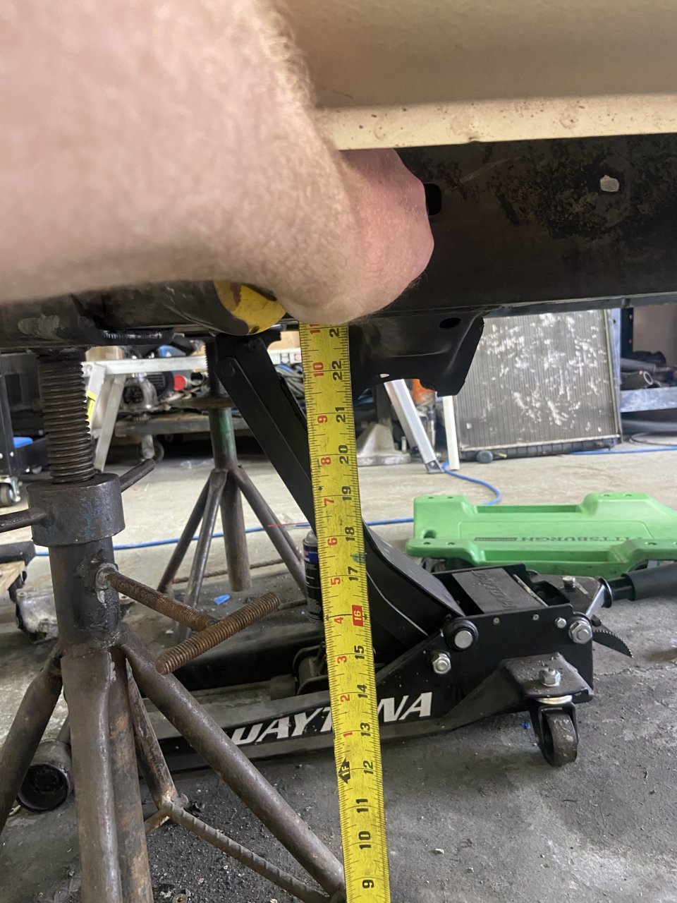

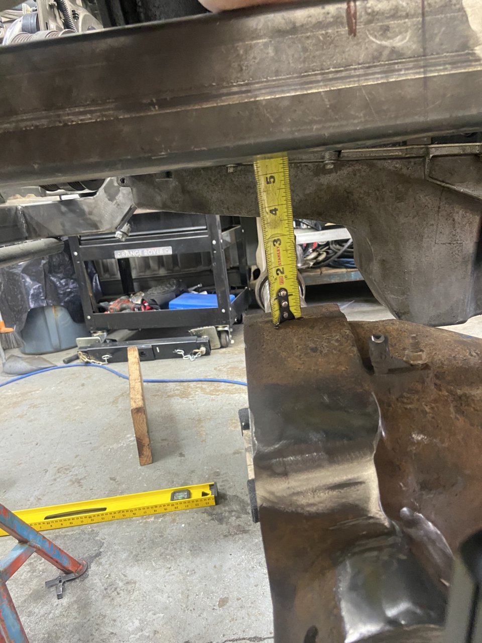

    Man this LS kinda killed the super low/lots of uptravel thing. Gonna stay low w less up. I’m still seeing 4” on driver but not 100% sure yet. Pass is looking a little better.
    currently
    frame is at 23.25
    Axle at 20
    Wheel base 126

    Damn sorry you can't get it as low with the LS pan!

    I am. Plan on getting one that is about 1.5" lower back to the sump. That will give me the room with the trac but the steering is gonna be prob 2" above that so its gonna hit the crank pulley or front of pan. Its all good. I have a few options. Its day 1 of front work so just getting a feel for the problems ahead.

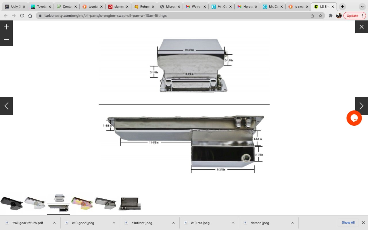

    The stock pan is big AF. Its 3" deep at the axle and goes to 2 5/8 I believe. The one im considering for a wet sump is this. Way lower.

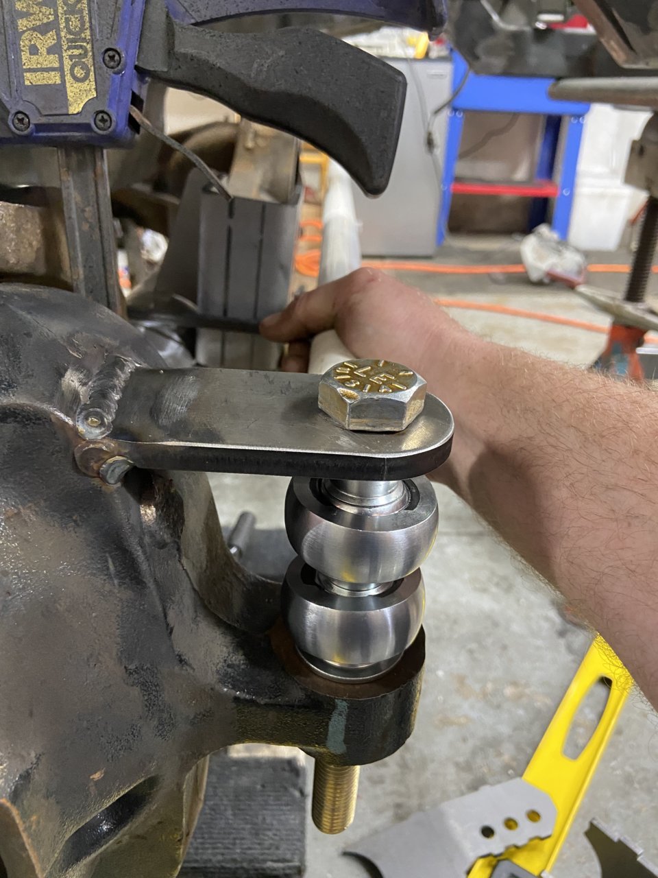

    Steering coming along. Prob change later when I can get a high steer but it will work for now.

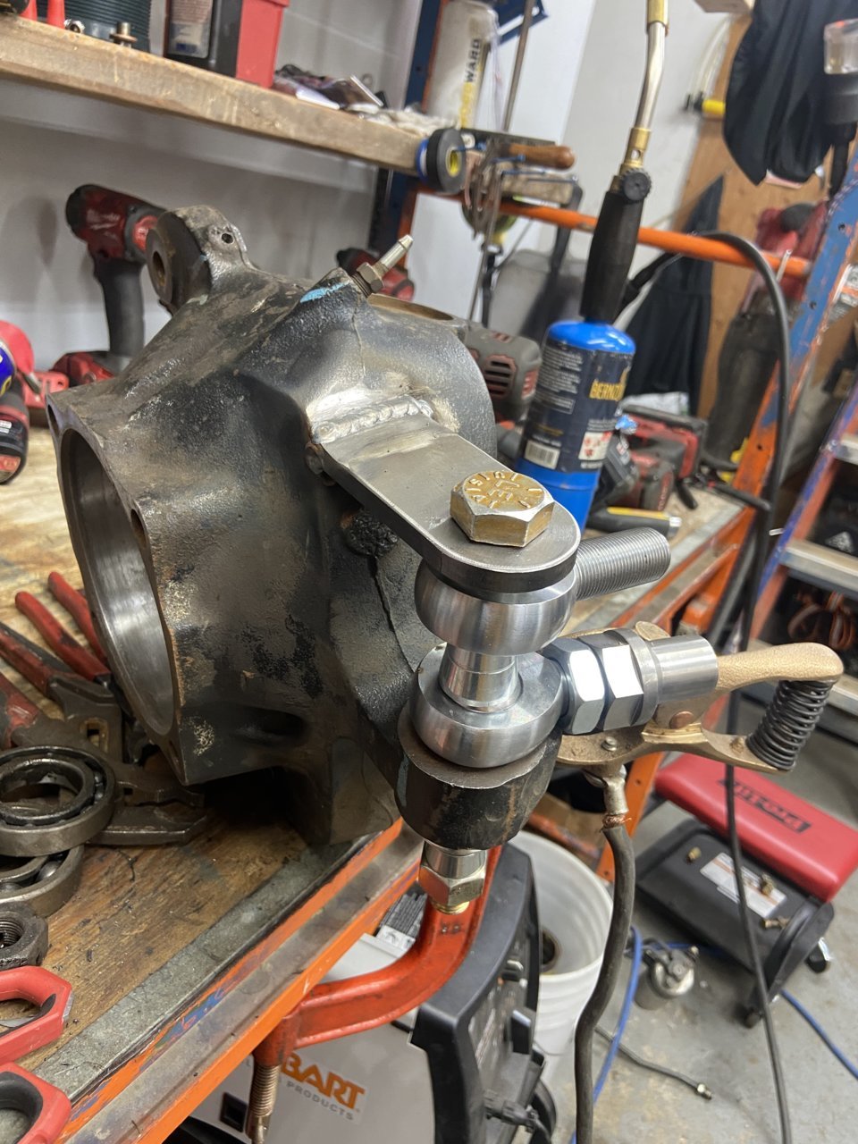

    Steering bracket won’t work. Too close to trac mount. Gotta bring everything out like 2”. I really liked the look of it too. Sucks.
